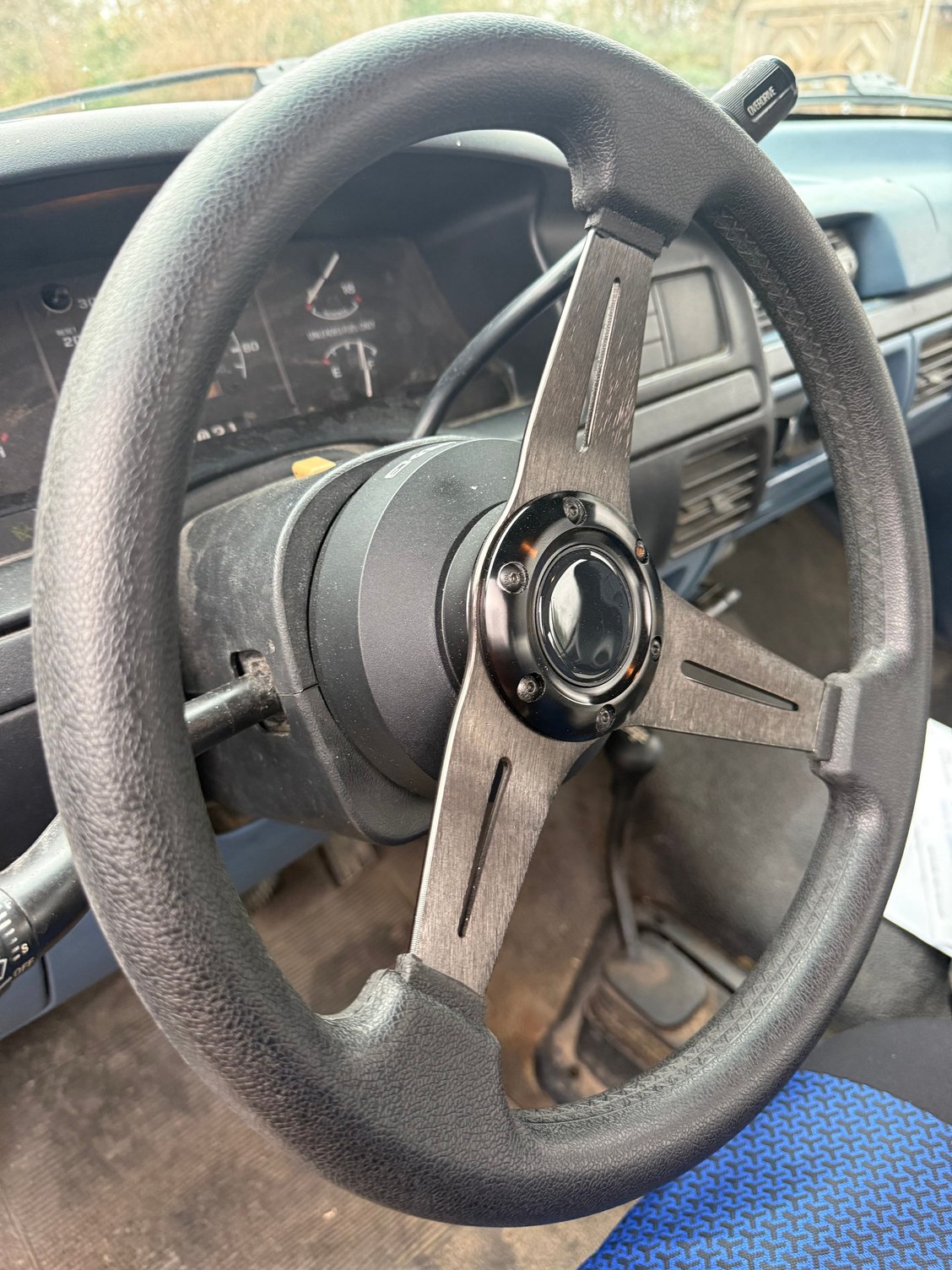

PO replaced the factory steering wheel with a custom setup….when I got it there was a lot of beeping going on and of course the light on the dash was blinking…I plan on installing a factory wheel with airbag….beeping was driving me crazy so pulled the airbag fuse (#5 in the fuse box)….light still flashes but no beeping…haven’t noticed anything else so assuming it won’t hurt to run it that way until I get another wheel?

News to me that there is an airbag beeper. It won't hurt anything to run that way.

If the light is burnt out the module will beep. I’m surprised that it is beeping with the air bag light functioning.

Look up an air bag simulator for your truck and get one
I have several we used to use for testing that they bought us
Plug in one of those in and your trouble with the beeping and the air bag light will be solved
* I'd rather see you have the airbag in working order
