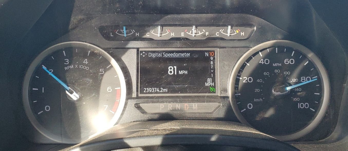

Originally Posted by scraprat
Hold the faith. They're not all bad.
what size tires?

Originally Posted by 26 Peasant Ranch
what size tires?
Stock
275/ 70r18
