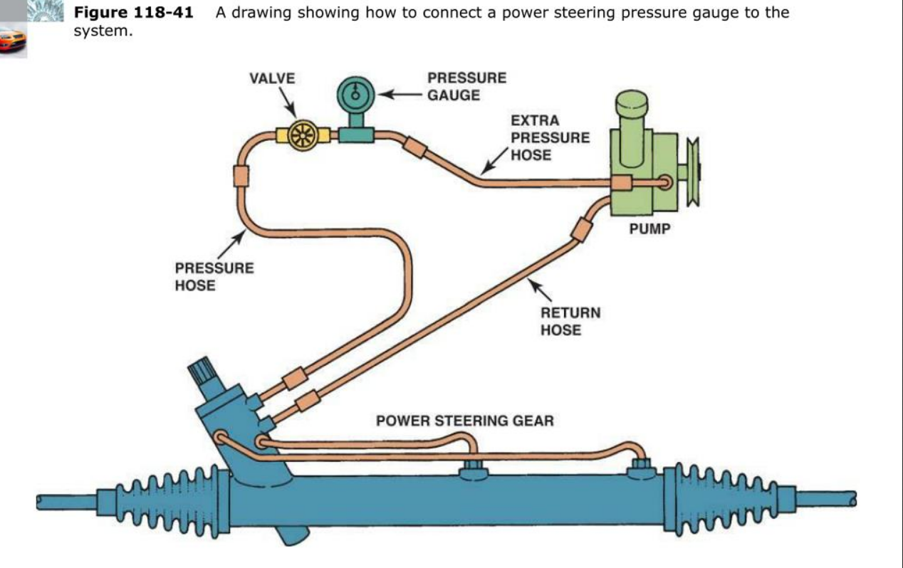

Without this tool, you are only chasing your tale and throwing money -
There should be a TOOL RENTAL in your are where you can rent one,
