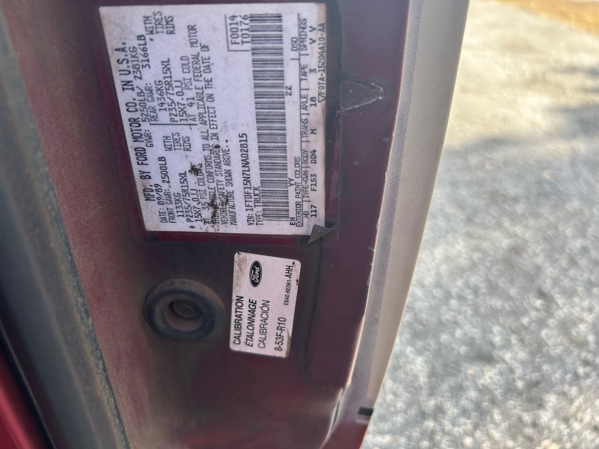

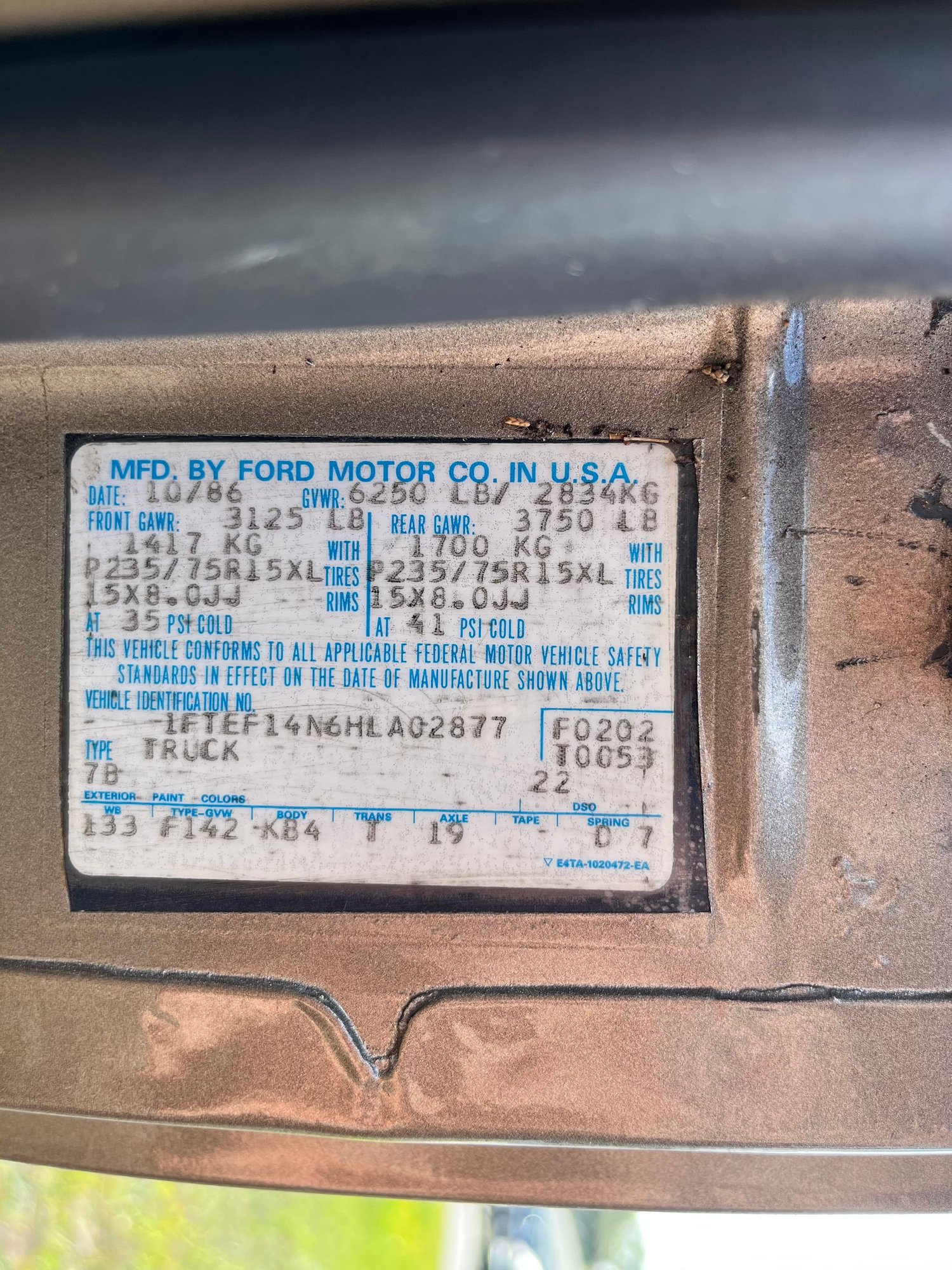

Any chain part store will be able to get it. I ordered mine online from flagship1. Get your calibration code off your door jamb sticker.
No one will have it in stock for you to just go get, fyi!
sorry I’m trying to make sure I have everything correct, which numbers would be the calibration code? I really do appreciate everyone’s help!

I’m guessing you don’t have this right underneath that one? Take pics of the labels on the ecm.
None of that. See post #14
