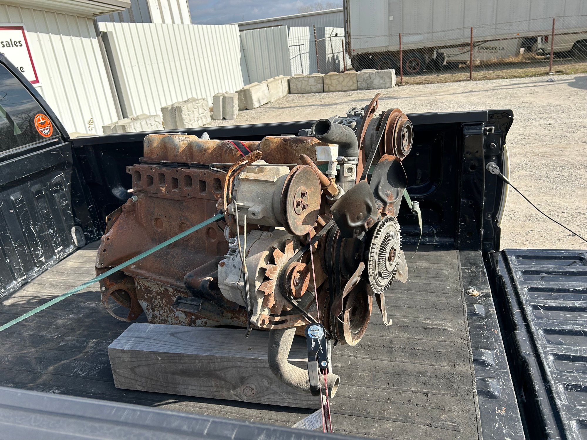

Picked up a little Xmas gift for my 10 year old. He begged me for months to build an engine; so now we have a little 300.

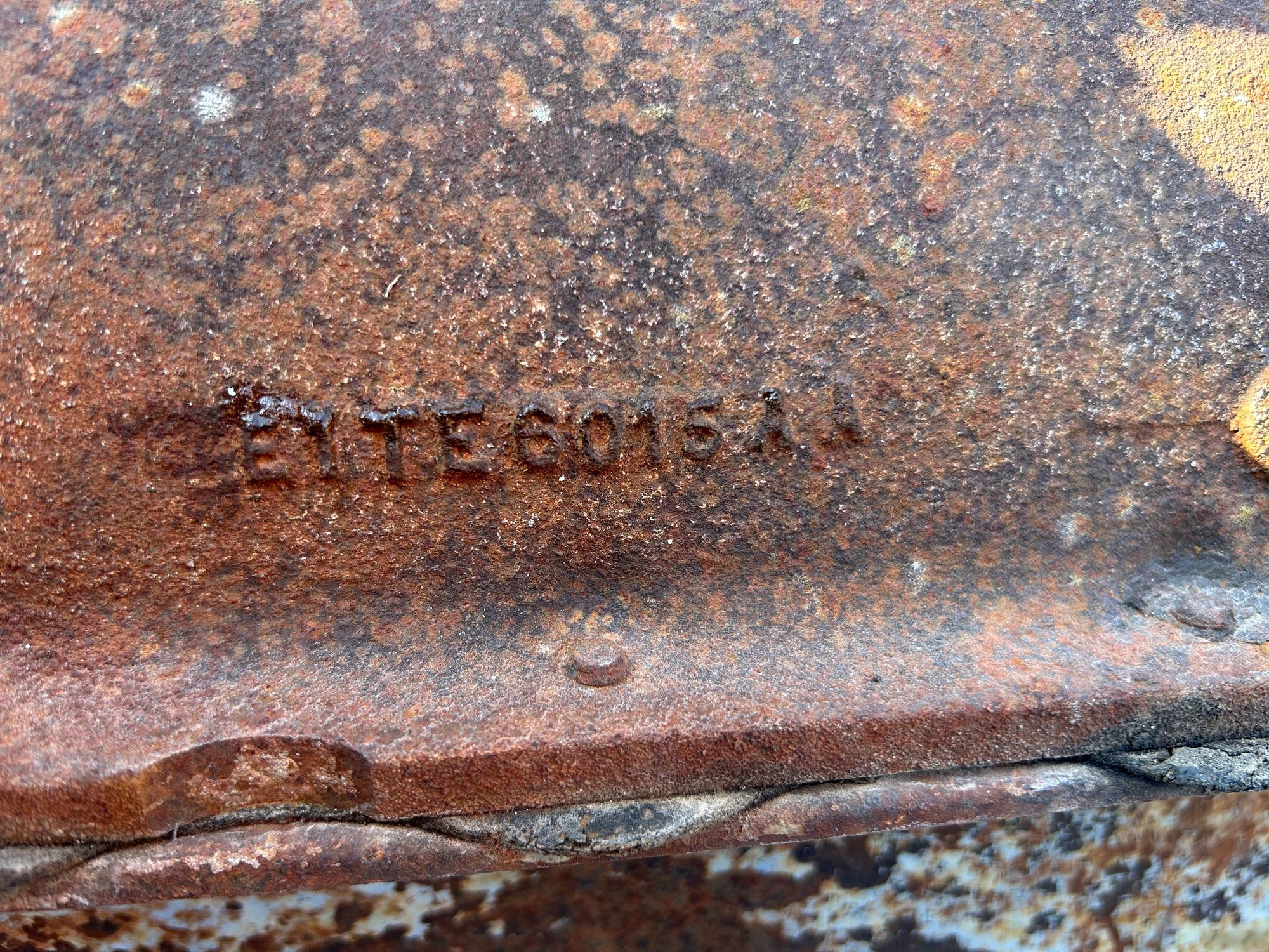

im trying to make sure if the year, but can’t tell if it’s an 81 or 87. Salvage yard said it was carbed, but the eec4 style distributor suggests otherwise.
Im thinking it shouldn’t make much of a difference once I find an intake and manifolds.

Is this going in the 80 that has the 302 in it now?
If so you will need to get the frame mounts for the 300 as the 302 ones will not work.
As for the motor it really does not matter what year till you get to the 87> as they were EFI and the blocks did not have the hole for the fuel pump but here the bolt holes were there and threaded?

When I seen the rust on the head around the ports I was thinking this motor sat outside for a bit and hope it's not hurt.
I guess you answered that question sorry to hear that
If the motor has not been rebuilt before and the rust not too bad in the piston areas it can be board out.

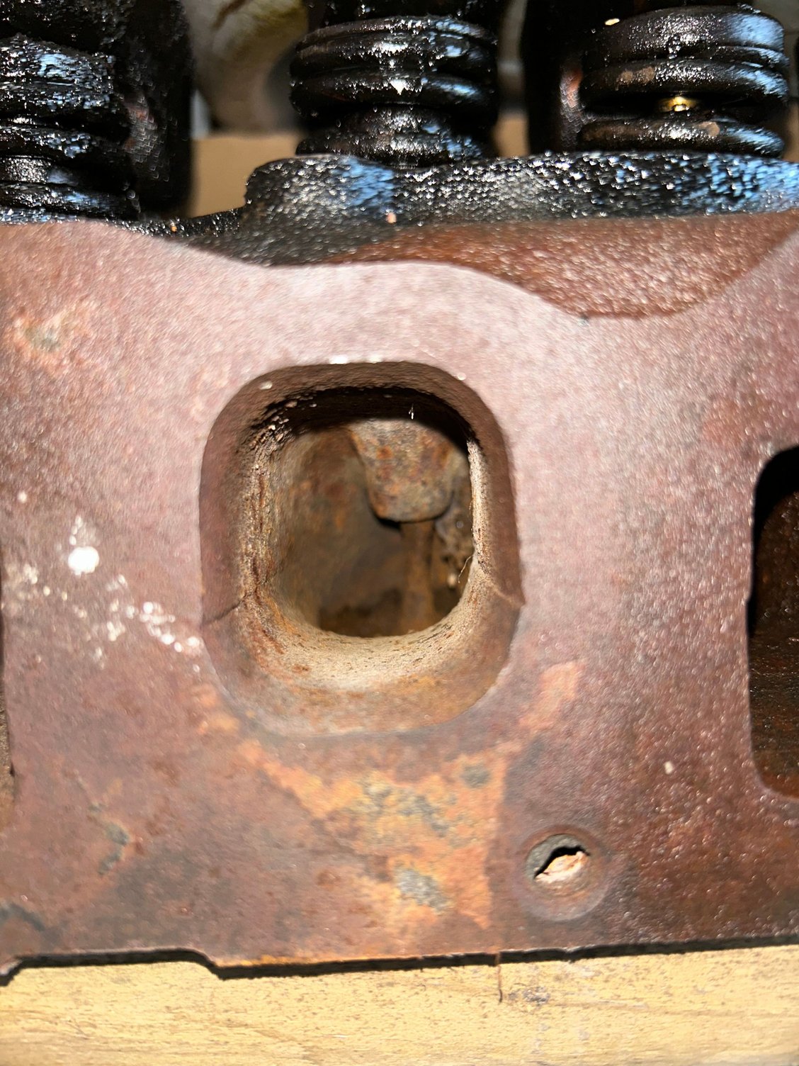

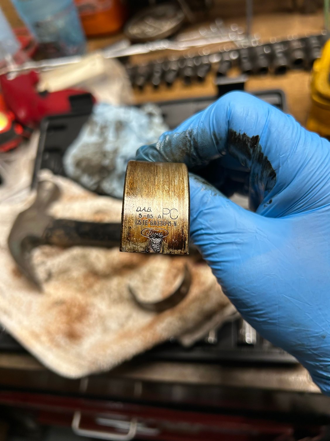

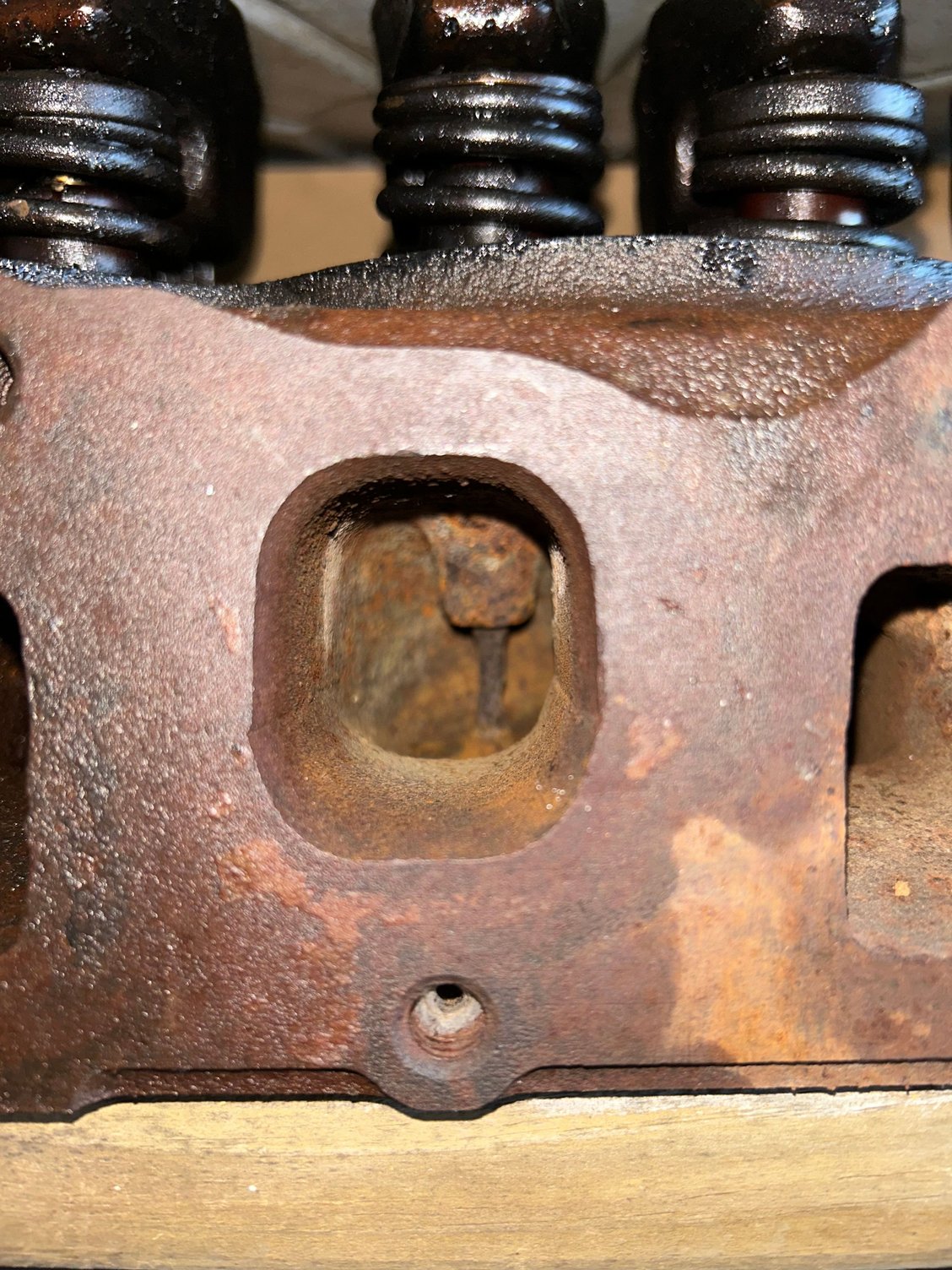

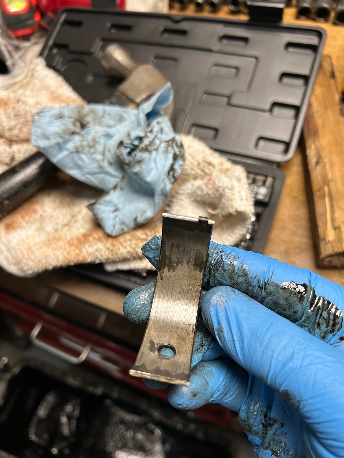

we got the head off and bottom end opened up yesterday. The pan had the remnants of the sludgy, watery oil in it, but not much: maybe 2 quarts
So we got that out there and checked out the crank, bearings and cam. So far, really not bad. This engine obviously had some mileage on it but was kept in good oil while it was running. The head on the other hand … well check the photos

The bearing pictures is that mains or rods too?
I am not up on Ford part numbers but at least they are Ford bearings and I dont think under size.
What does the crank look like?
That head looks like it may need valves, do they move in the guides?
A shop should be able to get that cleaned up for you as part of the needed work.

Surprisingly yes! The valves are not seized and will move when tapped with a rubber mallet, but with 75% of the stem being rusted away it’ll definitely need new valves and probably seats.

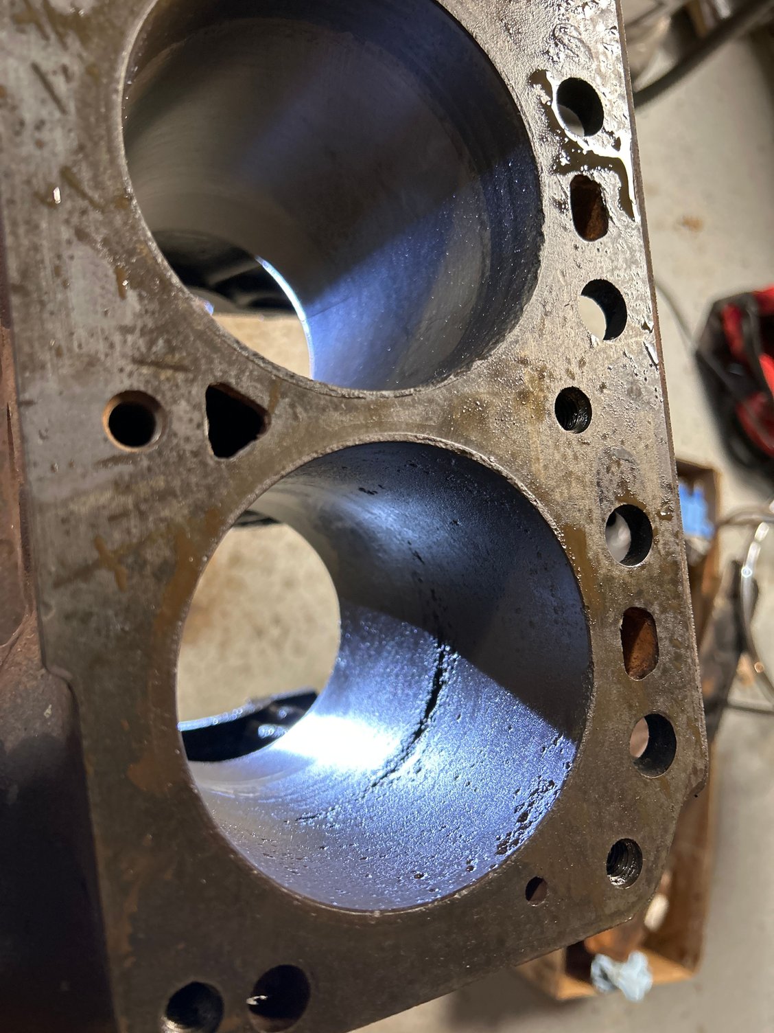

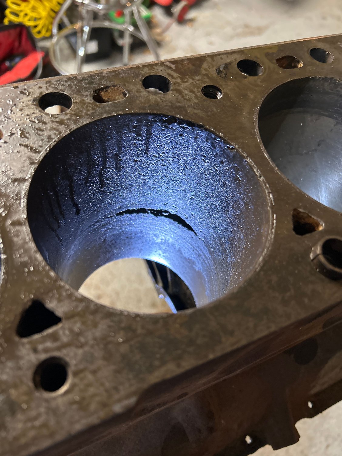

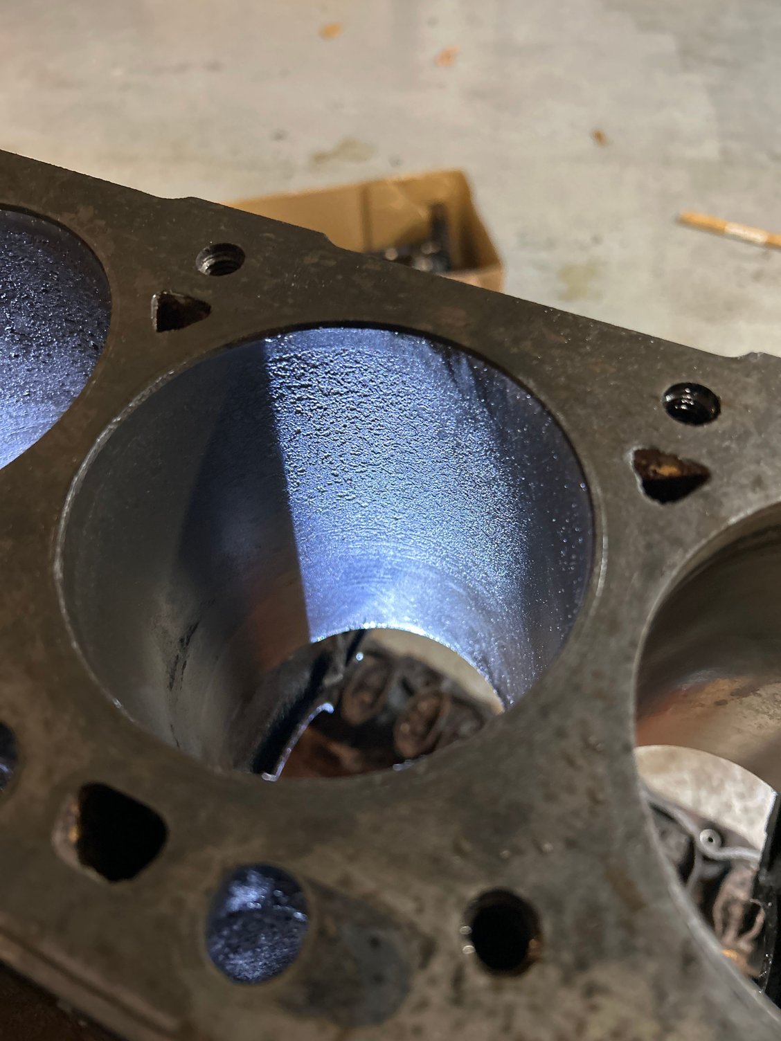

update. 50/50 on cylinders

WOW is all I can say
I hope you did not pay a lot for that motor as the block looks to be trashed.
Even if it will clean up at 60 thou and that is a MAYBE, you have to worry about block shift and the walls getting too thin and a lot of time going 60 over the motor tend to run hot.
Maybe it could be sleeved, but I hear that can run a few bucks that could be used on a different motor.
That is why I sad maybe look for a complete truck and if it has a 300 in it you it for the rebuild.

Well I think you spoke it into existence… we found a crack in the cylinder wall at the machine shop. So that block is officially a boat anchor. While we were there we did find a D series head that had been rebuilt 20 years ago but never installed. New valves, seats, springs, and deck. We snagged it for $300, so the head work is DONE. I’ve got eyes on an 84 truck with a 300 & an EFI 300 out of an 89. Either could lend themselves to the build and give us plenty of parts for use or resale.

Sorry to hear about the block but good to find it now then later after some work was done to it.
I would say $300 for a ready to go head, take it you will need to use the rockers off the old head?
If they dont work out and need to be replaced you may want to look into the Chevy rockers that will add a little more lift.
I have read that they are a bolt on so might spend money on something that will help a little on power.

Comp and crane both make stamped rollers with a higher ratio that are enticing. There’s another company called Yella something that makes an aluminum roller; but they’re awful spendy.
If that truck / motor have EFI exhaust manifolds keep them as they help on power too.
Dave ----
