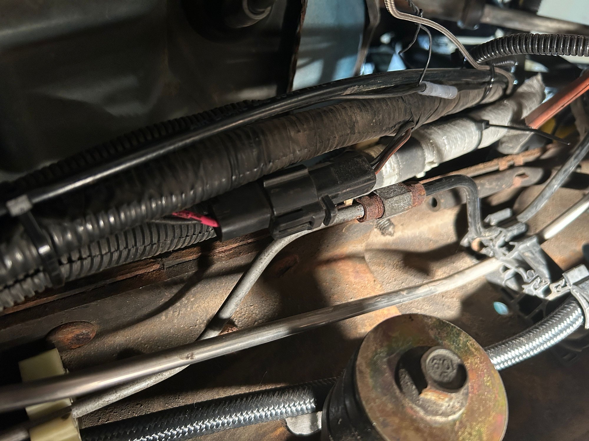

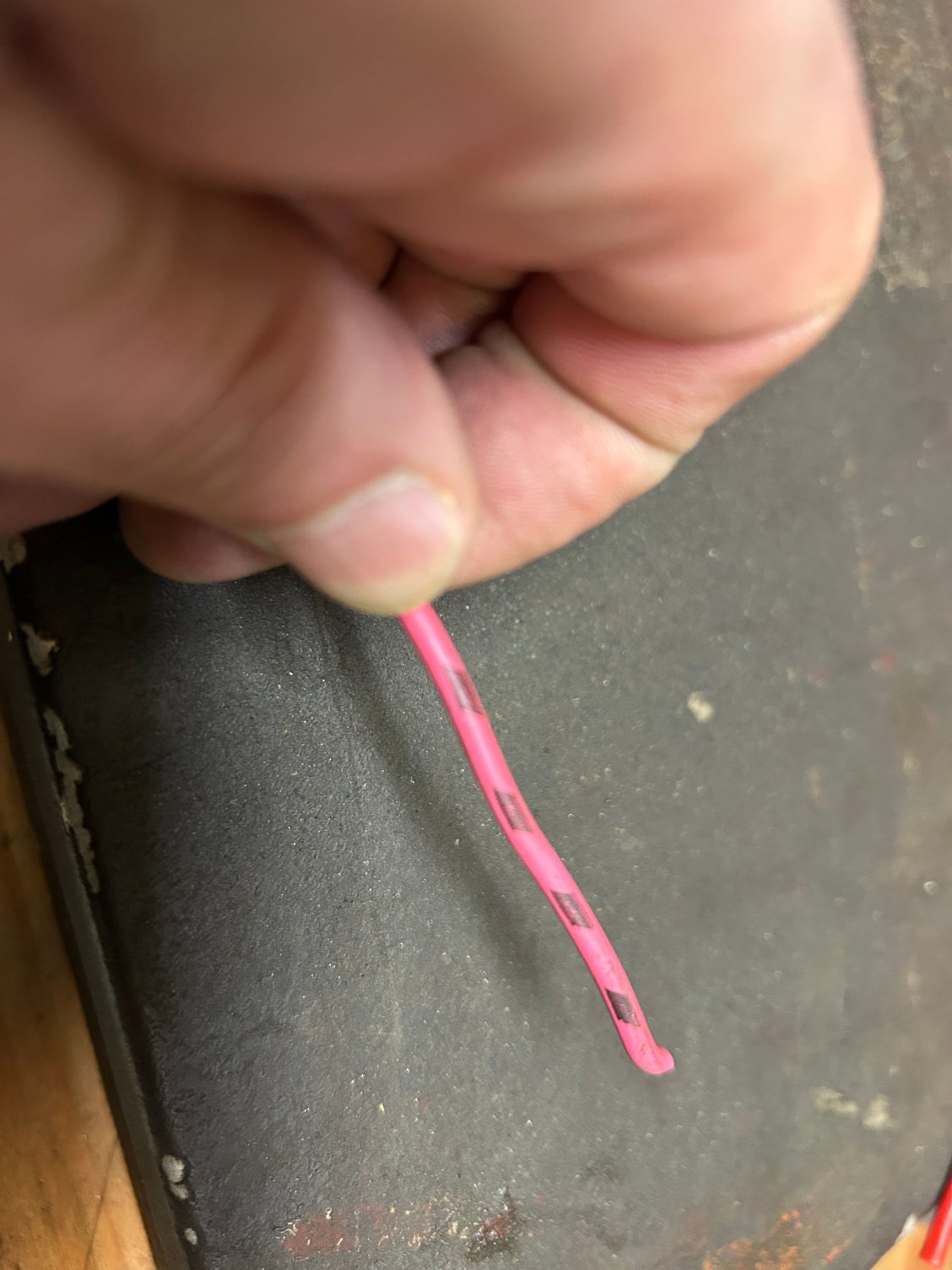

This is the location of the factory plug for the fuel pump circuit. It’s a red with dashed black line.
Drivers side just above the sway bar link.
Curious if your aftermarket fuel system pump is fed off this circuit. 20 psi at koeo to 95 psi when cranking is peculiar.

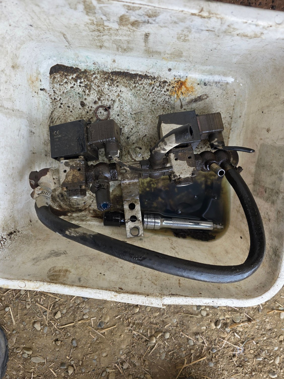

IT'S ALIVE.
It is something with the manifold. This whole system is coming out.
55psi of pressure pre filter with key off engine off and with engine on.
I just bypassed the manifold on the supply, and somehow, its pissing fuel out from the supply hole which is reutrn fuel probably. Only the return is still connected. Maybe there are internal leaks, and its trying to suck fuel from the return line? I wonder how long its been like that.
Im going to patch it up ans rip and tear at home. I have some fuel line ordered, and i want my garage. Truck is going home tonight.
Bypassing the supply.
That nipple is the supply to the pump. Fuel is pouring out of this, but i dont think it should. The tank is hooked right to the fuel pump.

Errr
I think this system is plumbed wrong. I dont see a return to the after market tank. I think it may need to come out at the farm. There is what seems should be a reutrn on the tank, but its plugged. I dont think this thing ever had a return on the aftermarket tank. It looks like when the purge was hit, the reutrn would go into the supply, which makes no sense.
Regardless, im not sure i can drive this home right now.

The infamous manifold.
So that line that crosses over i think should goto the return on the aftermarket tank. Im not 100% on that. I know there is a purge that would switch the returns so any alternative fuel would return to the rright tank while feeding diesel. I dont think that is what this did.
It will no longer cause issues though....i know that!

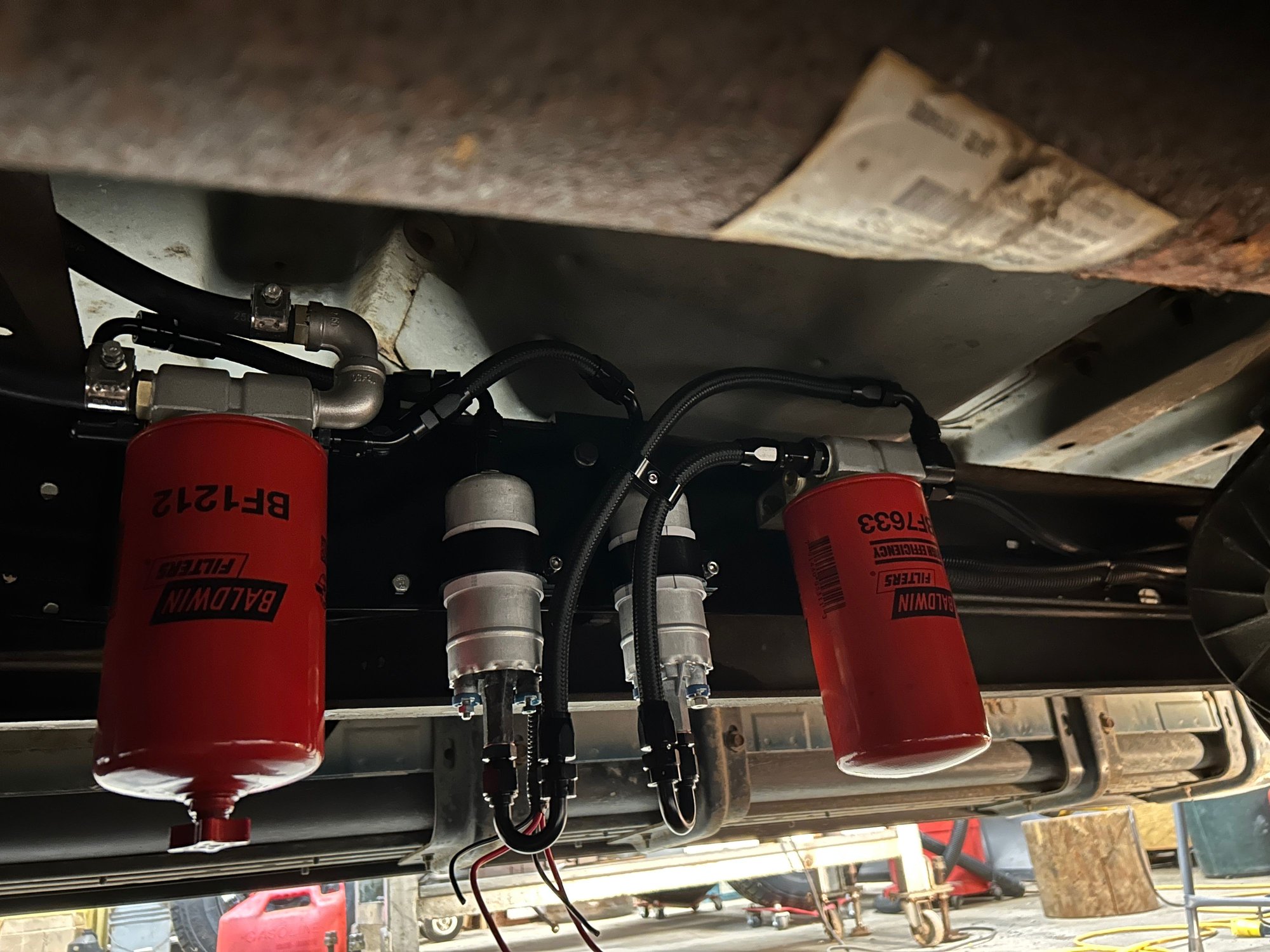

Here’s my latest project just completed yesterday.
