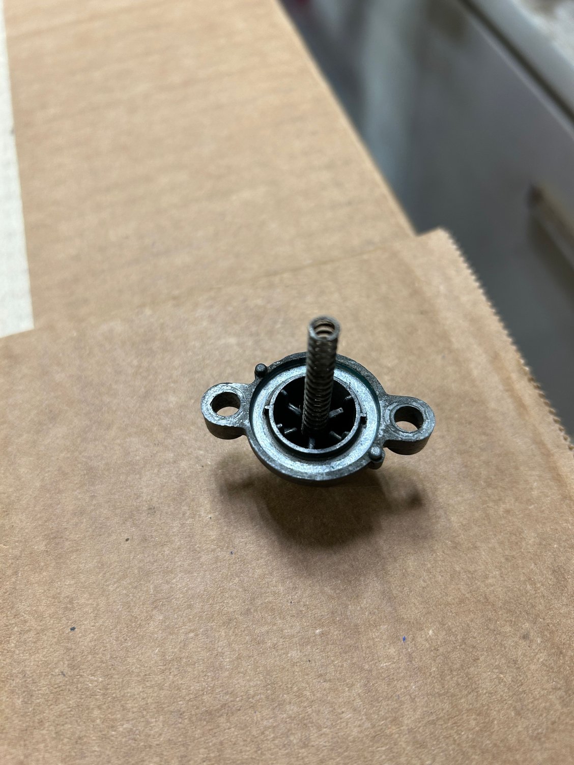

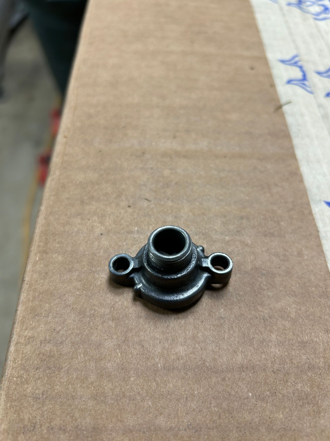

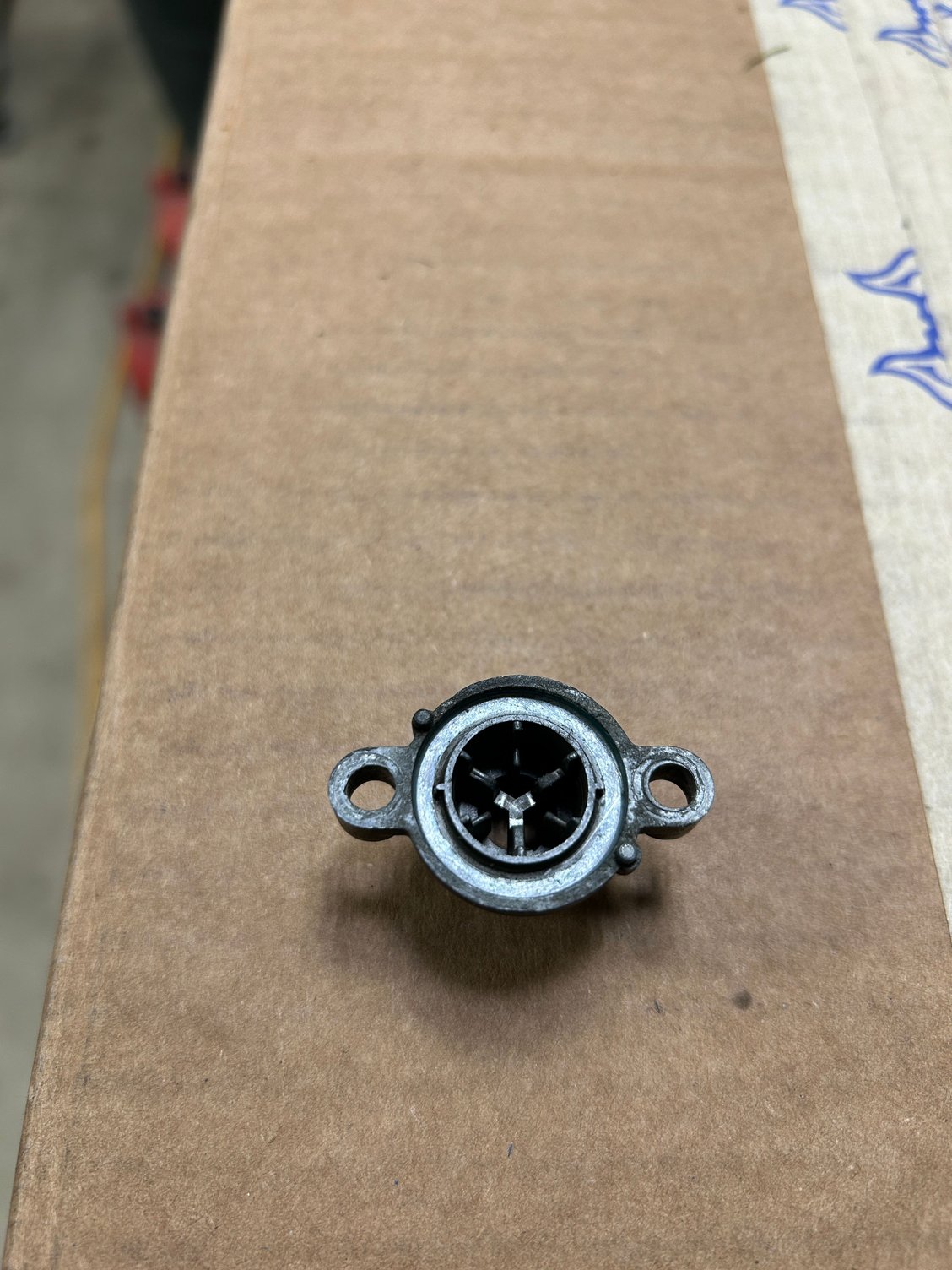

Some pics.
The manifold.
I think may have found a problem. I took the fuel bowl out to replace the drain valve, and popped open the fpr. There is no spring? Where did the
spring go? This doesnt look right.
Ill order a new fpr.
Old Dec 30, 2025 | 03:33 PM
Hellraiser456's Avatar
Hellraiser456
Joined: May 2022
Posts: 212
Likes: 44
So that little fpr housing has no screen to hold the spring. I dont see a spring in the bowl. Must have broke while cleaning.

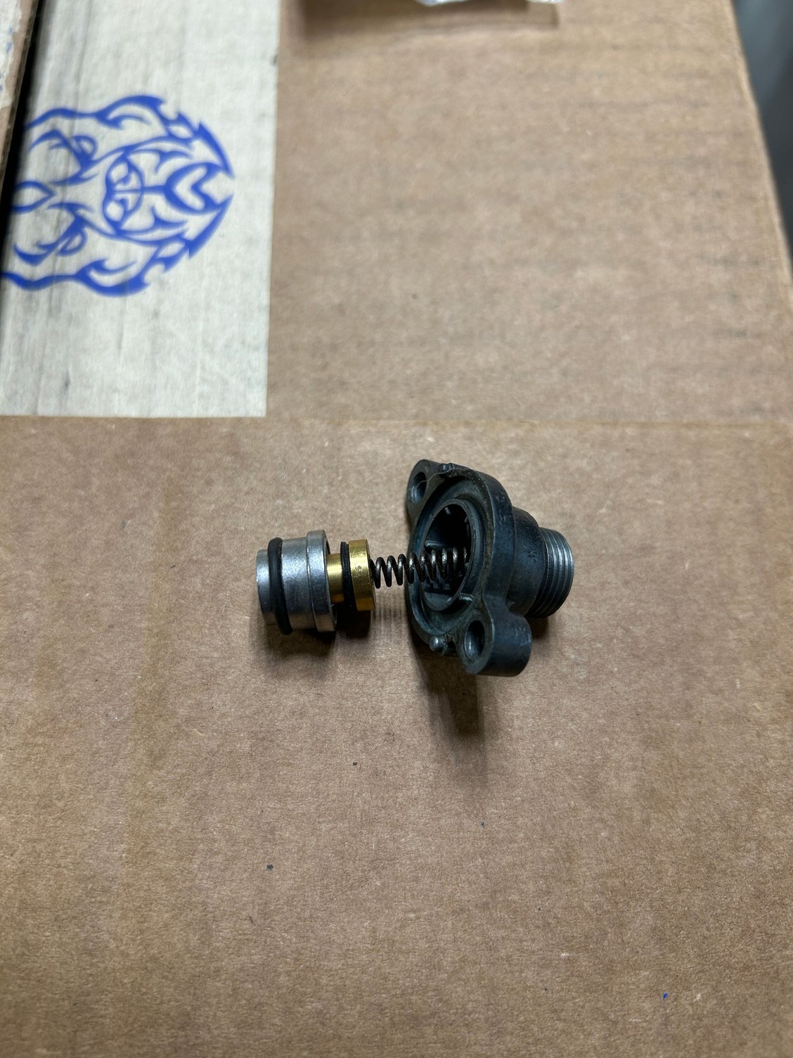

I’ve been waiting for an update.
FPR Housing.
FPR Housing.
Inside of FPR Housing
Spring nestles into FPR housing
Assembly in order.
Assembly in order.
I noticed your country is listed as CA. Assuming Canada and since at 1:30 my time yesterday you said close to dark your central to eastern.
I have a spring I can pop into an envelope and have it headed your way today. PM me if you haven’t already ordered it.
For sure, No Spring, No pressure.

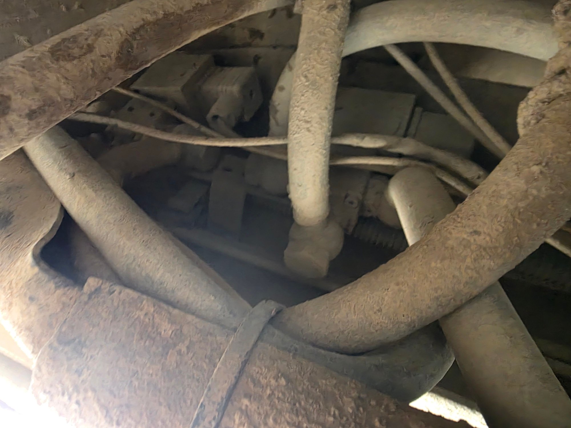

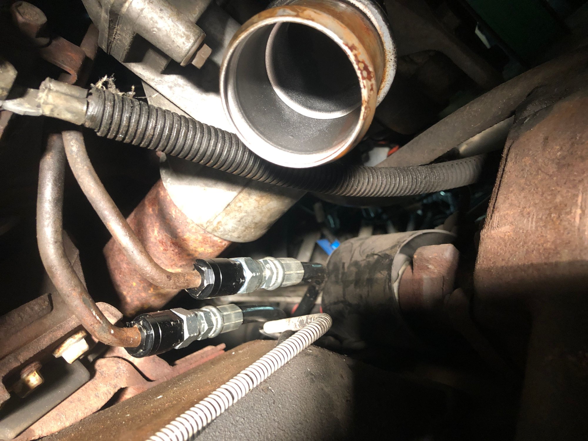

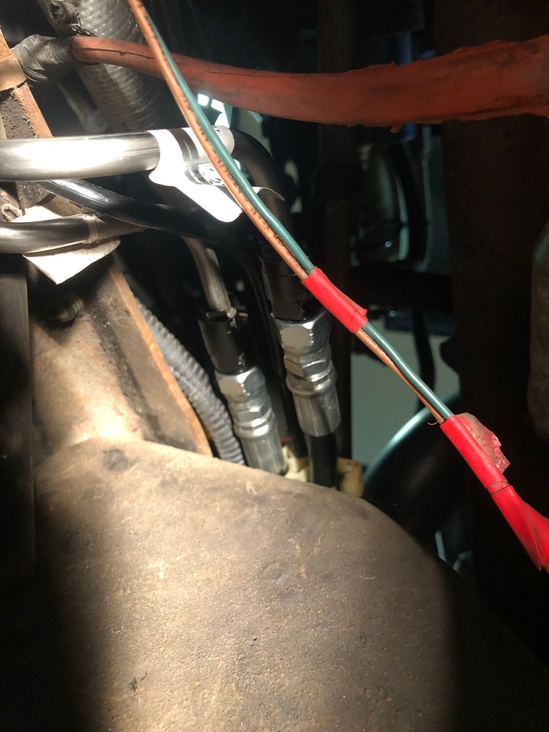

Issue is it would never make it to the tank. It would get stopped in the miles of extra tubing, or the manifold for sure (the manifold has to switch the return too). Where does the hard line stop for the return from the bowl? I bet the non-factory lines starts there. Looks like by the frame somewhere. I have a new intake to install so maybe it just comes out and try and blast some air in the other end. It could have fallen out while cleaning it last week.
Old Dec 30, 2025 | 05:06 PM
  #30
F350towing's Avatar
F350towing
Joined: May 2020
Posts: 2,936
Likes: 2,198
From: Langley B.C. Canada
Hard line is in sections. Drops down and ends behind the power steering pump.
^^^ that bend looks pretty sharp and looks like the spring wouldn’t make it past that point.
Goes to flex across to the frame, then flex connects back to hardline along frame.
You could disconnect here and blow the line out.
Factory setup that hardline follows the frame to fuel tank where there is another flex line taking it to the tank.
