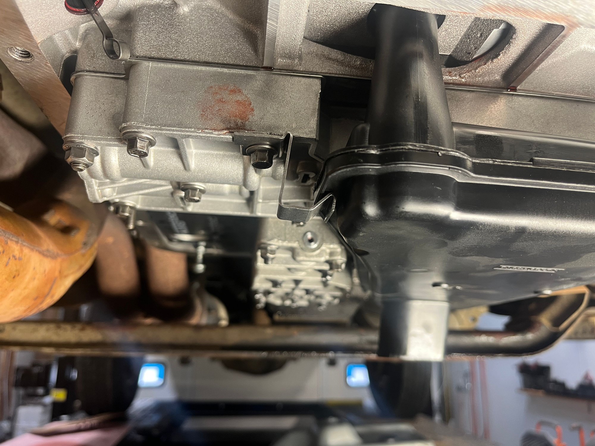

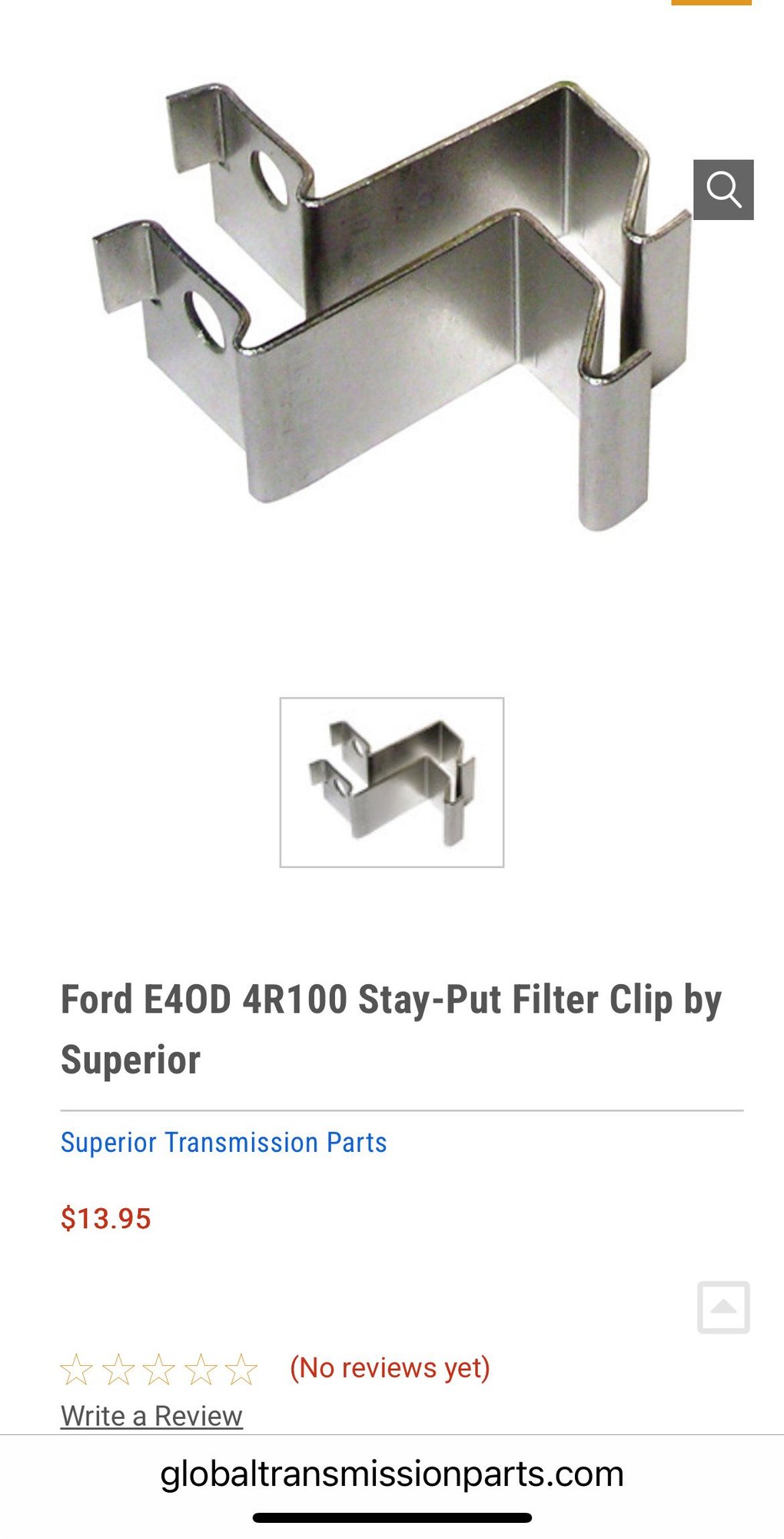

Some filters just don’t fit as tight as others and some don’t have feet that capture the filter against the bottom of the pan so they make these:
Old Dec 22, 2025 | 08:30 PM
HydroDog's Avatar
HydroDog
Joined: Jan 2007
Posts: 338
Likes: 101
From: Salkum

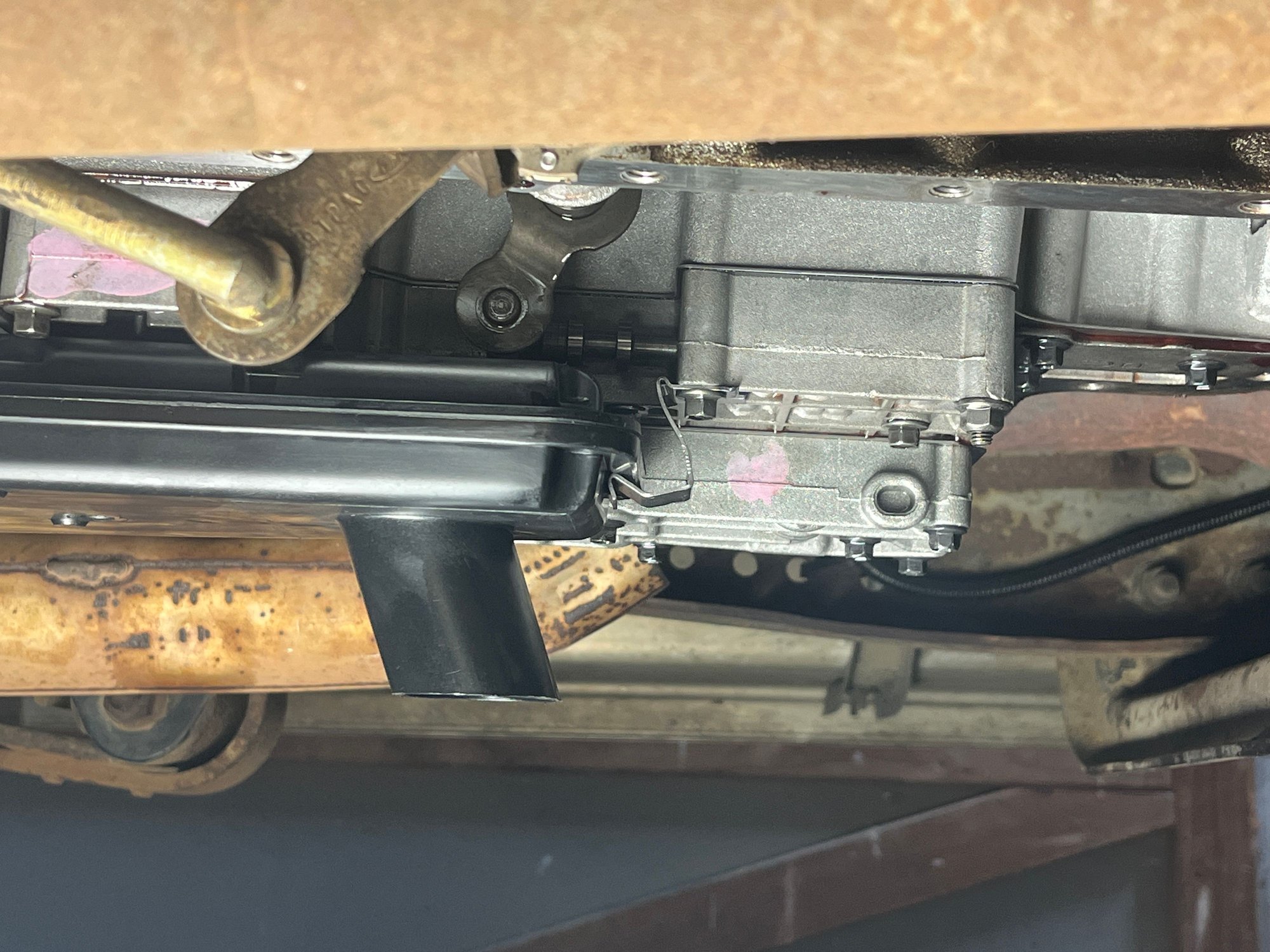

Here’s a couple pics from my trans. It only takes one but I bent the second one around so I have two on there.
