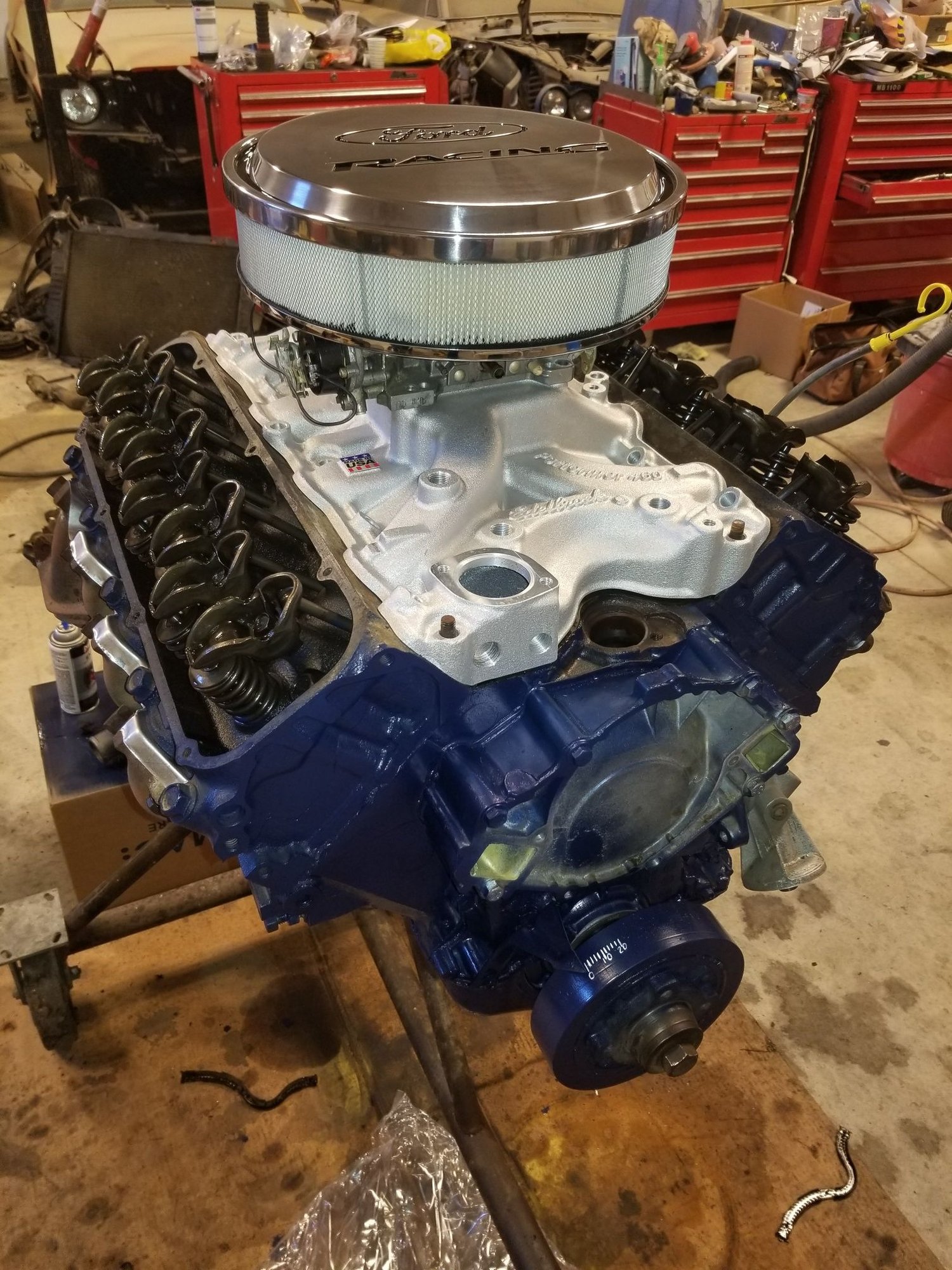

That's what I'm buying for my Performer Intake - the Dark Blue.
I like it best, but it also looks most like the 390 I'm buying.
Product photo of 390 Ford Truck Engine

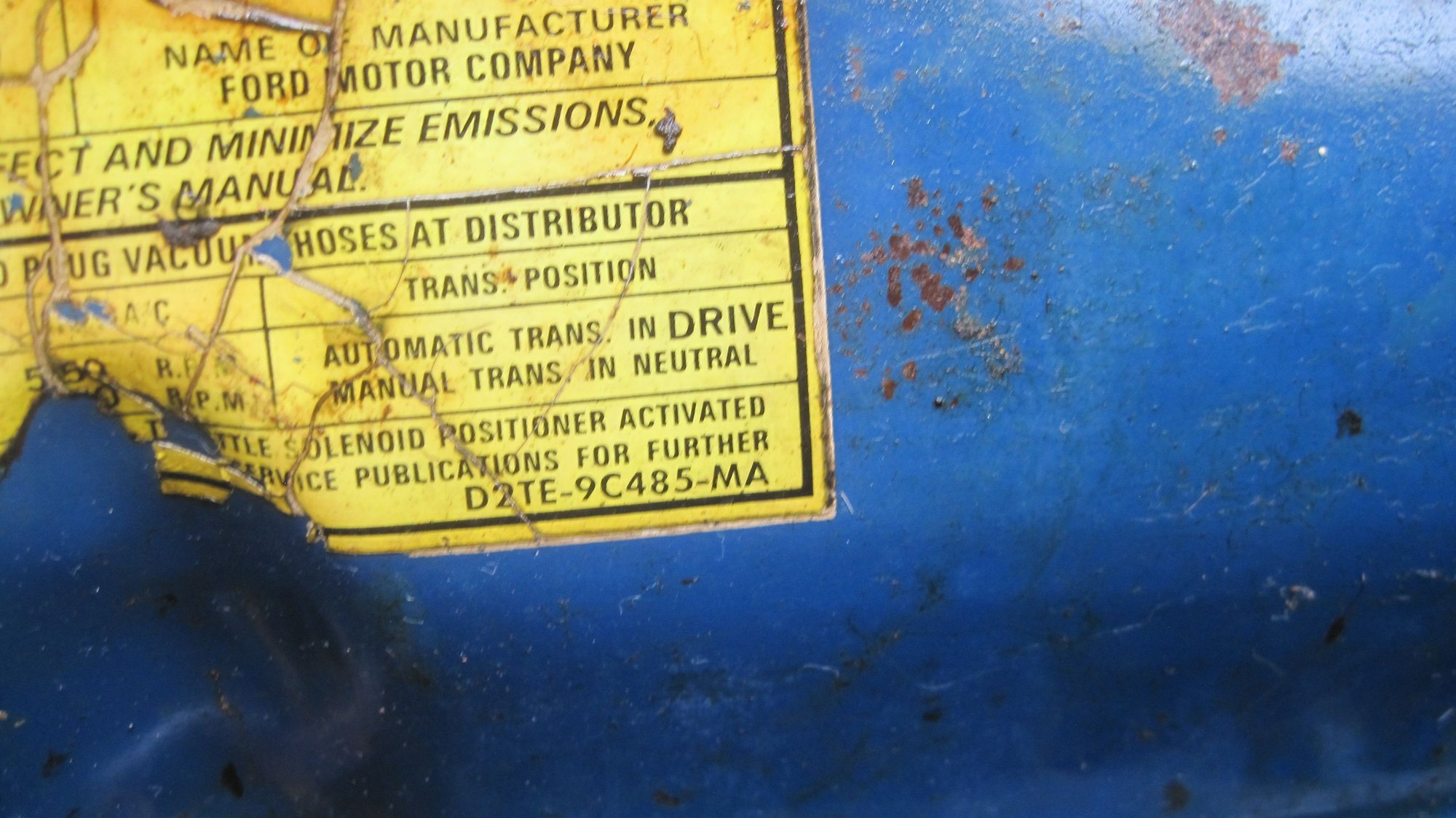

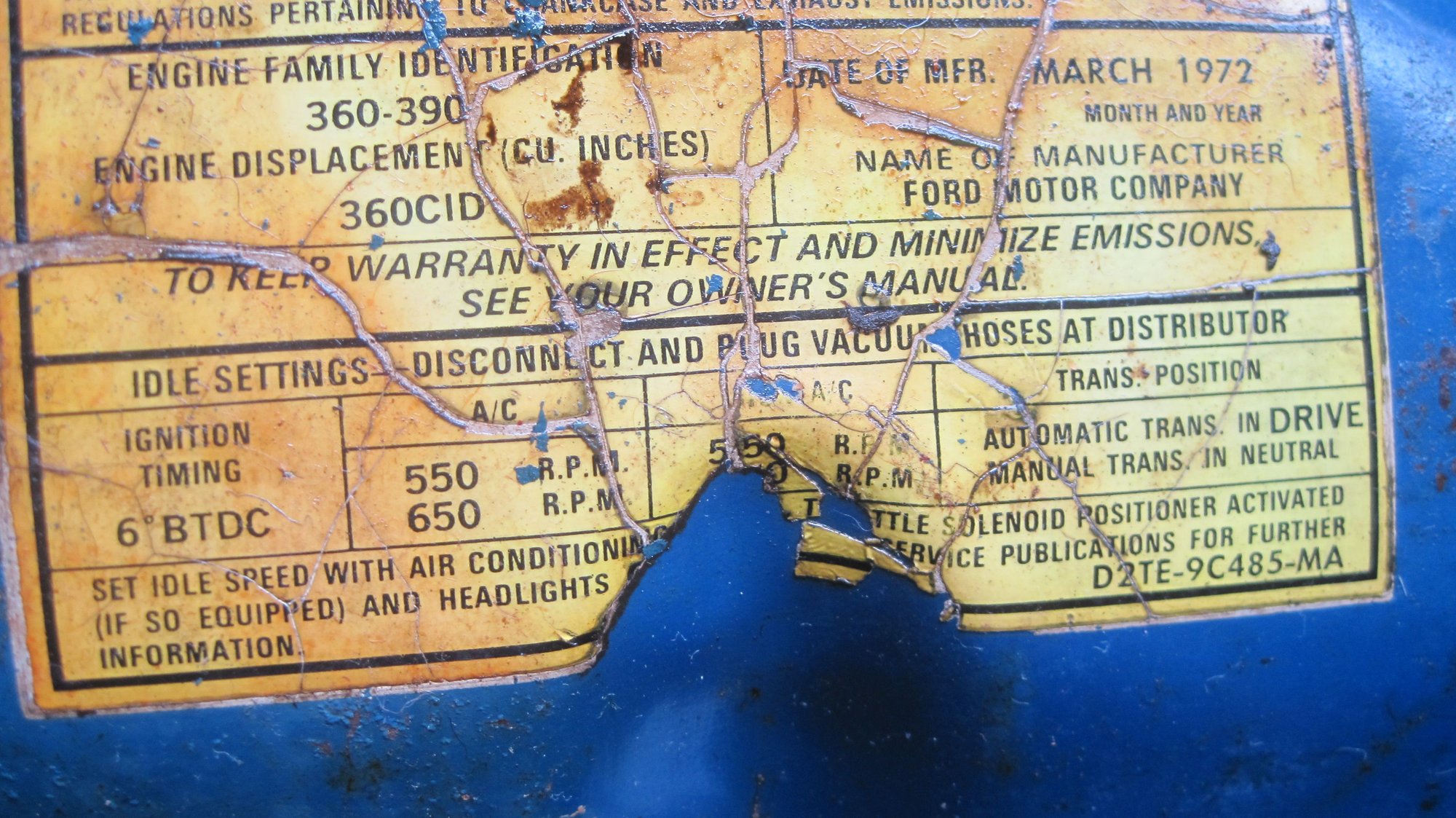

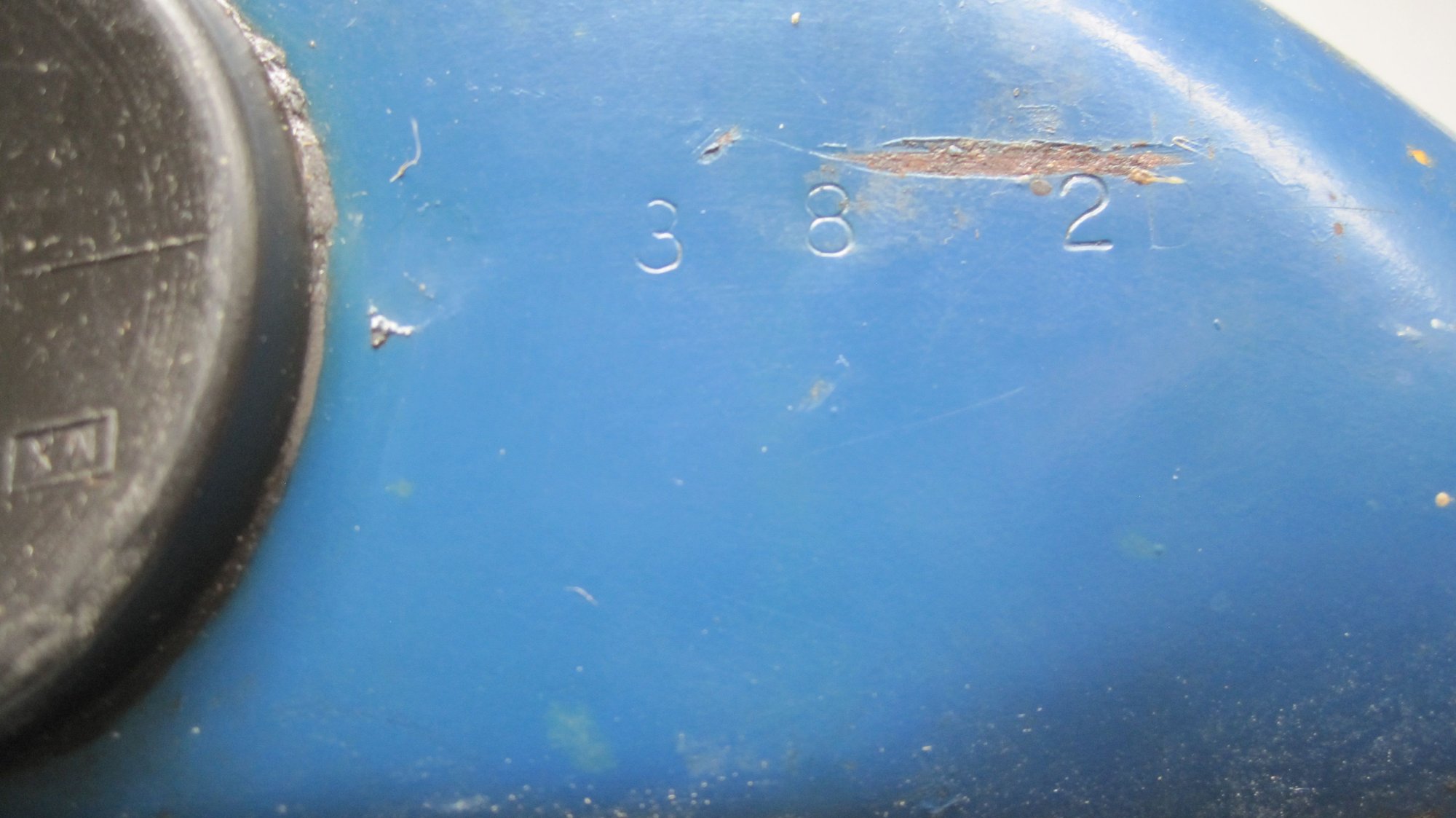

Original paint valve cover for a '72 360. Decals were color coded according to month, this yellow, notice the date stamping on cover near back pvc gromment, something you would never notice unless up close. There is a D after the 2, but is very faint. Appears Ford was one step ahead of the fraudsters even back then.

What decal are you saying is color coded to a month ? 3 8 2D is a date code March 8th I would guess if this was from an original engine the truck build date would be late March to the first week of April the valve covers only had month and day and no year 2D was the stamping plant.
