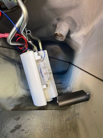

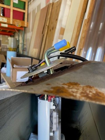

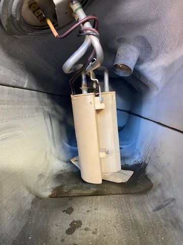

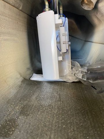

So I decided to go with Spectra tanks and FDM's. No problem installing the rear tank and pump. The front pump doesn't fit. I took photos and sent to Spectra tech support. They said return it and order a new one, haven't had any problems with them. but they would look into it.
Got the new pump, worse than the first one. The angles and orientation on the top plate are off. Sent more photos, waiting for a response.
second Spectra pump. Not even close
second Spectra pump
second Spectra pump
OEM pump
OEM pump
first Spectra pump. Lock ring wouldn't fit without removing strainer, sender float hits side of tank.
