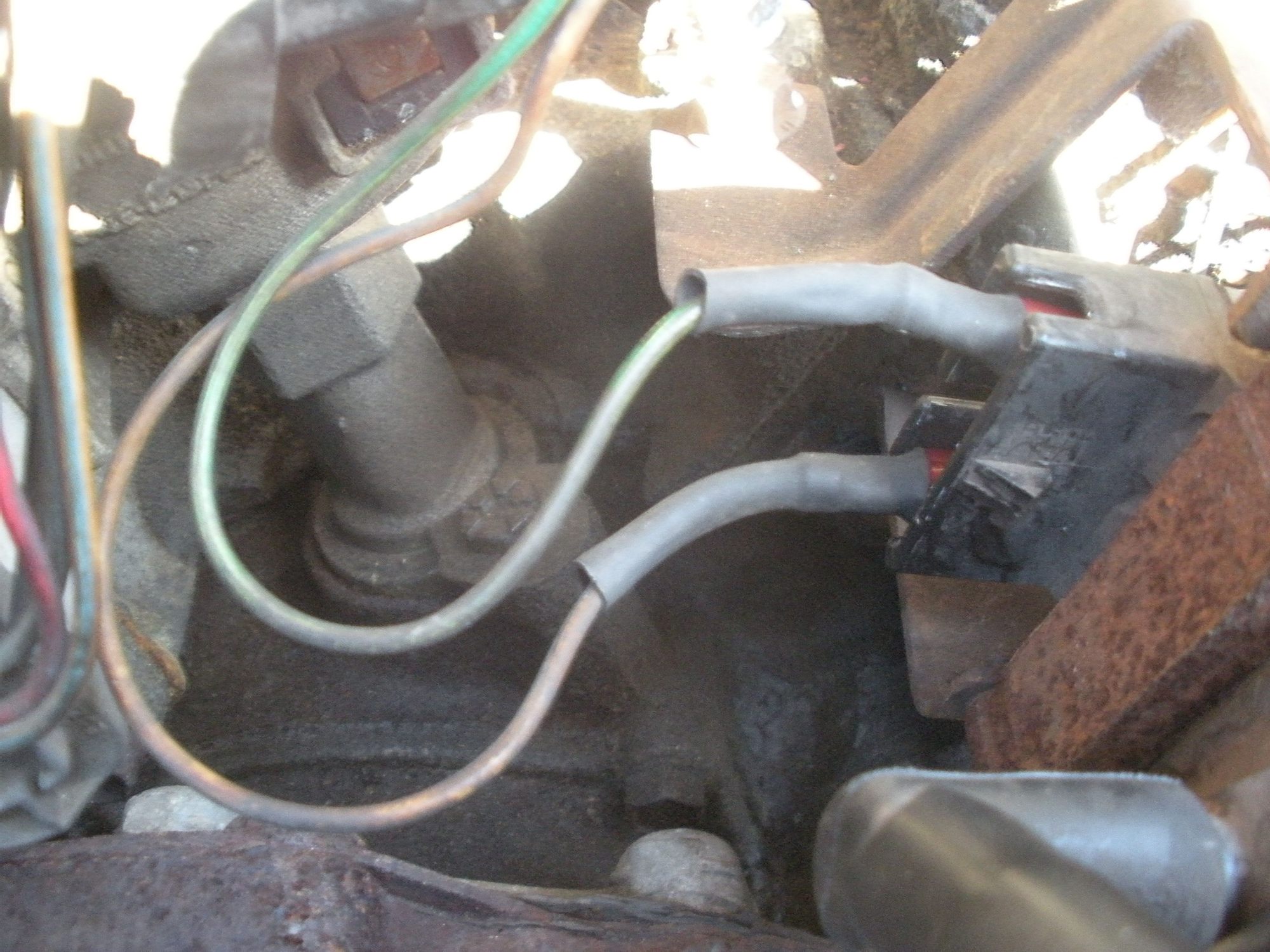

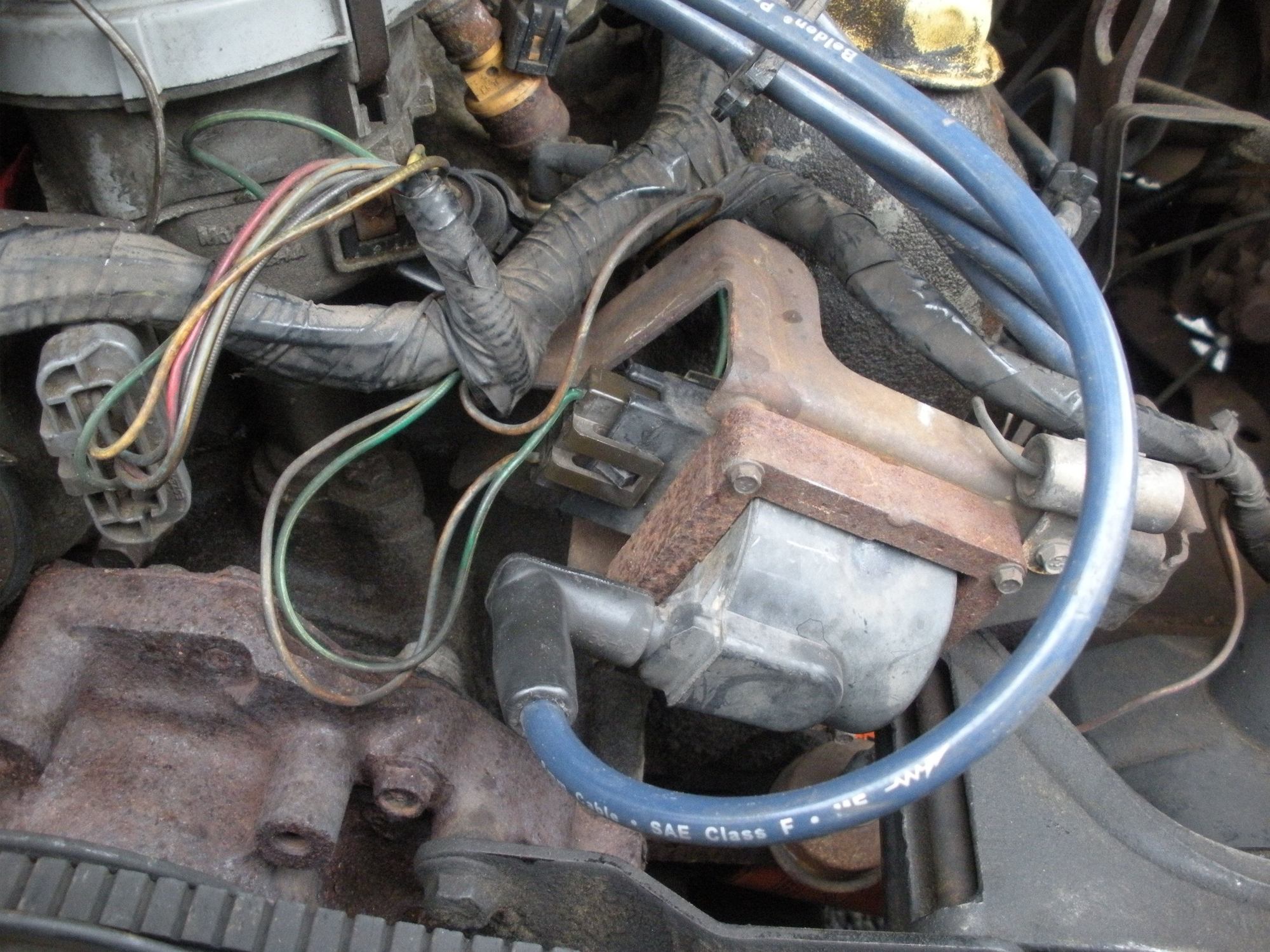

Have to agree with Dave, make sure there is no corrosion on the coil wires, it's one of those free, easy things to check.
What do the contacts on the cap look like as well as the rotor ?
