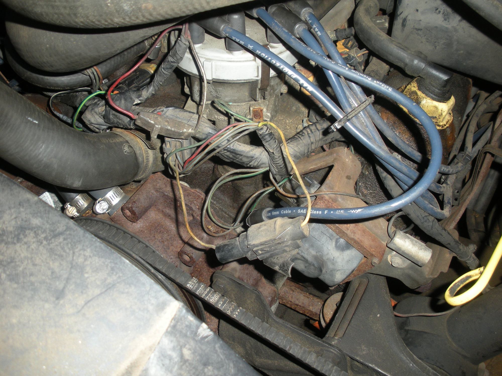

On your 1986 F-150 5.0L EFI, the SPOUT connector (Spark Output) is a small, usually gray, jumper plug found near the distributor, often within 6 inches, connected to the TFI module on the distributor itself; disconnecting it lets you set base timing by turning off computer control, usually to about 10 degrees BTDC.
See if disconnecting the spout connector makes any difference.

FWIW, here's the sprout connector. Yellow wires.
