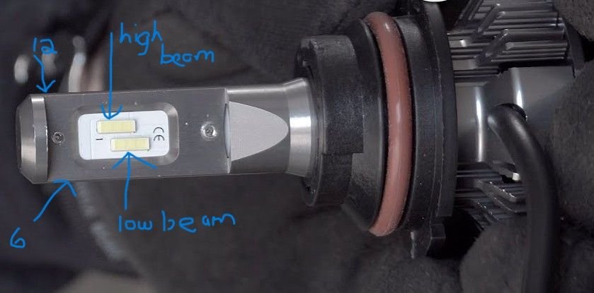

Thanks for info and brand suggestion. Those are half price of the ones i bought. These are brighter but do not align 12 and 6 o'clock as the instructions state. The bodies don't line up with The 3 alignment fingers in the housing. Closest one can get is 2 and 8. The main bodies are loose and adjustable but cannot be clocked for the 12 and 6. I just tried again. Thats also why the wiggle in there because the section is a sloppy fit. The whit light is brighter.

Sounds like you put them in sideways....the side of the Tetris piece that is closer to the tip of the LED bulb goes up at the 12oclock position (see pic). Put the bulb in first....snugly, you will see it go all the way in, then put the collar lock plastic thing on to keep it in place...then plug in the power wire.
I buy the Beamtech brand and have them in all 5 of my vehicles

On your second pic...the side closest to the camera is the 6 o clock side.....see the arrow. You probably have to put them straight in (oring might give you fits pushing it in all the way, so dielectric grease might help).

So the led doesn't face up and down, it faces side to side. The thin body faces up and down. No directions with these other then it says to face them 6 and 12. I assumed the flat led side was the face. As far as the o ring...... it isn't a problem. The body is a very loose fit. Getting it to stay in place while I push the retaining collar takes 2 hands of it falls out. I see some additional adjustment that might get it to pretty close. But not dead on.
Correct...if the LED is installed correctly, there should be 2 LED's on the right, and 2 LED's on the left. The proper top is the 3 squares that are most forward to the front. Those 3 squares are your high beams. The bottom stack of 3 squares is your low beam...and they should be rearward when installed properly. The pic I attached shows this.
The 6 and 12 are the thin sides of the body....look at the arrow I put on your pic....that side should be down when installed correctly.
Pardon the crude writing.....I was using a mouse.
great important info. Found headlight expers install video ( not a great video lacking detailed info ) on YouTube. They are saying to face the led flat side up. I should illuding to as they do not specifically point and detail it. Not imo. Facing left right makes more sense for light reflection. Also a dozen other customer videos that experienced similar poor customer service as I did.
I'll try them with flat side led facing left and right. Their video doesn't say anything about high or low beam orientation nor do the few words of instructions on the req sticker that tapes the box shut.
