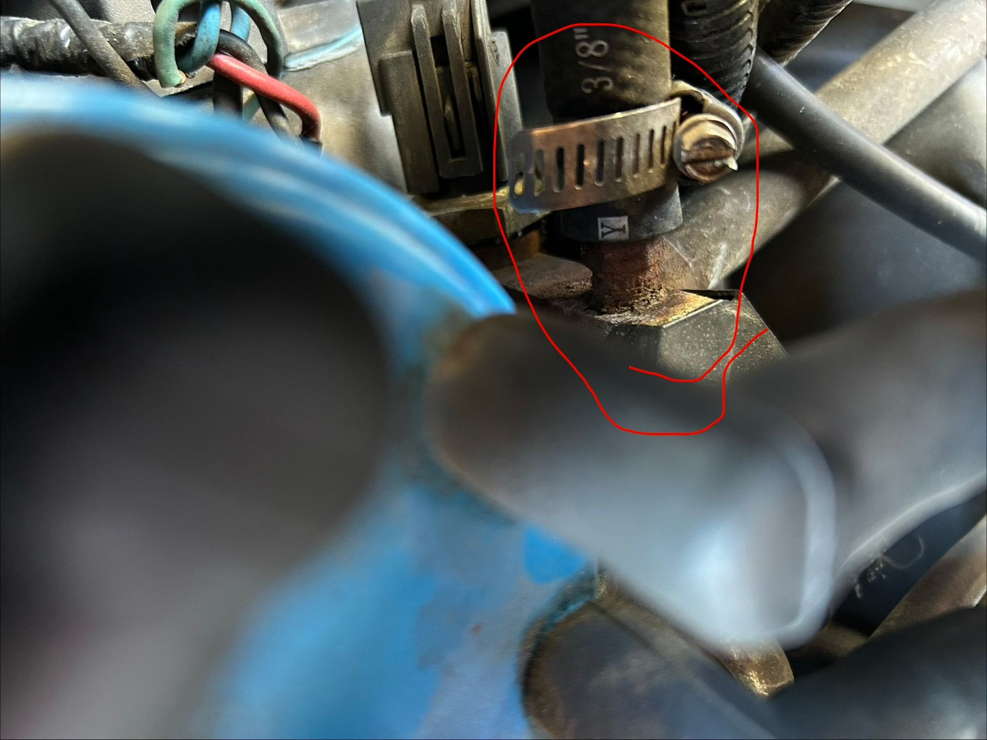

Who has removed the small metal pipe? I’m guessing just throw on a pipe wrench and turn? Any tricks like a quick pop of map gas or anything?
One circled in red.
One circled in red.

PBlaster after hitting it with some heat. it will suck in the solvent as it cools
the barb can be taken off with a wrench once you remove the hose

That’s what I was guessing. Just wanted to make sure it wasn’t press fitted or welded from factory. Thank you!

Never saw the part to put a regular wrench on it, but she’s off. It’s a weird size.. 7/16 and 11mm were too big, 10mm and 3/8 were too small…
