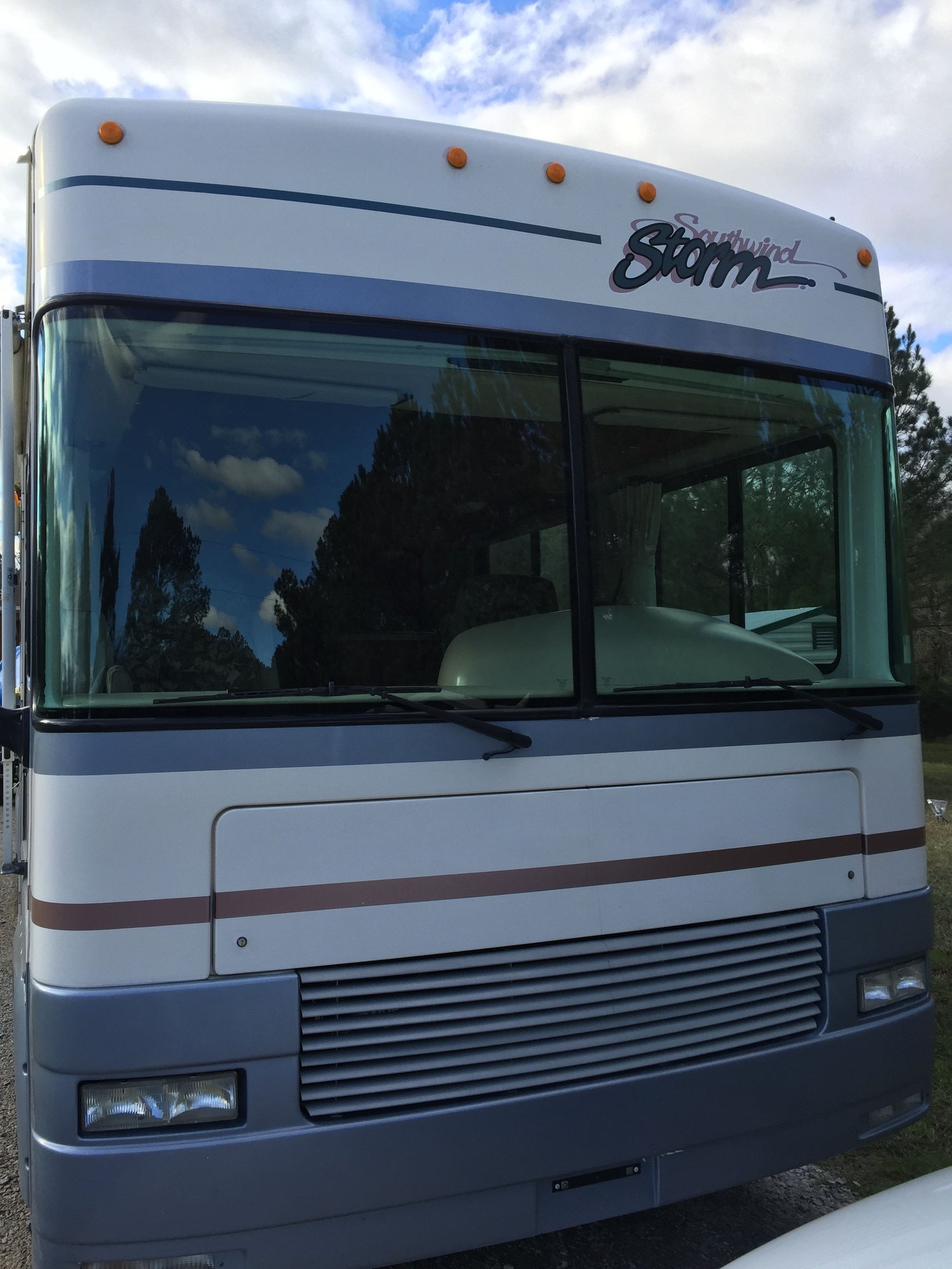

My Class A was on a F550 chassis, with the Triton V10...

I think that those are technically F-53 chassis, they leave the Ford factory as stripped chassis with the steering and control well forward of what a 550 would have, lots of common parts though with the heavier SD trucks.
