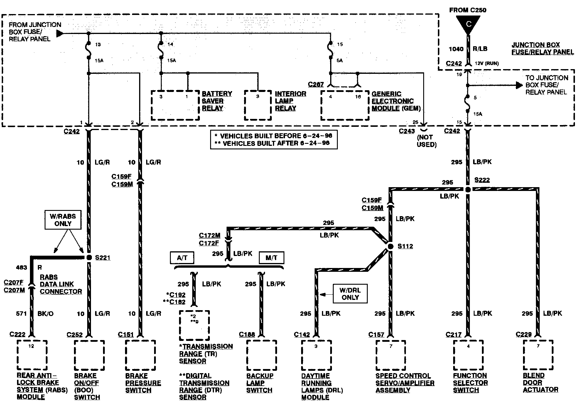

Here's the diagram. What I would do first is try to find connector C159. If you can disconnect that, it would split the circuit up and you could concentrate on half of it. Let me see if I can find a location for C159.
Old Dec 11, 2025 | 01:50 PM
Posts: 56,846
Likes: 2,681
C159 Left rear of engine compartment
Remember left and right are if you are sitting in the driver's seat. If you find the problem on the left side of the diagram you can then disconnect connector C172
C172Right rear of engine compartment

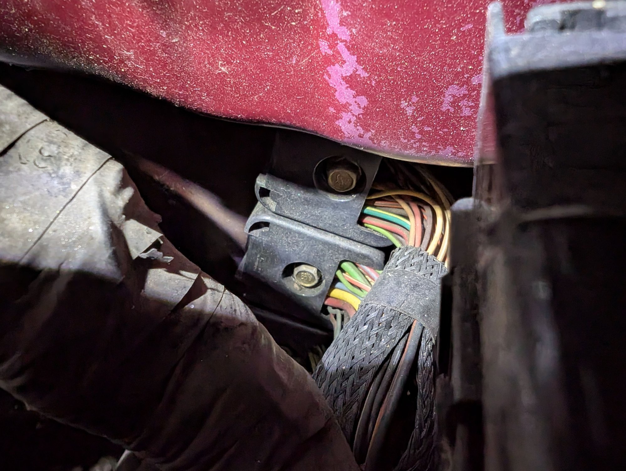

This picture shows C172. I can't find C159 in a picture.

possibly this? looks like it would be hard to miss if i can get my eye on it
I'm pretty certain one of these 3 are C159. 3 bolted to the fire wall Just have to match pin 1 yellow and confirm that its 159

C172 is on the opposite side of the engine bay under the main fuse panel plastic
