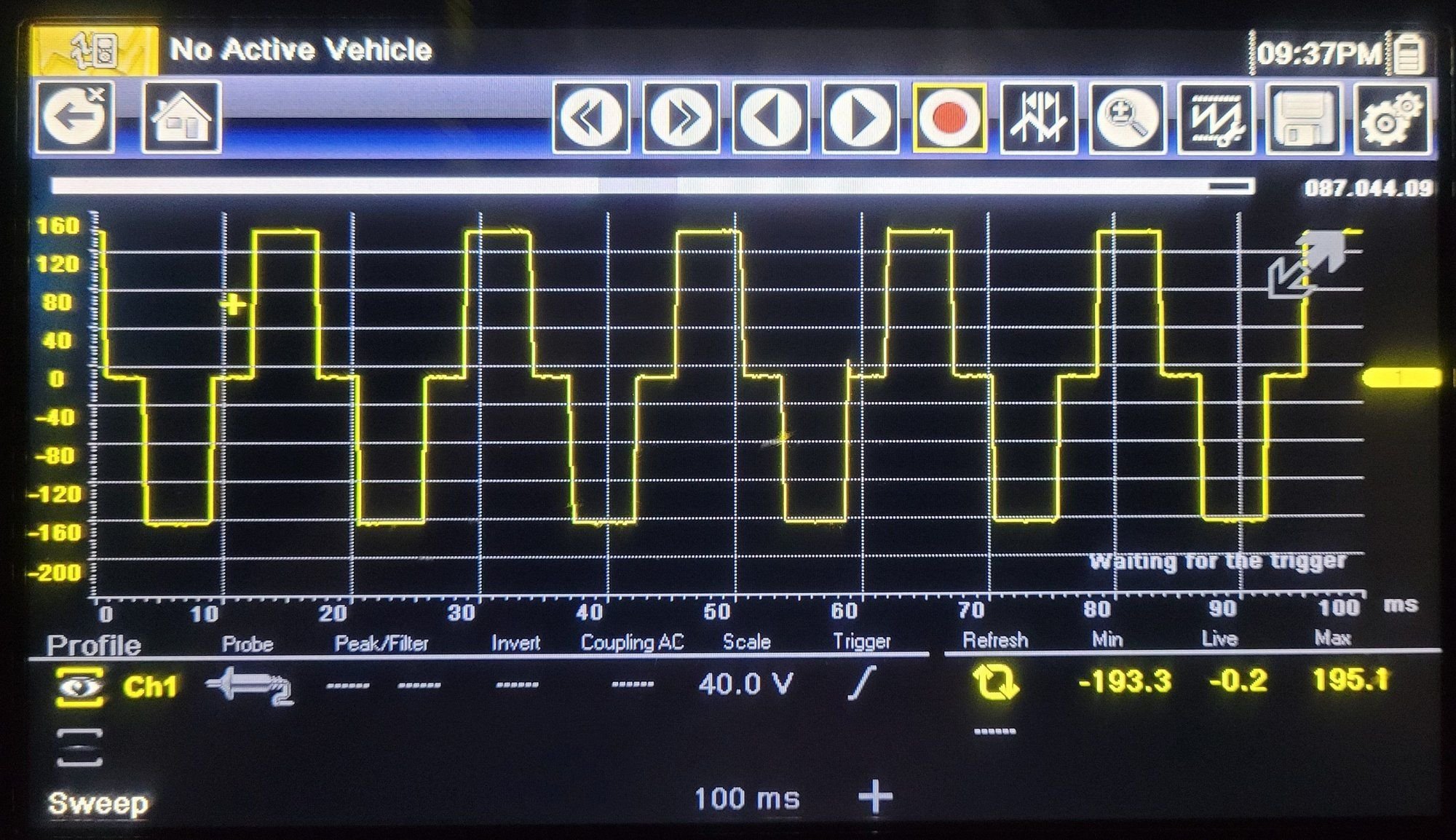

I’m not surprised given that this is what the output looks like:

I had no idea the output was that dirty. Is this from the 400W or 2000W inverter?

400 IIRC. There are plenty of threads on it. A quick google search will
yield a bunch, and some on upgrades as well.

Back to your question, rms (root mean square) voltage should be 110. Given the info HorizintalHunter provided, its possible you used an average-responding multimeter, which can be wildly inaccurate when the waveform is not sinusoidal. A true-rms multimeter gives accurate readings in cases like this.
