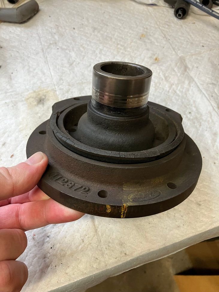

This is a bit of a whiny/venting post but maybe some of you can advise me how to avoid this problem!
I keep getting crap parts! I am not cheap with my baby! I will buy the good stuff. This whole project was about old-school reliability and I am not getting that due to part failures!
In the last 9 months and 3,500 miles since I finished the rebuild with all new parts I have had to change the
Starter selonoid
Fuel pump
and now
The harmonic balancer (HB) has slipped and needs to be changed!
The HB that has failed is a Doorman. I just ordered a Pioneer DA-3003 HB which is 20 bucks cheaper so I have no idea what I am getting but I know I am not putting another Doorman on there!
Last July, with less than 2,000 miles when I changed the sticking starter solenoid I read the reviews and the cheaper one had better reviews than the more expensive one that was failing had so I got it and so far it has lasted longer than the expensive one. Maybe I am doing this all wrong! Maybe I should be going cheap?
I don't have enough hair left to be pulling it out! 3,600 miles and three failures!! This is NOT the reliability I expected out of my classic 300!
I often regret throwing away the old parts on teardown and replacing them with all new! In fact, I just replaced my starter with a new one. The old one had not failed; it just was not spinning the engine so fast anymore but it worked! I blew off the $12 core charge and kept it just in case this time!

Unfortunately i think all electrical parts are suspect these days, with the high volume of imported parts. And its an old Ford Truck, not a Lexus.

Welcome to the club. We try to tell people if you have a original part that is working, cherish it and keep it on the truck. The mentality of replacing it all with new so you won't have any problems has been out the window for the past 5 years or so. There is no one holding the manufacturer accountable for their inferior parts. Why? Because they are all made in China. You go and buy a more expensive name brand part, guess what you get? Made in China, just like the cheaper one.

I never throw away an OEM part, even if it has failed, as many can be repaired or rebuilt. Down the road you're going to need a Cuban mechanic mentality, figuring a way around no reliable aftermarket replacements.
On my 351W, the original damper started to fail after about 40 years. I replaced it with a Dorman last summer and it has been fine so far. Here's the old one:
Did you save the original? There are several outfits that will rebuild them. Search for "Damper Rebuild Service" or similar.
DORMAN is CHI-COM.
They once had QUALITY PRODUCT(s) in reman, but that was decades ago.
As mentioned, the OEM damper can be professionally rebuilt. Service parts is now all (incl current OEM) a crap-shoot.

I have never had an HB fail in my life so I am double-shocked. Shocked it failed at all and shocked it failed at 3,600 miles!
