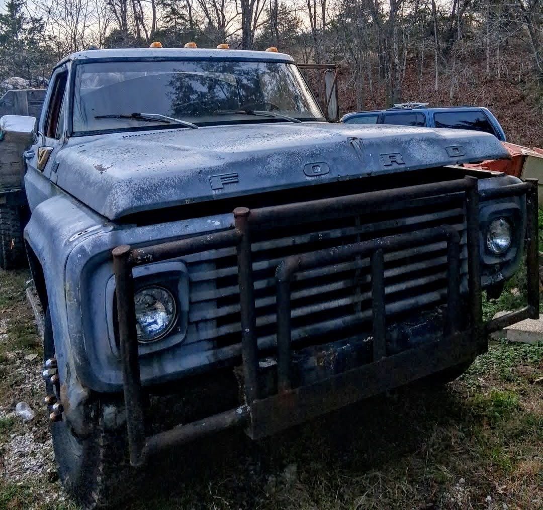

A '72 should be a Bump side, a '77 a Dent side.
Is it a runner/turner/stopper etc?

Thanks for the reply.
To answer a few of your questions.
1. "This appears to be a '77, what is telling your '72?"
It's what I was told.
2. "A '72 should be a Bump side, a '77 a Dent side."
I'll look and get pic tomorrow.

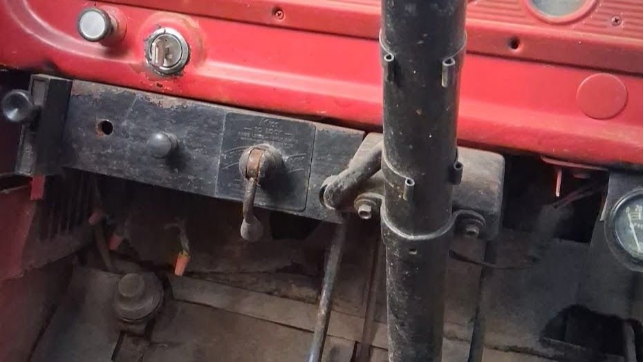

Love those automotive-grade orange wire nuts, lol.
Is that one of those front-brakes-disable valves I've heard about? Or does it lock some of the brakes instead? I can't read the label.

Hard to tell without the label, but I’ve seen similar setups used to limit front pressure on farm trucks or for dump/low-speed use.
