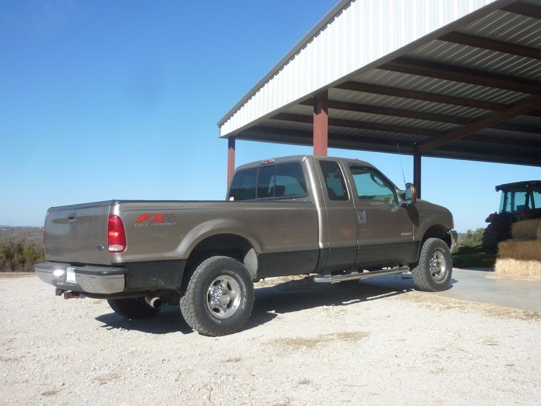

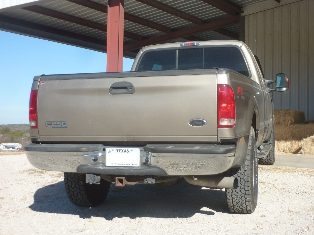

I ended up going with Toyo Open Country AT3 size 285/75/R16. They look thinner than the Falcons in the same size, but that's ok if they give me better gas mileage. I now have a lot more vibration at highway speeds. Going back for a re-balance next weekend. Same old story.
