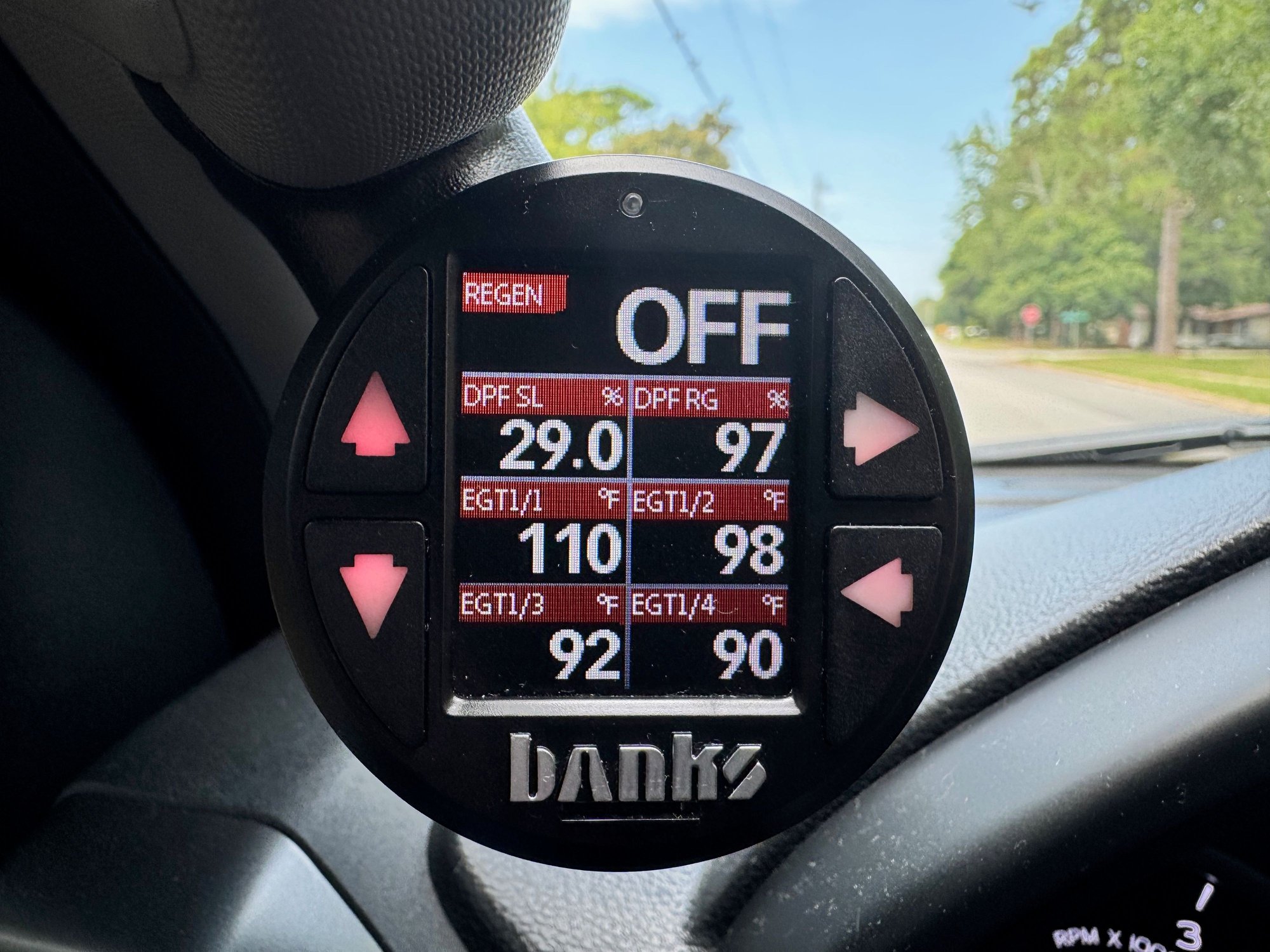

As mentioned, I cannot tell that my truck (22MY) is in a regen by sound, smell, or any other type of perception. You can look at your instant mpg readout and notice that they have dropped. Other than this, you can turn on OCR via Forscan, which gives you the DPF% screen and the ability to turn Auto Regn on/off. This will give you some control over when the regen occurs, but it is not as simple as turnng it on or off. The truck still has parameters it must meet first. Aside from this, get something like the iDash which gives you the ability to monitor not only regens, but much more, and it will also allow you to see and clear codes too. It's a very handy tool, but that does not mean it is necessary. I love mine though! Here is a screen I have set up for my regens.

This is exactly what I do. I turn auto regen off until the DPF reading on the truck (enabled via ForScan) hits 95% - 100%, then I drive until it’s complete. I have found the regen goes faster at speeds of 35-50 vs freeway speeds. I have a backroads route near my house that takes about 20 minutes to do a regen if the truck is already at operating temp.
