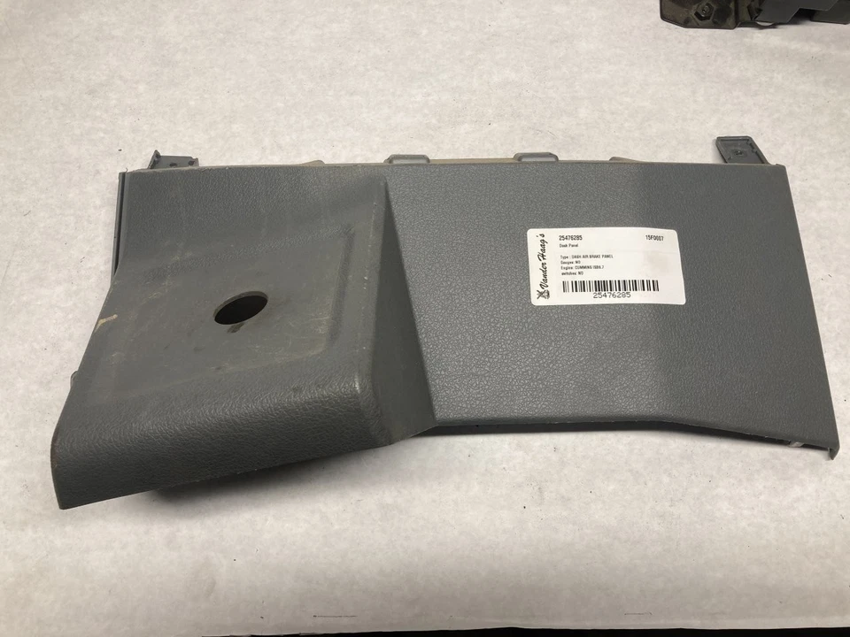

I've been looking for an F650 lower dash configuration in several places to no avail for awhile. I did find one recently that has the big protrusion for the air brake switch as shown below, but don't think it will work with my 4x4 manual floor shifter...plus I think this is for a newer year model and may not fit my truck.
I've looked at the aftermarket lower pod mounts that fit below the cubby hole and adjacent to the trash bag holder, but I can only find a 3 gauge pod and I have my trailer brake controller there.

Yea that's for a 08+ dash for sure.
