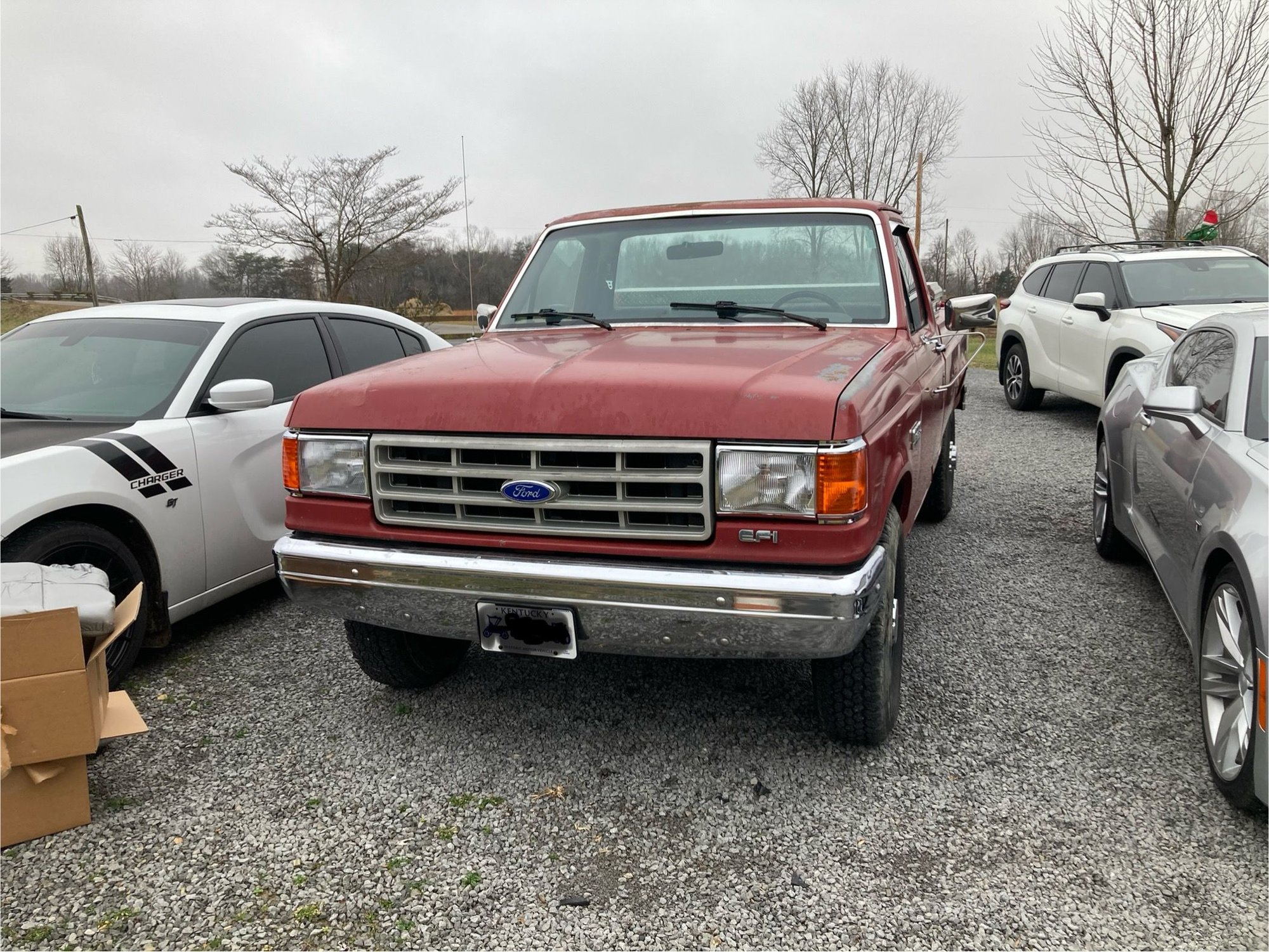

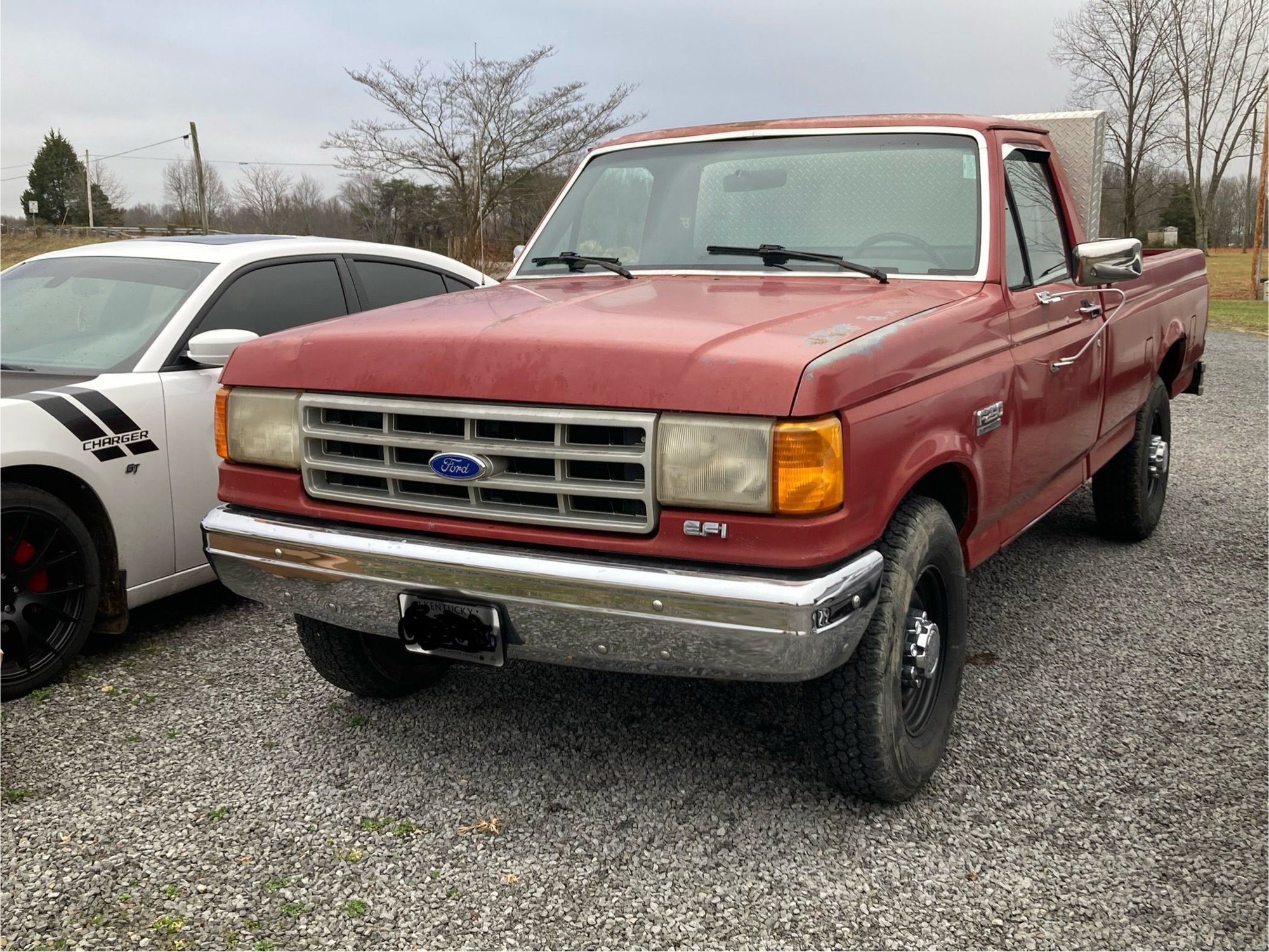

Before
Before
After
After
Got some new headlights for Christmas, crazy how the little things improve on the looks. And I hope everyone had a great Christmas!
