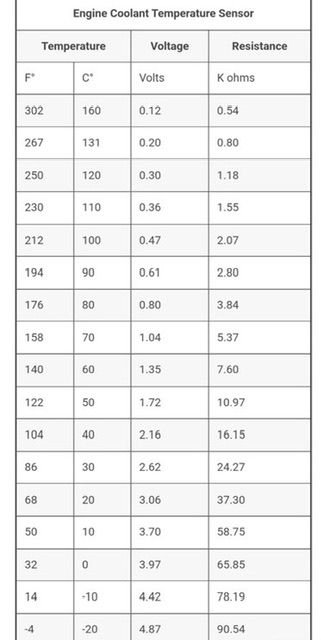

I have had brand new idle air motors as well as other parts be junk right out of the box. Is the computer doing that because of a bad coolant or air temp sensor or is the new IAC bad?
Liberated from someone’s post:
I don’t have the air temp sensor specs but I’m sure a little searching would find it

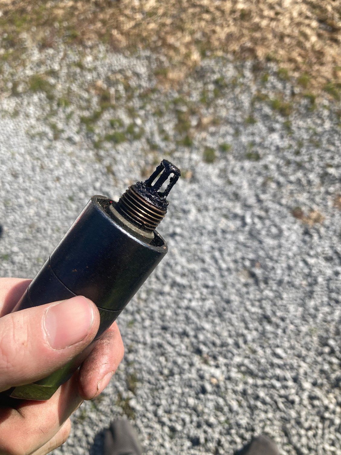

Originally Posted by 90project5.0
Have you pulled your intake air temp sensor for a look? Do that and I would pull the idle air control to clean it/inspect.
Well that certainly would do something
Well that certainly would do something, dirty as a dodge

Judging by that, I would guess your intake needs a good bath!!! Clean won’t hurt, probably! Test it after you clean it to make sure it’s good. Check your pcv for more giggles. These intakes get nice and oily especially with an older non rebuilt motor! I have a catch can to assist with it.
Definitely getting a catch can for it lol, going to drive it as soon as I get back with the cleaner! Thanks!

Be careful cleaning it!! The probe inside is very fickle!
Welp I cleaned it and it seemed to change something, will drive it in the morning to see if it really changed anything it’s almost 60 Degrees F right now so not the most optimal time to test if it really worked. It felt like it hesitated on takeoff once but it seemed to do fine the rest of the time. As for it being fickle, I ended up breaking the plastic part the harness plugs into…. Uggghhh, but I have it temporarily glued until I get a new one so that might have caused the one hesitation I felt.
