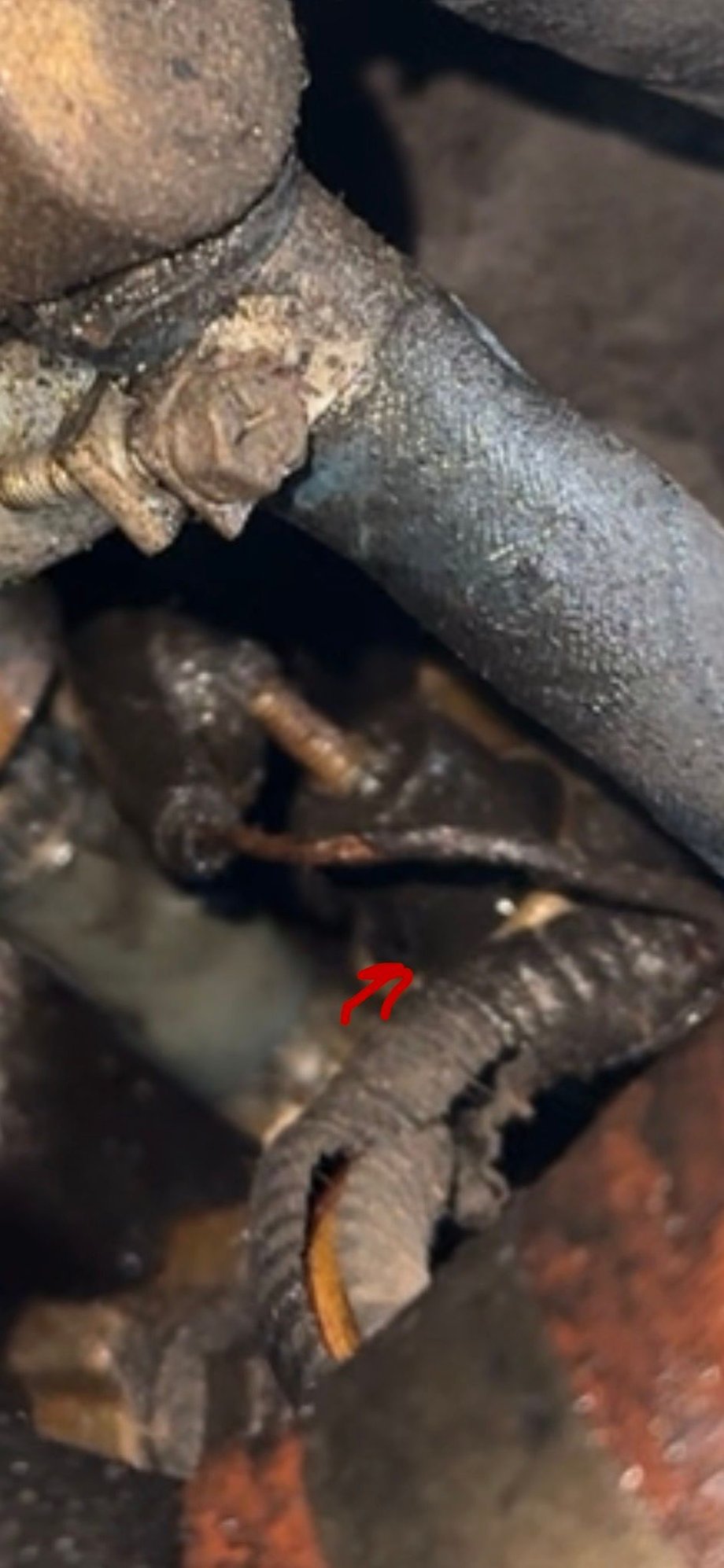

I have a fuel leak, see attached photos.
I don’t know what it actually is considering I can’t find any part online that matches it, but it’s coming from here causing a fairly significant leak. Thanks in advance.
Back side of fuel filter/bowl housing.
Black nub with brass colored thing sticking out of it. It’s leaking from the black part where it goes into the bowl/housing.

That's your water-in-fuel sensor; see this article. You can get all of the O-rings to completely reseal your fuel bowl for $20 from RiffRaff or Diesel O-Rings.

That’s what I thought it was but couldn’t find a picture like the one in that article. Thank you for the help!
