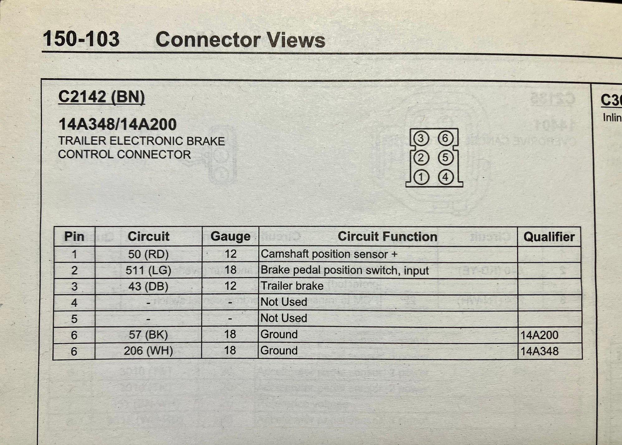

The wiring harness that connects to the underbody trailer wiring and goes to the 7 pin trailer connector on your 2012 has two underbody connections:
C422
C495
https://charm.li/Ford/2012/E%20350%2...-%20C603/C495/
https://charm.li/Ford/2012/E%20350%2...-%20C603/C422/
Here is the wiring diagram for the TBC
https://charm.li/Ford/2012/E%20350%2...ailer%20Lamps/
Look for the TBC wiring/connector., C2142
https://charm.li/Ford/2012/E%20350%2...20C3133/C2142/
The 2012 F150 underbody connections are not the same as Econoline.
