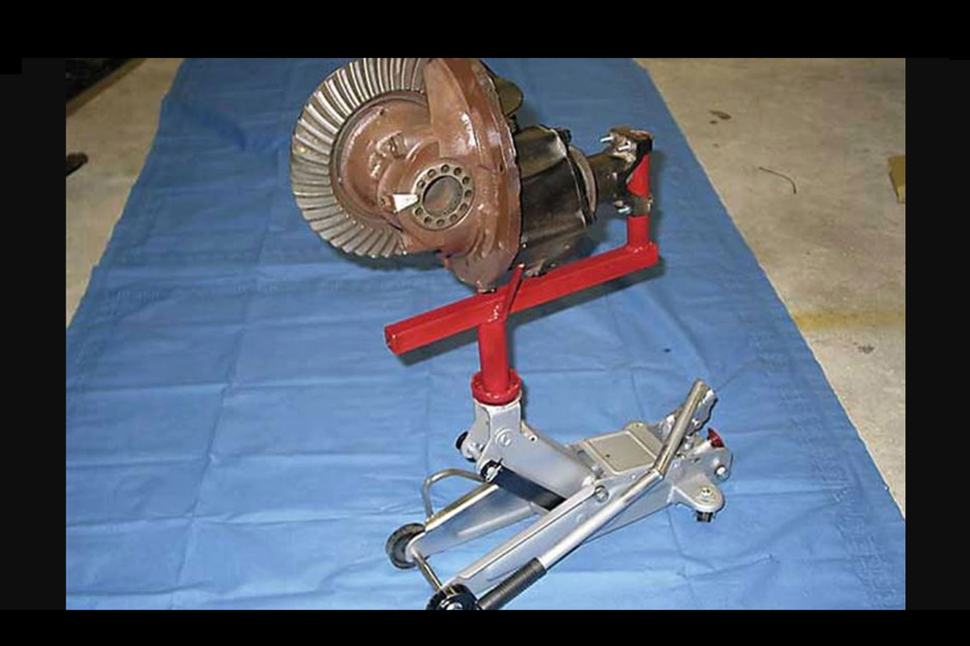

Cauation that 3rd member is HEAVY. Again another FTE members idea, that is a great one.
