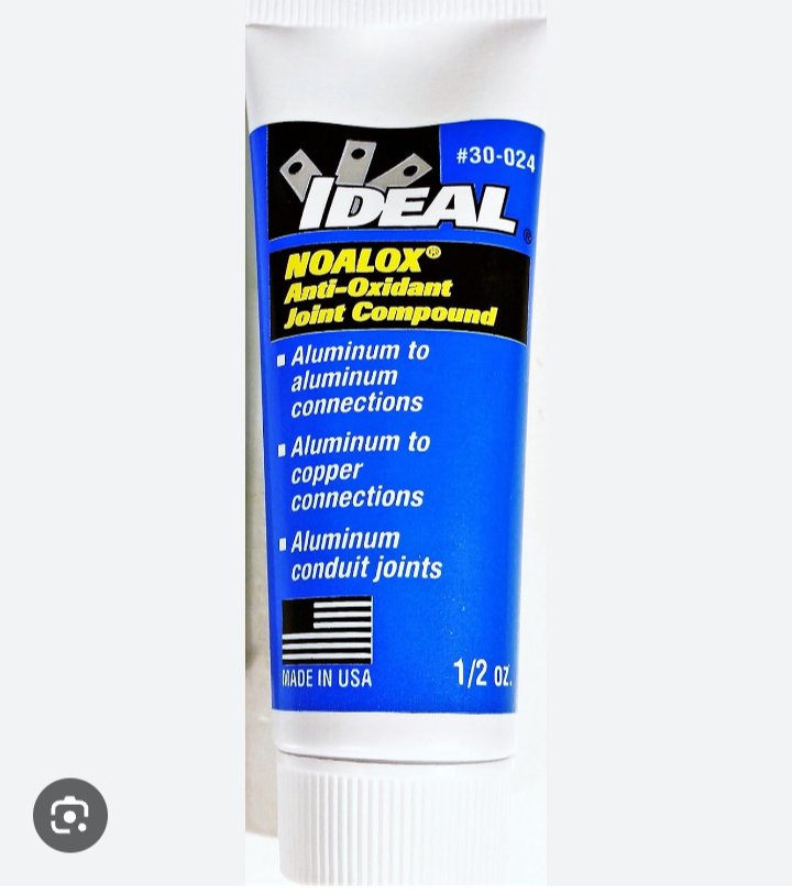

Glad you got it.
I use anti oxidant on anything I unplug.
