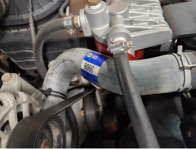

I think this is the part number you want,
I just went to NAPA or O'Reilly's and said I want the one that goes behind the belt.
Hose behind the belt
