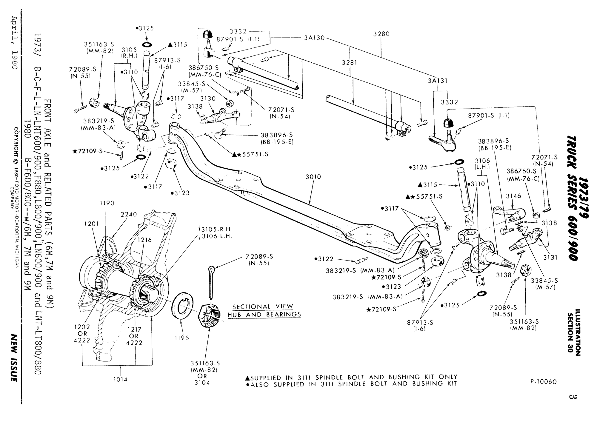

trying to find new kingpins. any help would be greatly appreciated

Does it still have the 300 Six?
L = 6,000 front axle w/PS
You probably want the service kit 3111
Maybe axle C7TZ-3010-A for '76 F600 w/6M capacity.
"Pin and Bushing kit (Spindle)":
  • Std. -size pin C7TZ-3111-A
  • .010" Oversize pin D3TZ-3111-A
Those service kits fit a lot of different capacity axles, so probably a good bet.
From $40 at eBay
Several aftermarket sources
