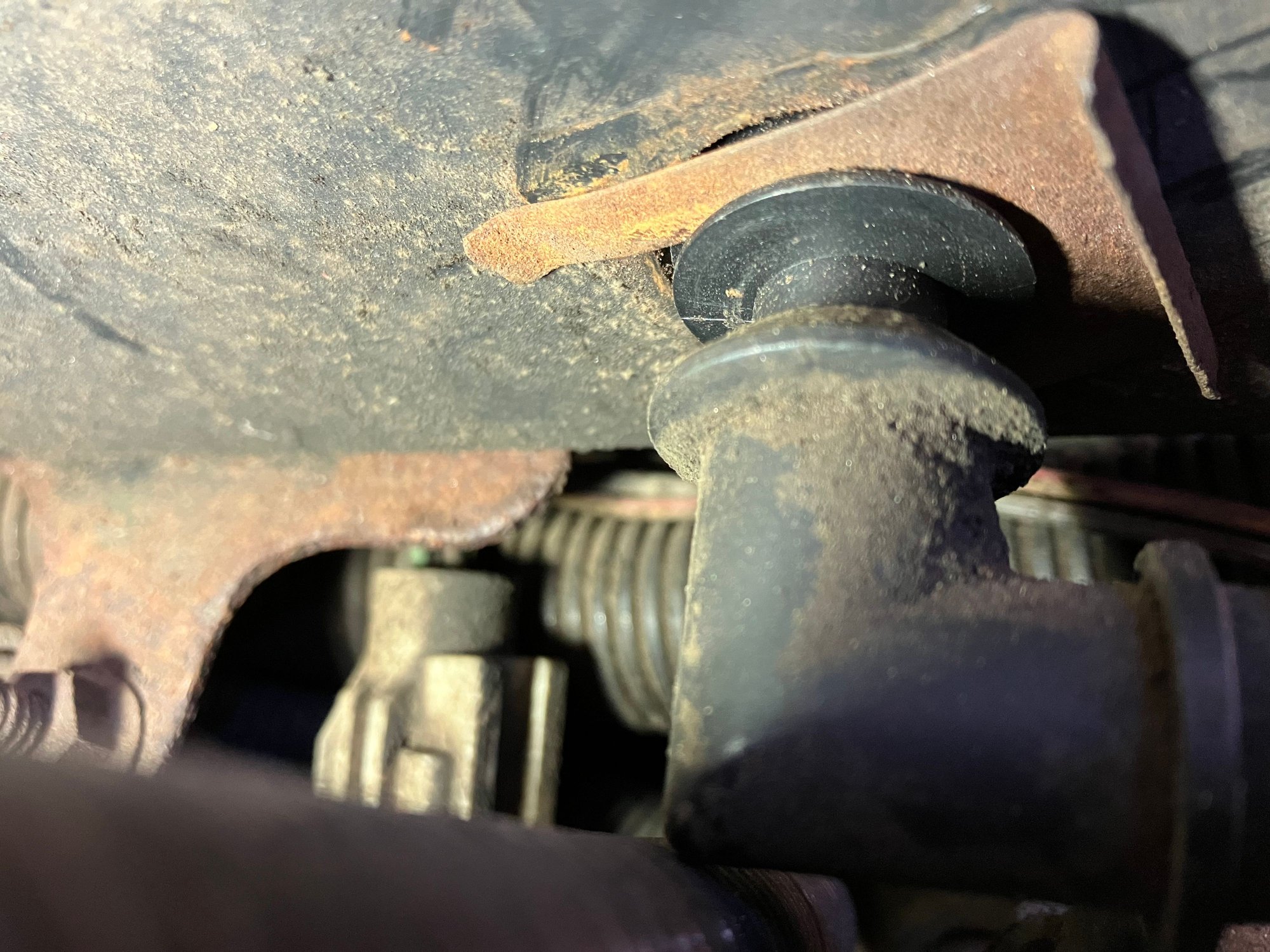

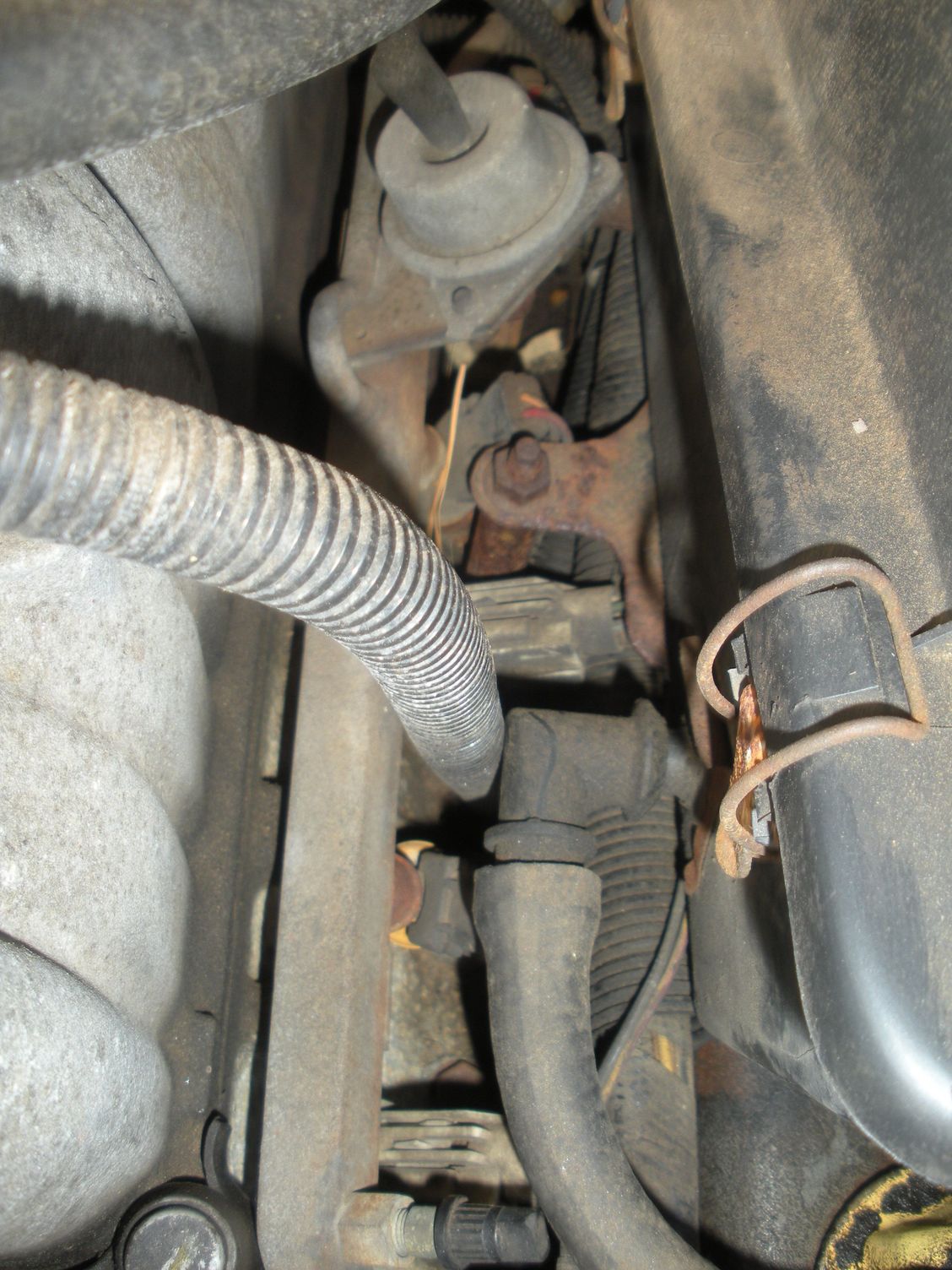

Knock sensor is part of your engine wiring. It has a lightgreen/black dot wire and a black/white stripe wire.
Here is a picture of the location.

Hi, Dave. Thanks for the diagrams, and yes, on closer inspection the green wire from my component does have black dots; so I reckon it is the knock sensor all right. There's just no where on the engine where it could be plugged into something...it's always just been lying there. Would there be any point to rewiring it into the loom, if it's not actually hooked up to the engine?

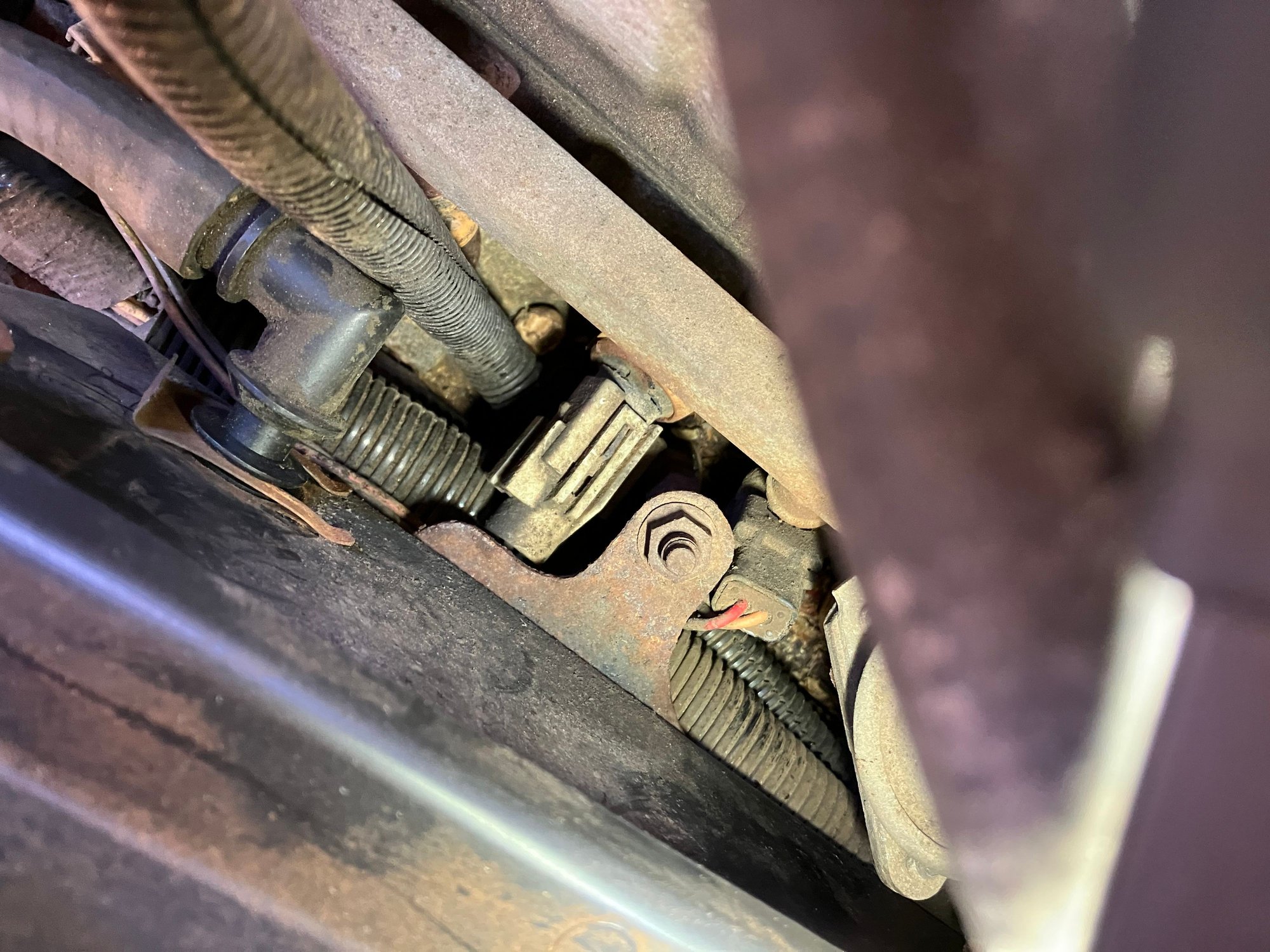

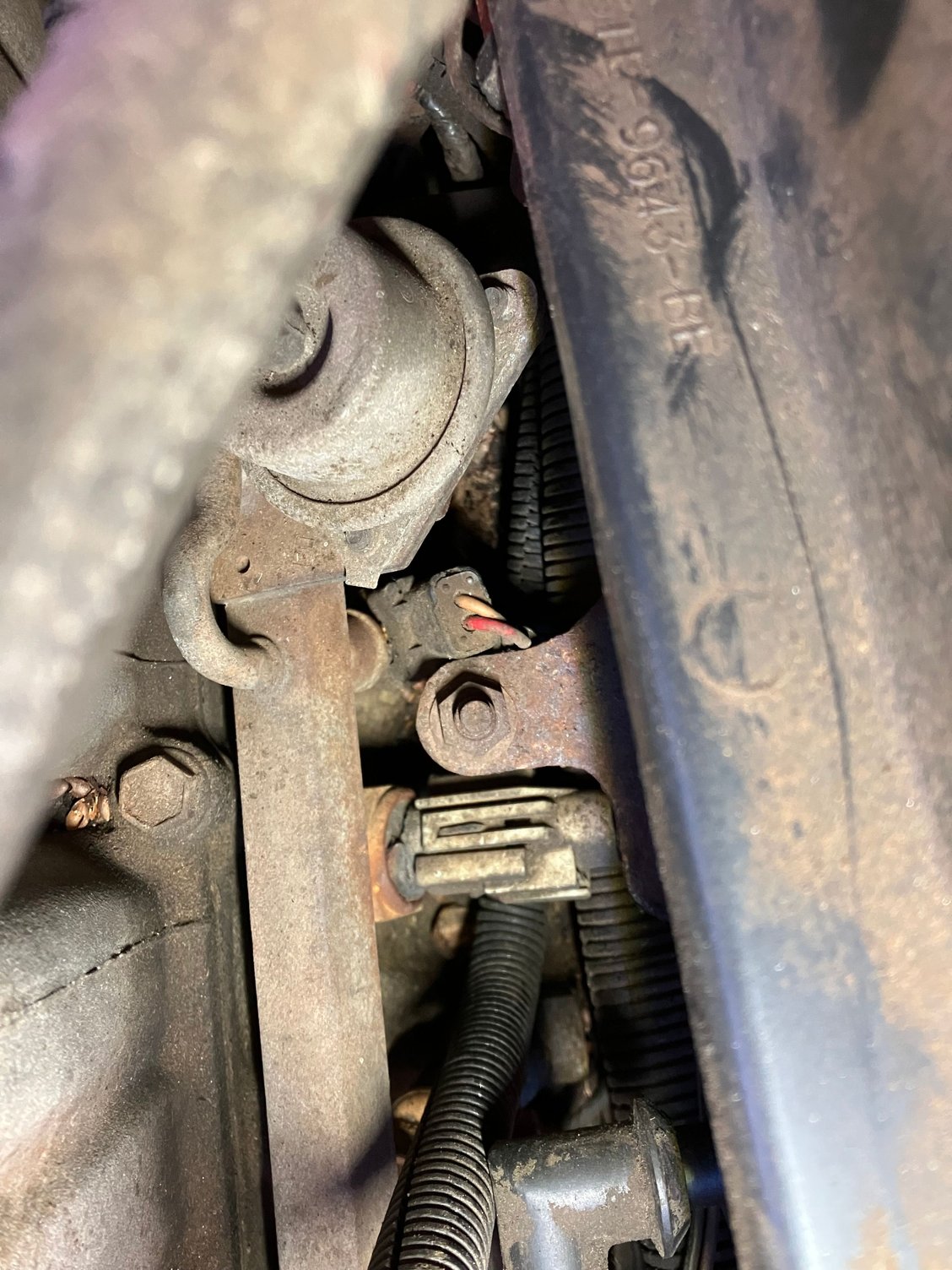

Found them, "knock sensor" that's it down there behind that black plastic tube that goes into the ait filter box. I'd say its between #6 and #7 injectors.

Thanks for the photo, Max. That's where I thought it would go, but there's nothing there...no plug in mount, nothing. Our Aussie built Windsors must be different, I guess. So maybe not bother reconnecting the sensor to the wiring and computer input?
There should be some kind of port/hole in the lower intake manifold where the sensor would screw/ mount into. Playing around today, I got the 4ft stepladder out and decided to try and get a better picture.
I see it threads in, I searched for it,
