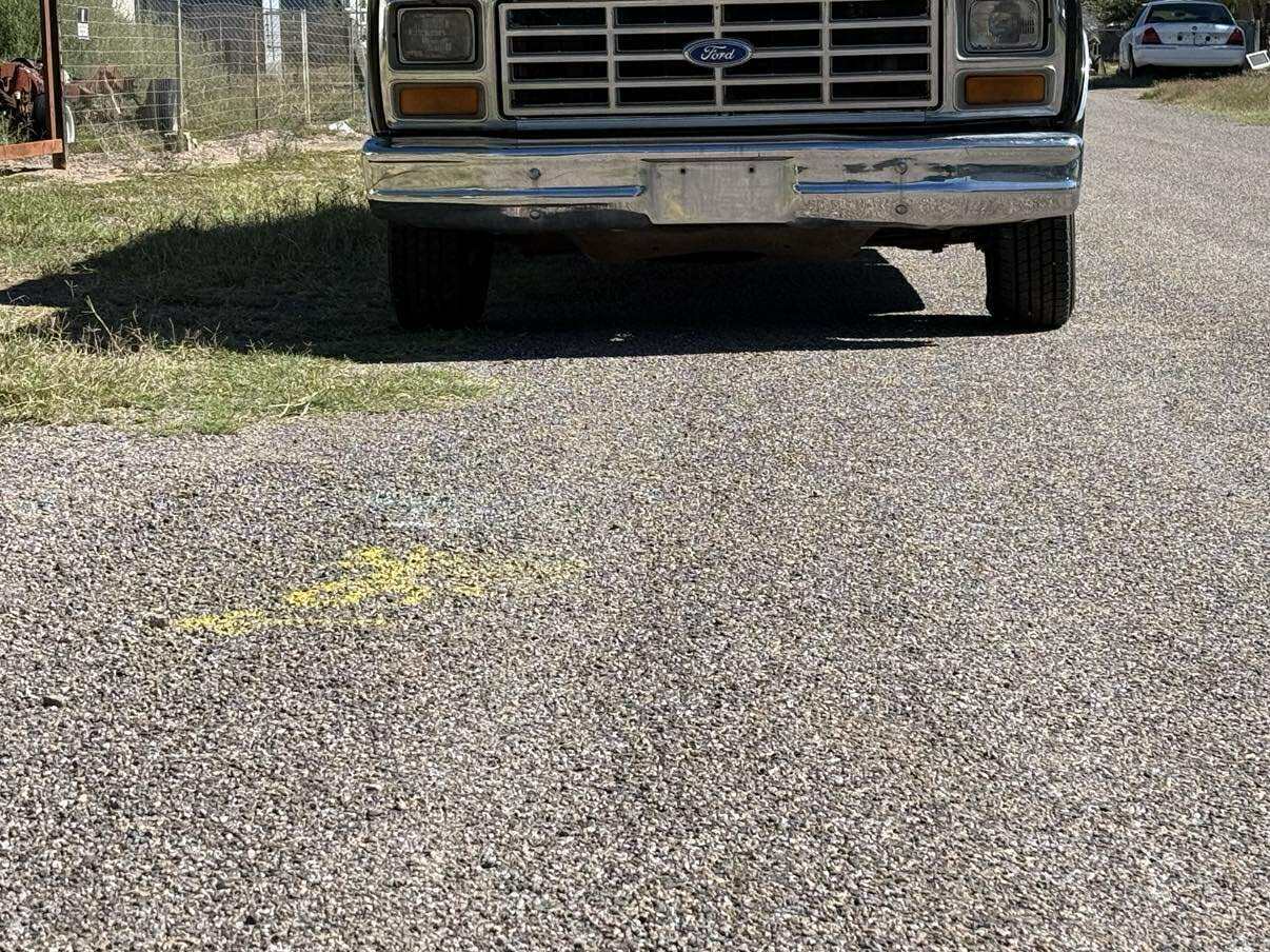

I have a 1986 F150 XLT Lariat 4.9 with the 4 speed.
This is my fun truck that I just silly things with. Most recent silliness is the 3 inch drop springs (yes yes I know DJM I-beams) and axle flip.
I have a lot of negative camber. I am not looking to get everything perfect, I do not have the drive to do every bushing in the front end right now.
What camber bushings fit the 2wd drive, everything I find is for the 4wd?
I have searched but search is only as good as the search terms and I just have not had any luck finding part numbers or experiance with a lower truck and negative camber, I keep finding lifted and positive camber
Any help with part number, links or better search terms would be great

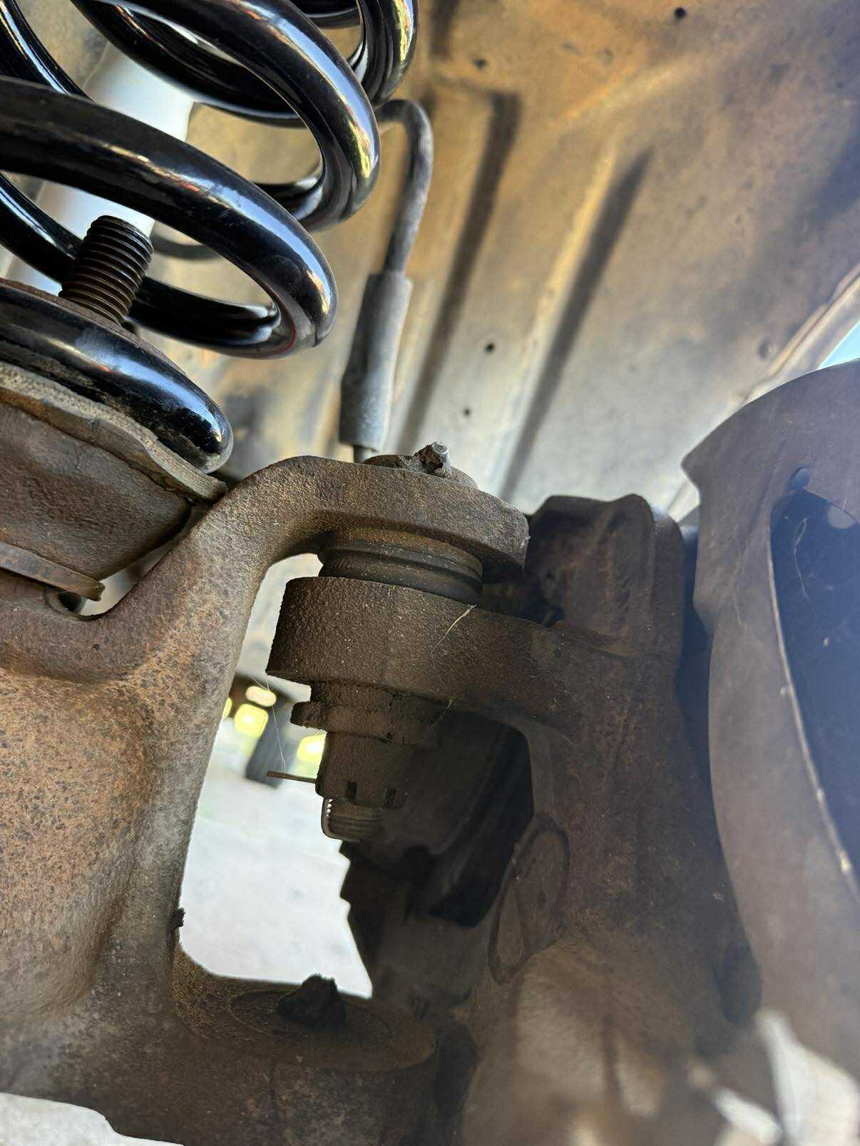

It looks like you have adjusters already do you know what size they are because they might be able to be turned and used.
Just note when you turn them besides adjusting camber you are also adjusting caster and you may only be able to get both close to what they should be.

Unfortunately, I got screwed at the local alignment shop. They had by truck 3 days and gave me this song and dance about how hard they tried to adjust the front end. I needed the truck this last weekend so I just picked it up. I got bad feeling about how much "work" they said they did. Well you can see by the pics above how hard they worked on the camber bushings. So I will be doing this myself as no other alignment shop in my small town will touch my truck due to the I-Beam

According to everything that we and SPC show, those SPS-24160 camber/caster sleeves should be correct for your 1986 RWD F-150. @FuzzFace2 made a lot of great points. It looks like your truck already has adjustable sleeves in the upper ball joints where they sit in the spindles. These sleeves let you move the ball joint stud inside the spindle to fine-tune alignment. Just keep in mind that they adjust camber and caster together, so you may need to find a good balance between the two instead of getting both perfect. You're also going to want to go back over the toe as well.

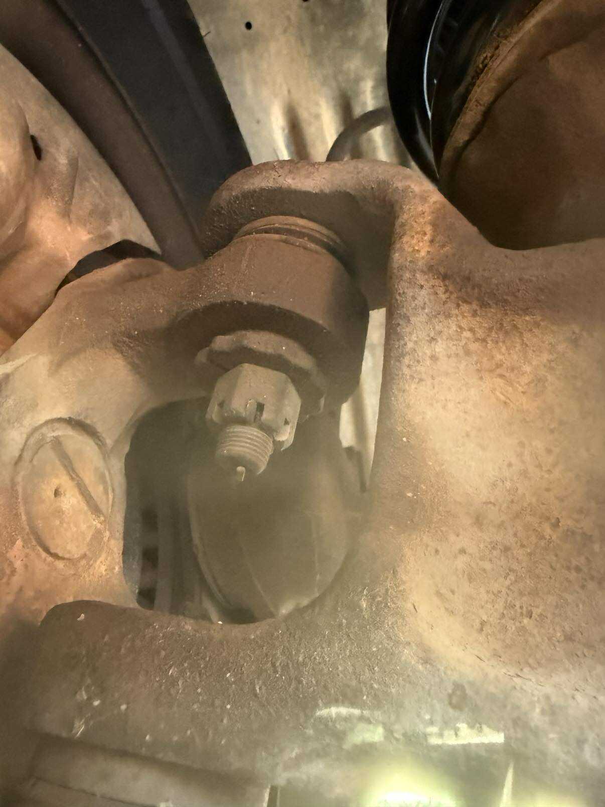

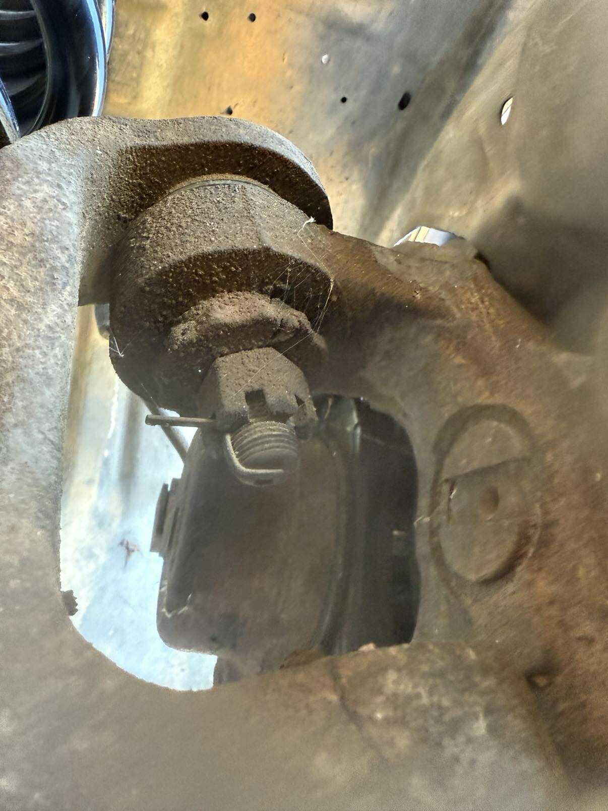

So I got to taking it part and I get how this is supposed to work but I am missing something. I can not get the bushing to move at all. I have up to an 1.5 wrench which doesn't fit and I dont see how to get a socket in there that will fit over the ball joint stud and get the ratchet in as well. Is there a special tool like the SPS wrench for their socket?

you will need to loosen the nut on the bottom ball joint. Drop it to the bottom of the threads, but dont take it off. Then smack the outside shell that holds them both with a hammer. Some knocker loose or rust ez may help. Or a ball joint remover. From there you can adjust it and drive it back up with a wrench. This is not going to be fun!
