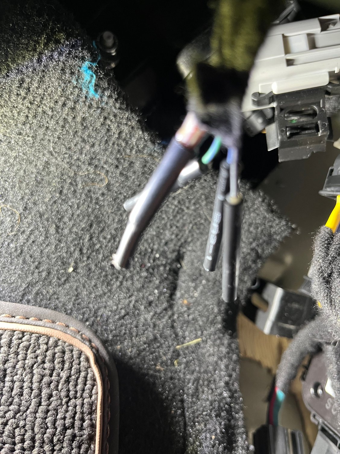

So after looking at the area again I found these 4 blunt cuts. They don’t look like the correct color codes but the one in the middle is thicker & seems to consist of multiple wires. Maybe the correct wires are in there. I’ll start taking them apart but I’m not very hopeful.

The wire in front not middle.

Those blunt cut wires look like pass through wires.
Should find the other end of those under or very near the relay box under the hood,

I thought they were pass thru wires too until I untaped them. Three are the wrong colors for pass thru wires & the fourth is actually a small bundle of wires none of which are the correct colors.
