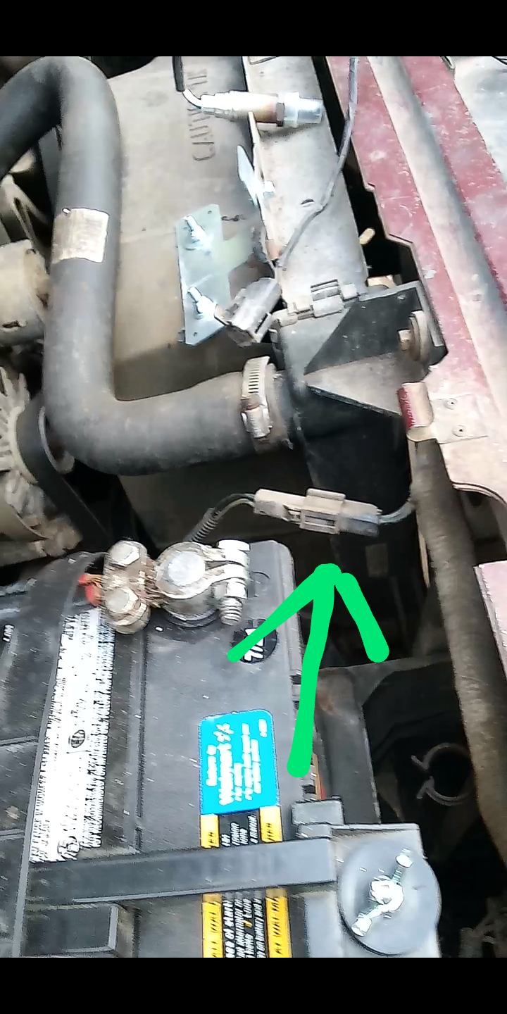

Without the truck up to temperature, you'll get codes like that.
Check out posts 6 and 7 at this thread Ground Points - Ford Truck Enthusiasts Forums https://www.ford-trucks.com/forums/1...nd-points.html
Your ground points will be slightly different, because your truck is an '87.
These two grounds need to be connected to the battery negative terminal. If you have this style of battery terminals, they could be the whole problem.
Disassemble, clean and reasonably tighten the grounds in the link I posted.
Don't underestimate the problems that the main ground cable can cause. It runs from the battery negative terminal to the engine block and frame. It can corrode internally and need replacement.
