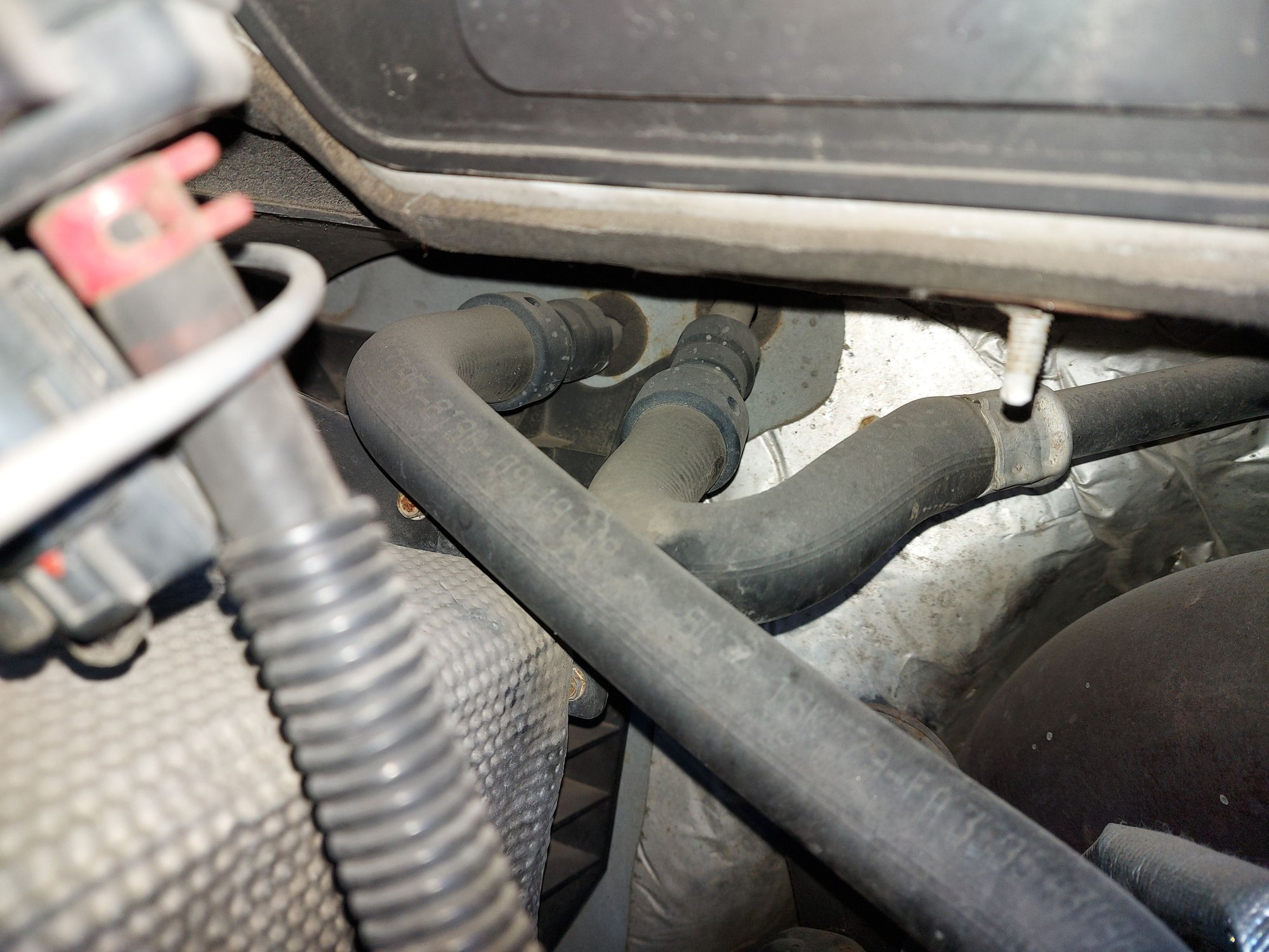

The hose on the left is from engine to heater core and hose on the right is heater core to other side of engine and that is the flow direction correct?

Yes.

I've uploaded a video showing you how to unlock the connection if you want to do that. If you don't know how it works, it can be frustrating.
The black part is attached to the hose and can then be pulled off. Grey part stays where it is..

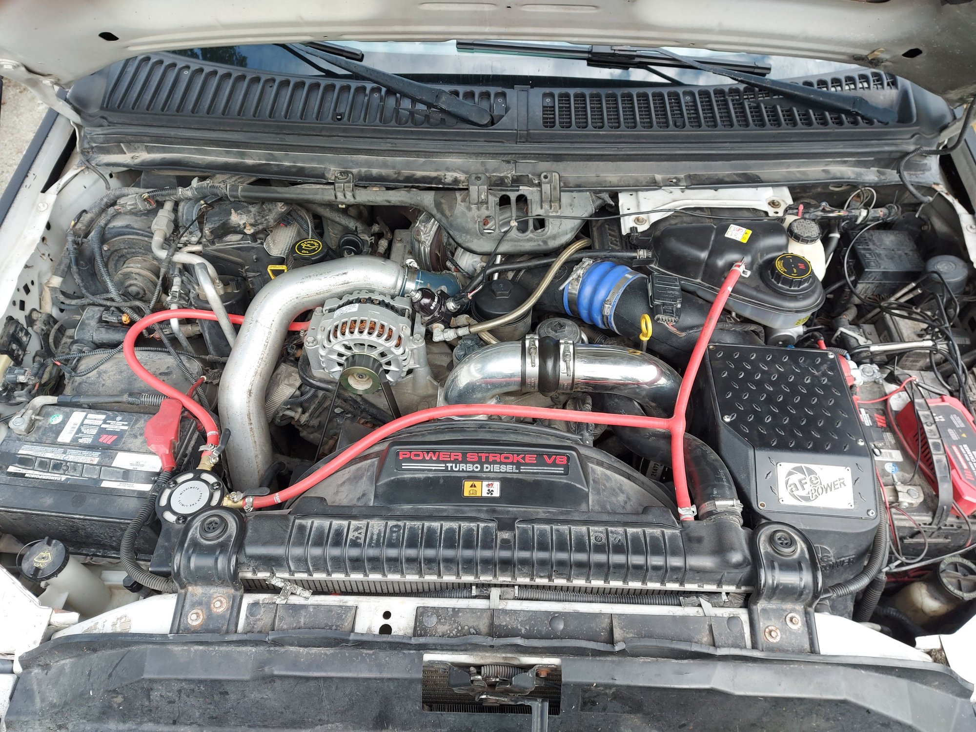

So which direction is the flow through the aftermarket spin-on coolant filter mounted by the passenger side battery? Is the flow toward or from the degas bottle?

Depends on how it is spliced in .... pictures would be helpful.
Mine for instance.

And in this case -

Thank you! That is exactly how mine is plumbed. I guess I didn’t realize there was any other way to plumb them because every one I’ve ever seen was just like that. . . and that’s how the directions say to do it.
It seemed like that should be the flow direction in my mind but the 3/8 hose from the degas to the top of the radiator was throwing me off. It seems like hot water should be flowing into the top of the radiator and out the bottom and since that little hose connects to the top. . . is it a return line?

It's a degas line that removes any air (gases) that could build up in the radiator, preventing coolant from being exposed to all the cooling fins. Many vehicles today have degassing paths. The other one we have is at the top of the intake manifold, so any gas bubbles from coolant boiling in the EGR cooler will be removed from the coolant path by going to the degas bottle.
