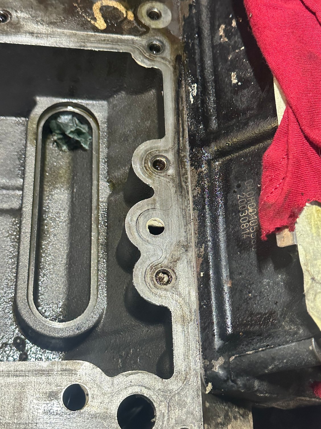

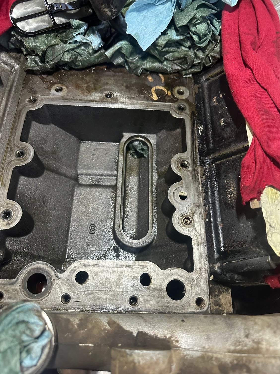

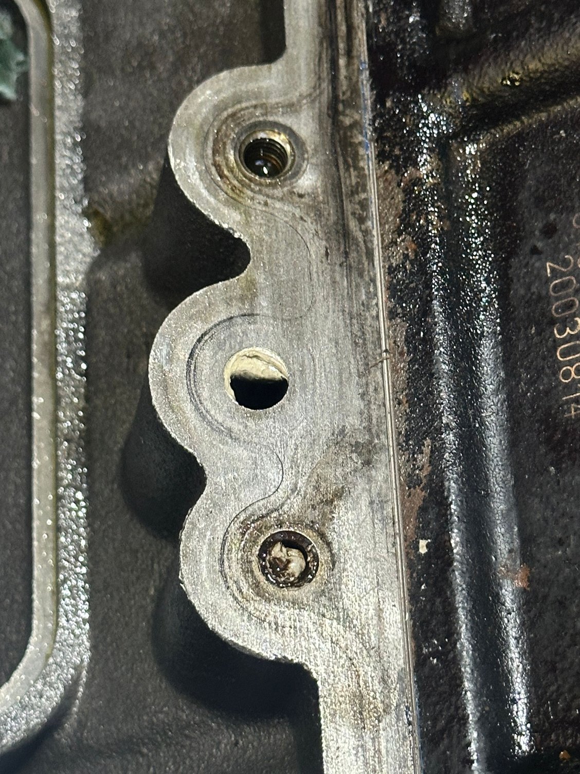

I decided to replace my oil cooler after seeing that my deltas were pretty extreme. While I was cleaning the valley up I noticed that two holes had some rtv in them, could this have caused such extreme deltas, or at least contributes to it? Coolant temp was at about 180 and oil temp was at around 240-245

I don't think so. One is a threaded bolt hole, the other is a drain hole that leads into the crankcase.
I doubt that it was completely clogged. Do not use liquid sealant ANYWHERE on the oil cooler.

Not sure how the whale snot ended up in the bolt holes, but it DOES need to be part of this project. Book says to put dabs of grey RTV (non-foaming) on the block-rear cover junction before seating the HPOP cover to seal that joint because the press-in seal in the cover won't extend down enough to seal completely.

Every place I had a cord gasket on this engine, I backed it up with TA-31, ON THE OUTSIDE OF THE CORD exposed to the exterior. And it wasn't much, just enough to prevent weeping, as you can see from the squish-out. You need to use common sense.
The cords that were wet on both sides did not get the sealer.

Well, I guess ill have to wait and see if it leaks or something. I cleaned it all up and didnt use any sealer when putting back together.

I don't think it's under any pressure under the HPOP cover, if it weeps it'll just be one more small part of the 6.0 Drip.
That drip has been riding my bellhousing cover for 180k miles and hasn't once hit the driveway
