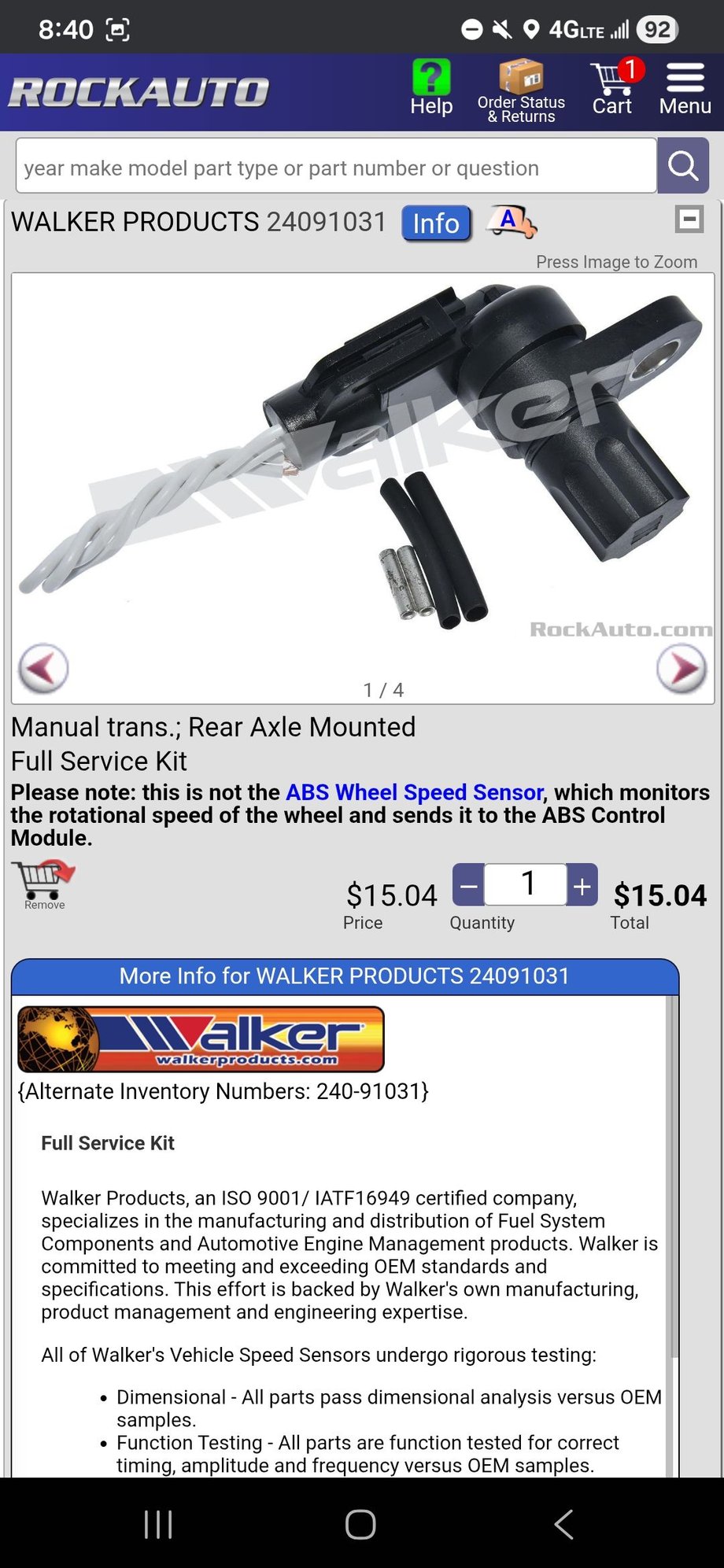

Hey all. So my 2001 Ford Ranger 2.5 2WD doesn't have a working speedometer. I know the gauge cluster and all the fuses are good, so im thinking its a bad connection at the pigtail when my stepfather rewired it. Any help on how i would go about rewiring it again when I get a new pigtail and sensor? Im kind of at a loss.

Automatic or manual. Looks like automatics use a transmission mounted speed sensor. If your ABS light is not on, that's a sign. Might even be that some 5 speeds use a tranmsission mounted sensor. Not sure, not clear.
Why was the "rewiring" done? Is it a new vehicle to you or new engine or new harness?
https://www.rockauto.com/en/catalog/...d+sensor,10634

its a 5 speed manual, and the rewiring is best a question for my stepfather when he was driving it back and forth to work. Im guessing he bought a pigtail and a sensor. I know the sensor is good since I JUST replaced it...

Unplug the sensor on the diff and see if the ABS light comes on when driving. If it does that's a good clue that the sensor output is correct. There's not much to the sensor, just a magnetic coil that generates a voltage when metal passes by. It doesn't have a power supply.
If nothing happens it might be that the tone ring in the diff is damaged. It has the metal teeth that the sensor is counting.
Might help if you could find out why your stepfather thought something needed fixing. Flying blind here... pawpaw's solving a wheel lockup problem, you're focused on the speedometer.
https://www.rockauto.com/en/catalog/...one+ring,10176
