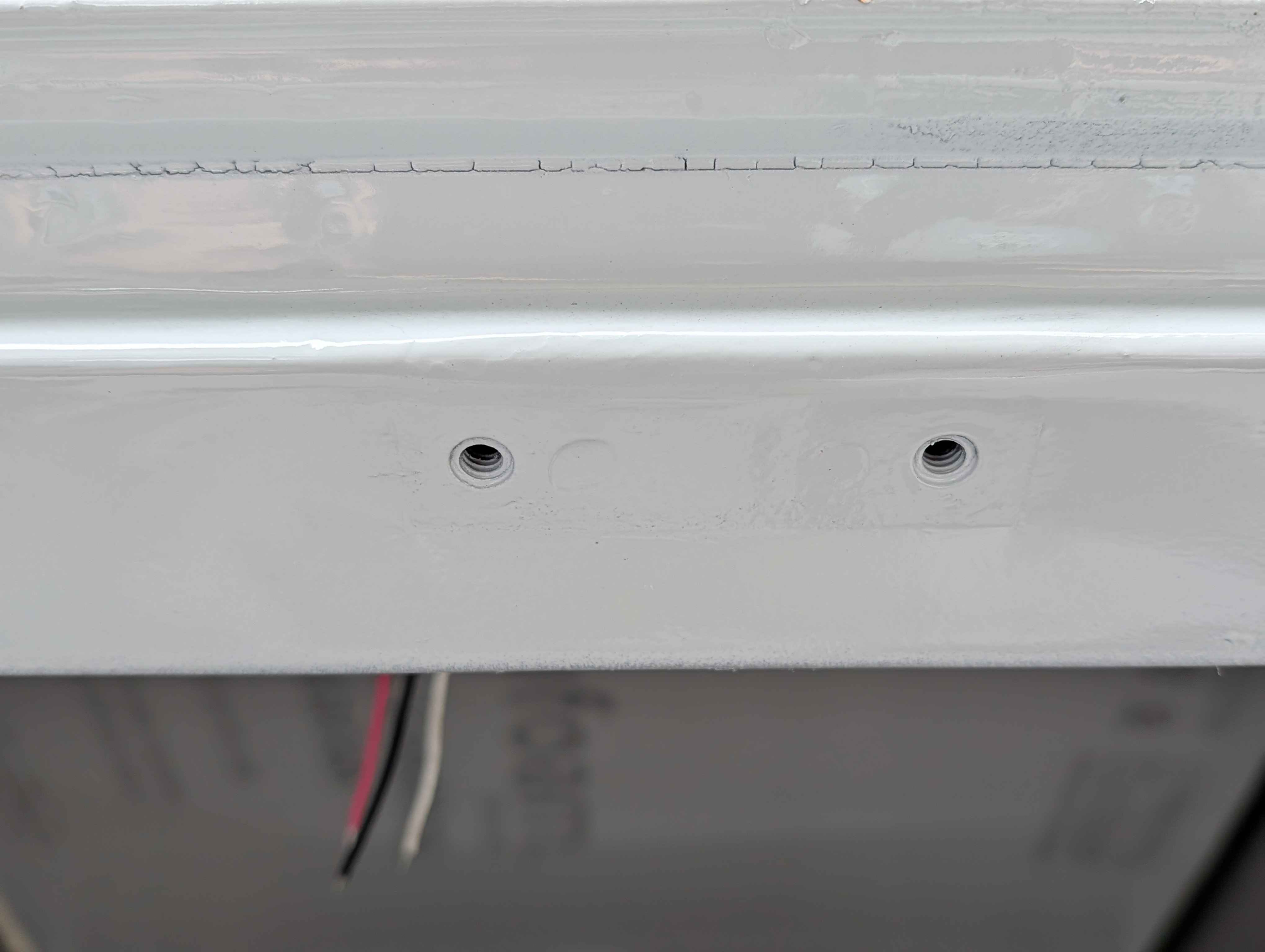

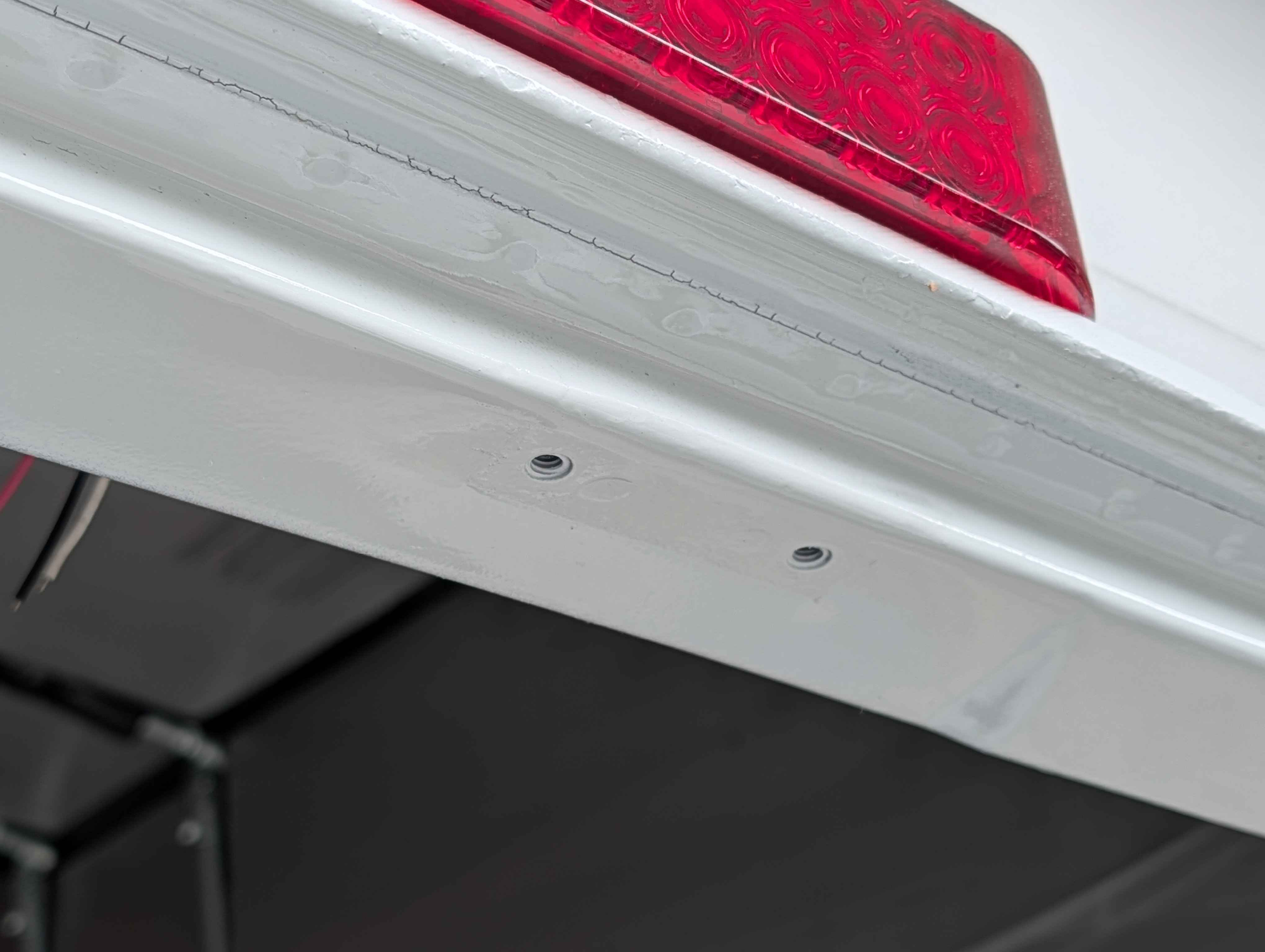

I don't think my van's ever had it, but it's definitely some sort of striker that goes here for the right cargo door. Can anyone help me figure out what it is, and better yet, if I can get a replacement? Thanks
*EDIT* This is for a 1991 e250, the 79-91 chassis.

I would agree, my '81 E150 had the upper read door striker there. It was a steel rod with two 90* bends with flattened ends to be mounted. I have no pic though, sorry.

If your picture shows the location I'm thinking of, other vans have a striker. I assume there's a corresponding working latch on the door. Maybe the striker was removed because the latch won't release.

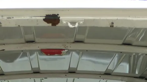

Our 2007 has a similar striker for the driver side rear door (no upper striker for the passenger side rear door) on a 3-3/16" screw base but the striker bar is angled to the passenger side. A welder should be able to angle it how you need it. Striker shown below between door switches.
