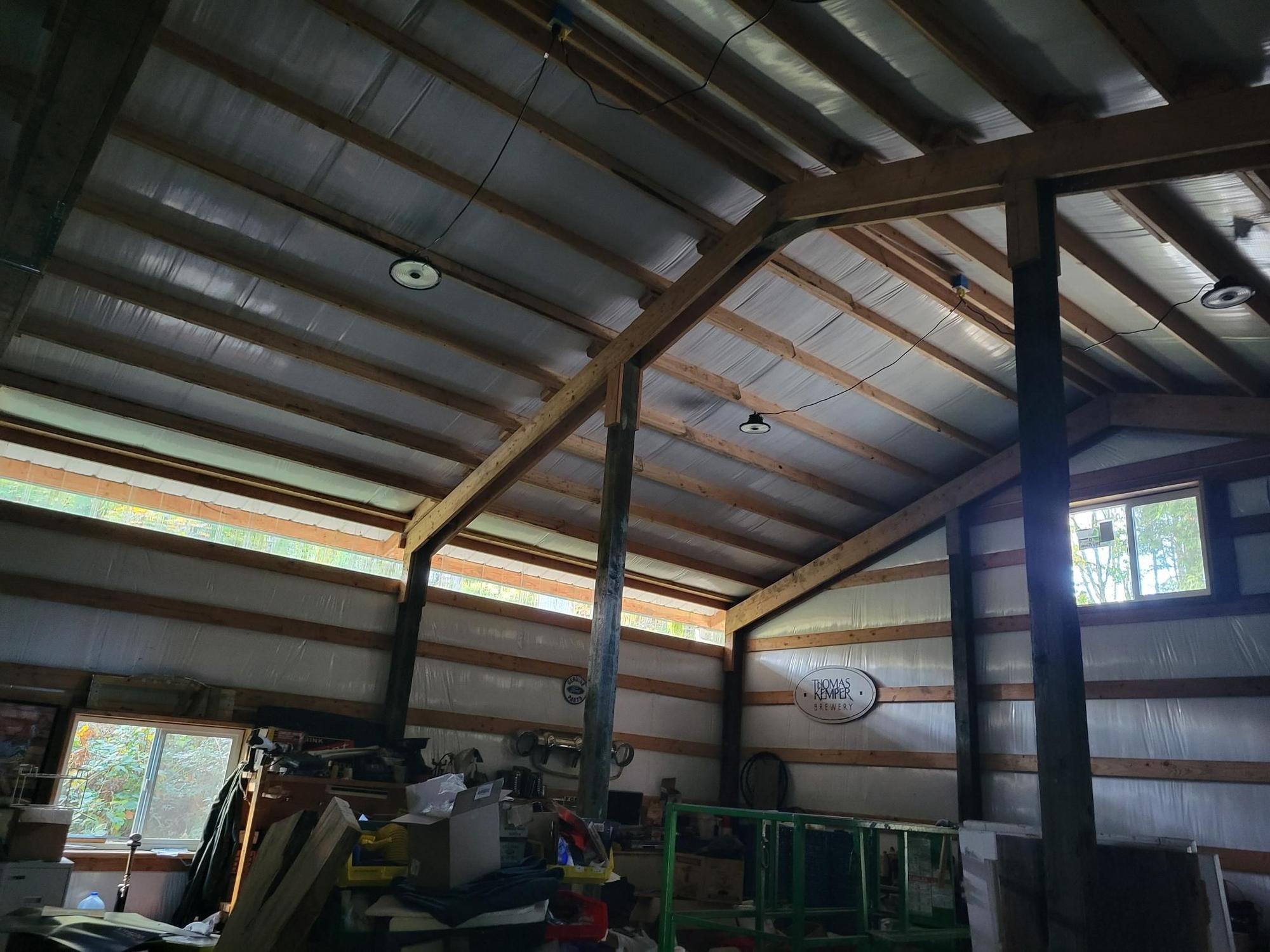

1. I did a 2' clear section at the top of the South wall. Lets in a lot of light especially before I had the electric service in.
2. Window high on the back wall where I plan to put a 14 x 20 (or 30) loft area.

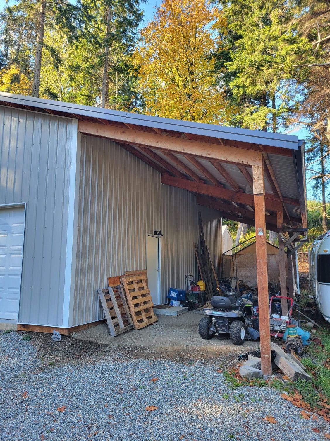

3. Another option that didn't add much cost was the 12 x 40 lean to area. Did this for the things that don't need to stay dry but want out of the direct weather. Firewood, mower etc. Added benefit of covering the Man Door area!

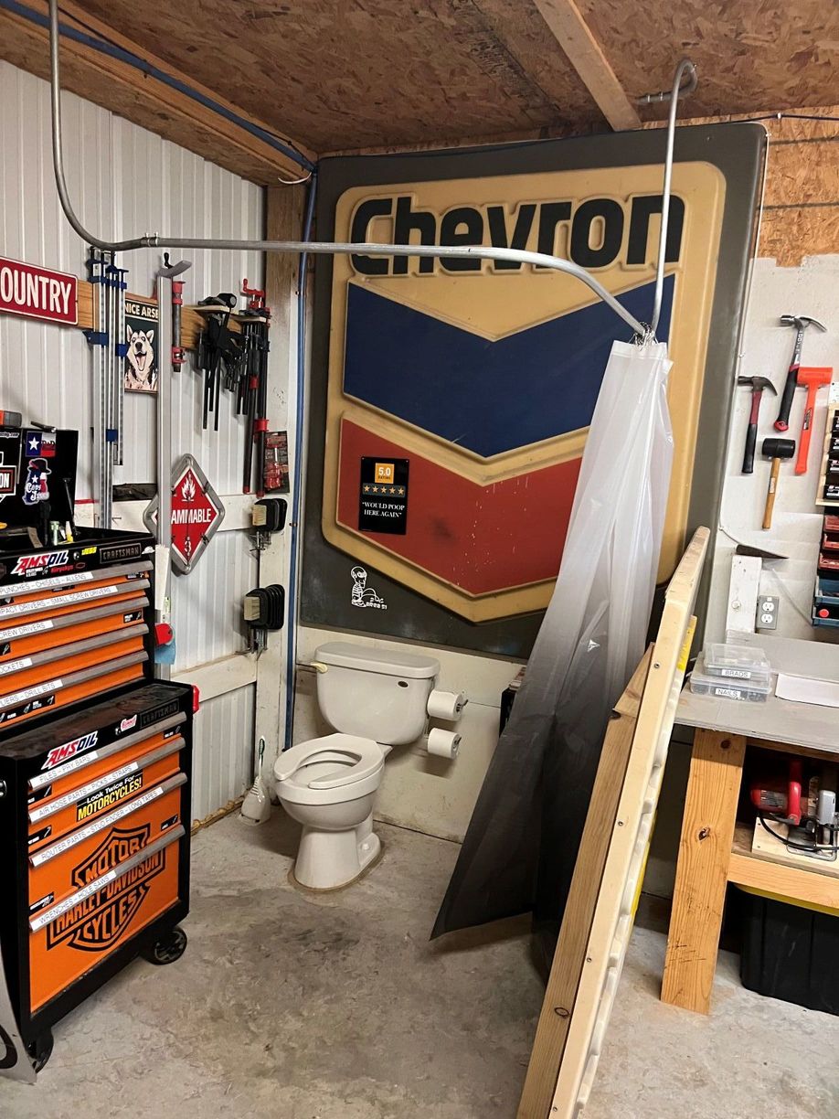

Everything I have in my shop I am so glad I put in a toilet and sink. My wife asked for the shower curtain, never bothered me...
