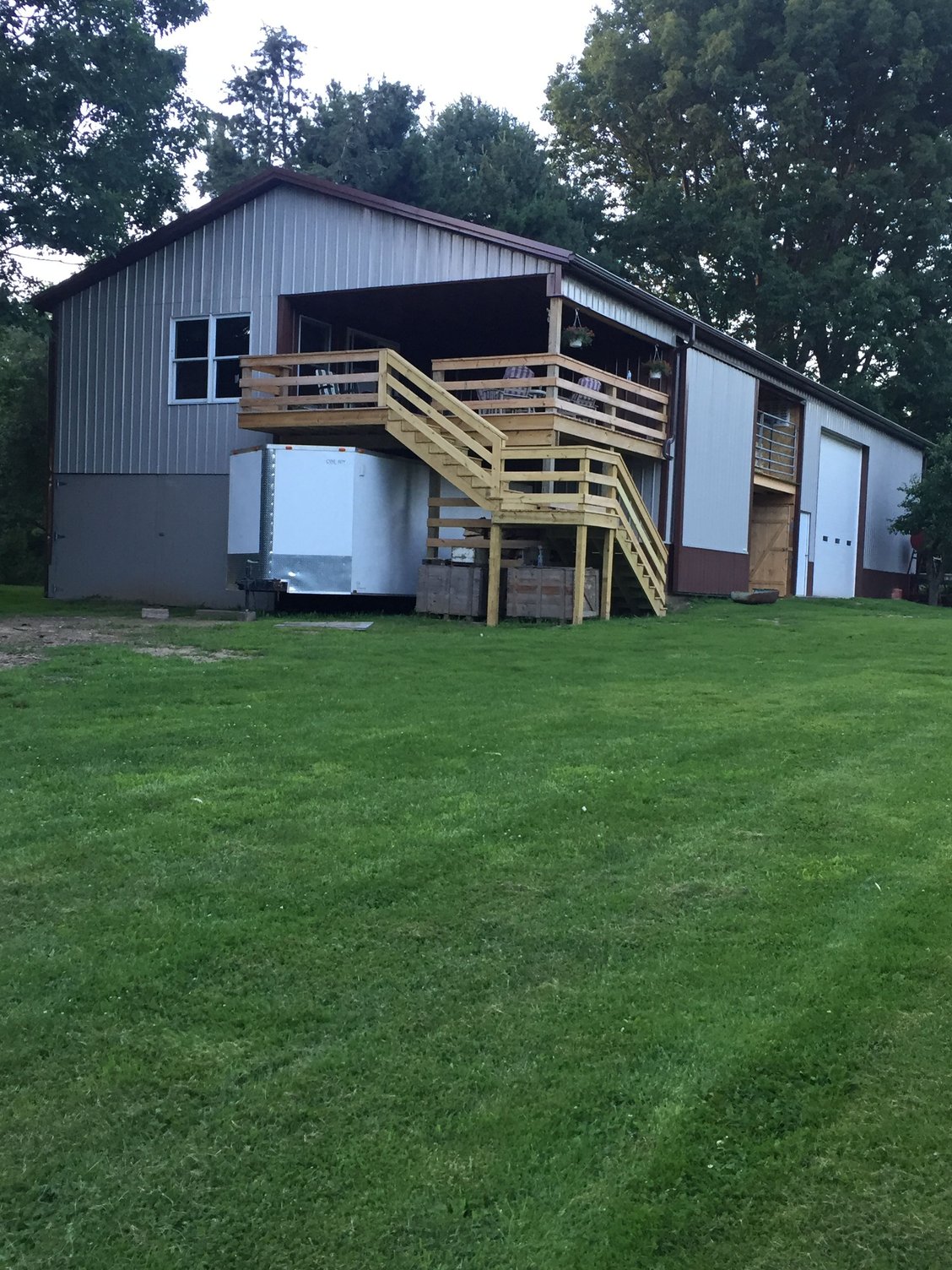

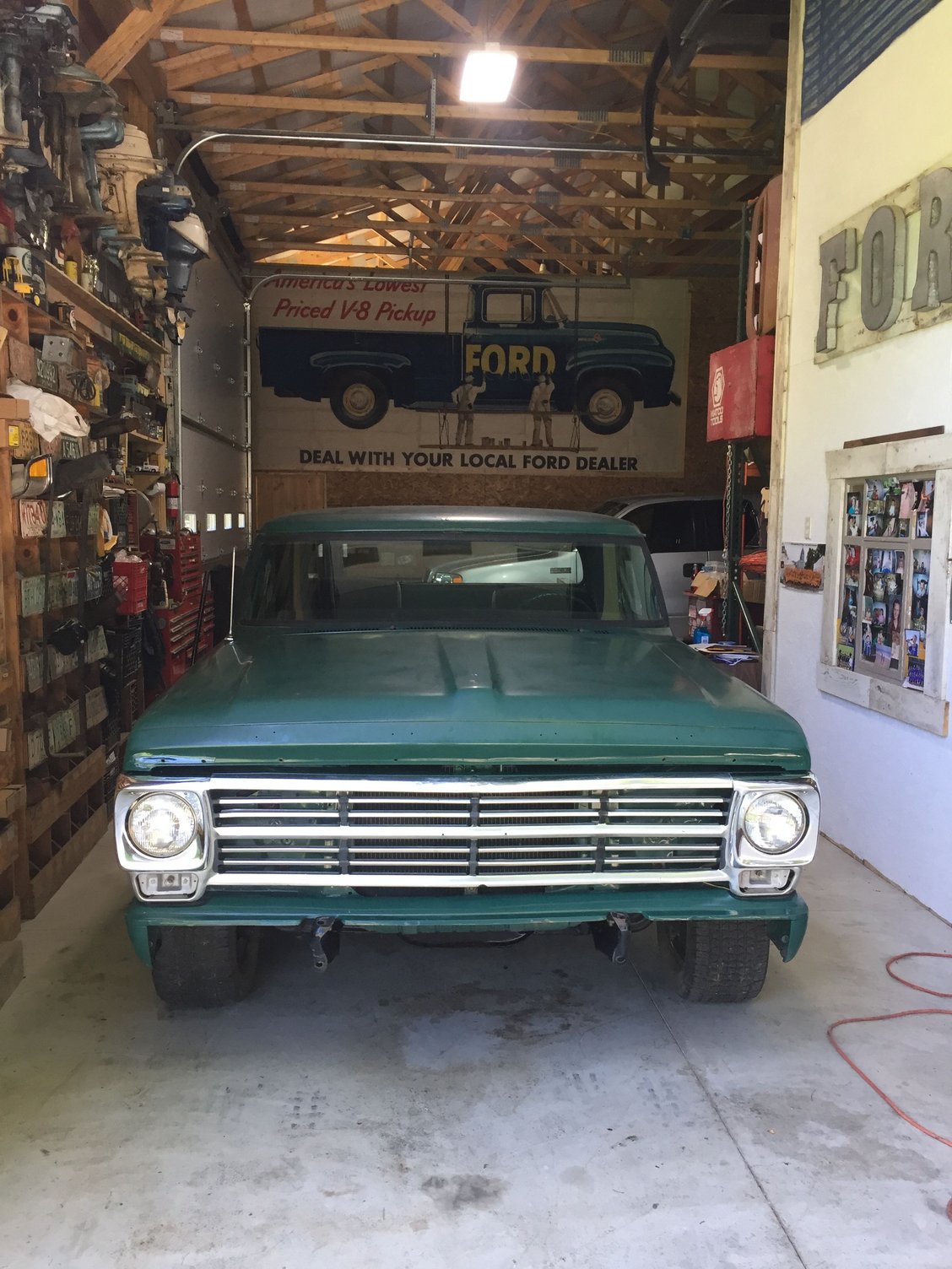

couple pics of my shop

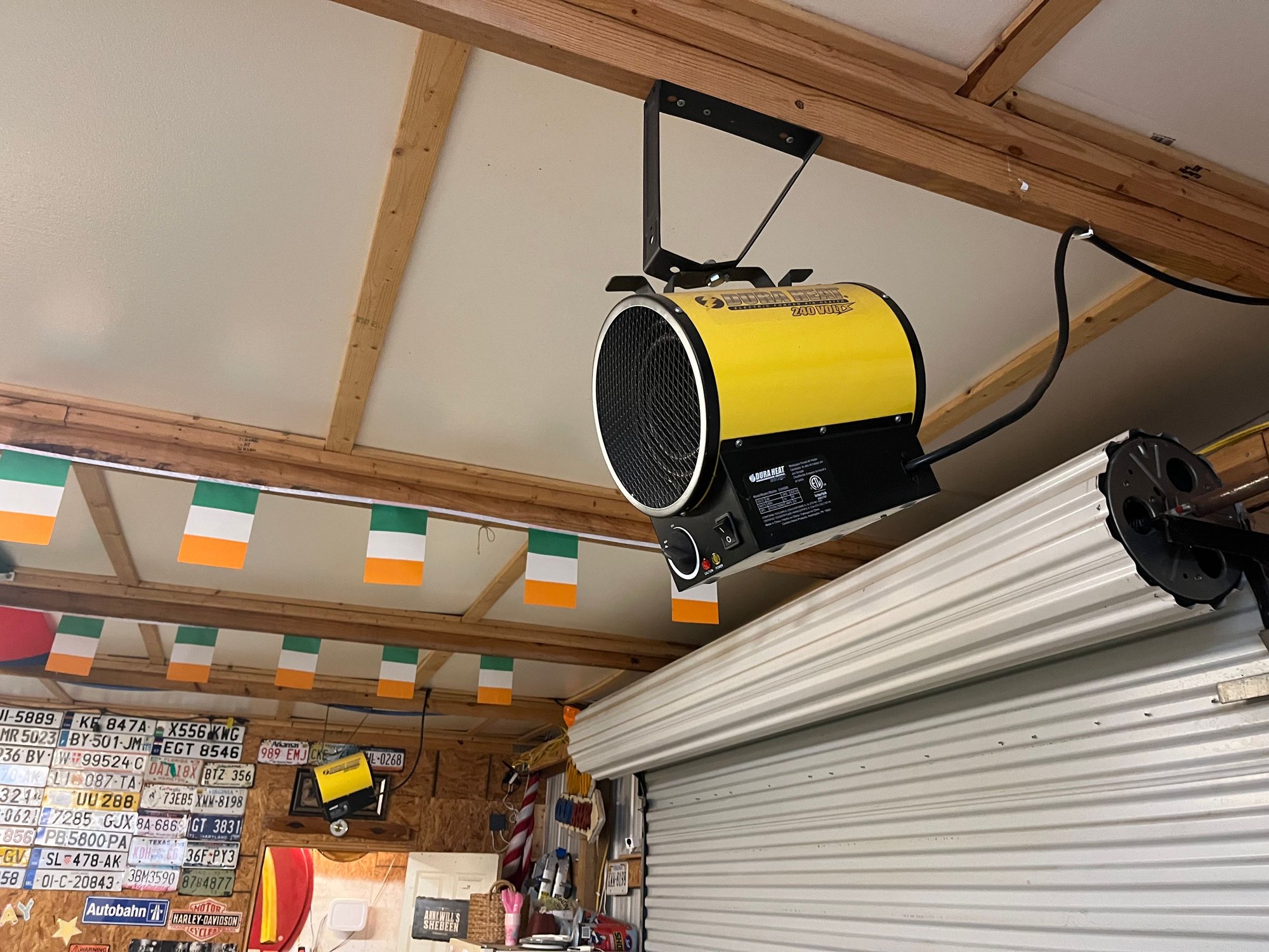

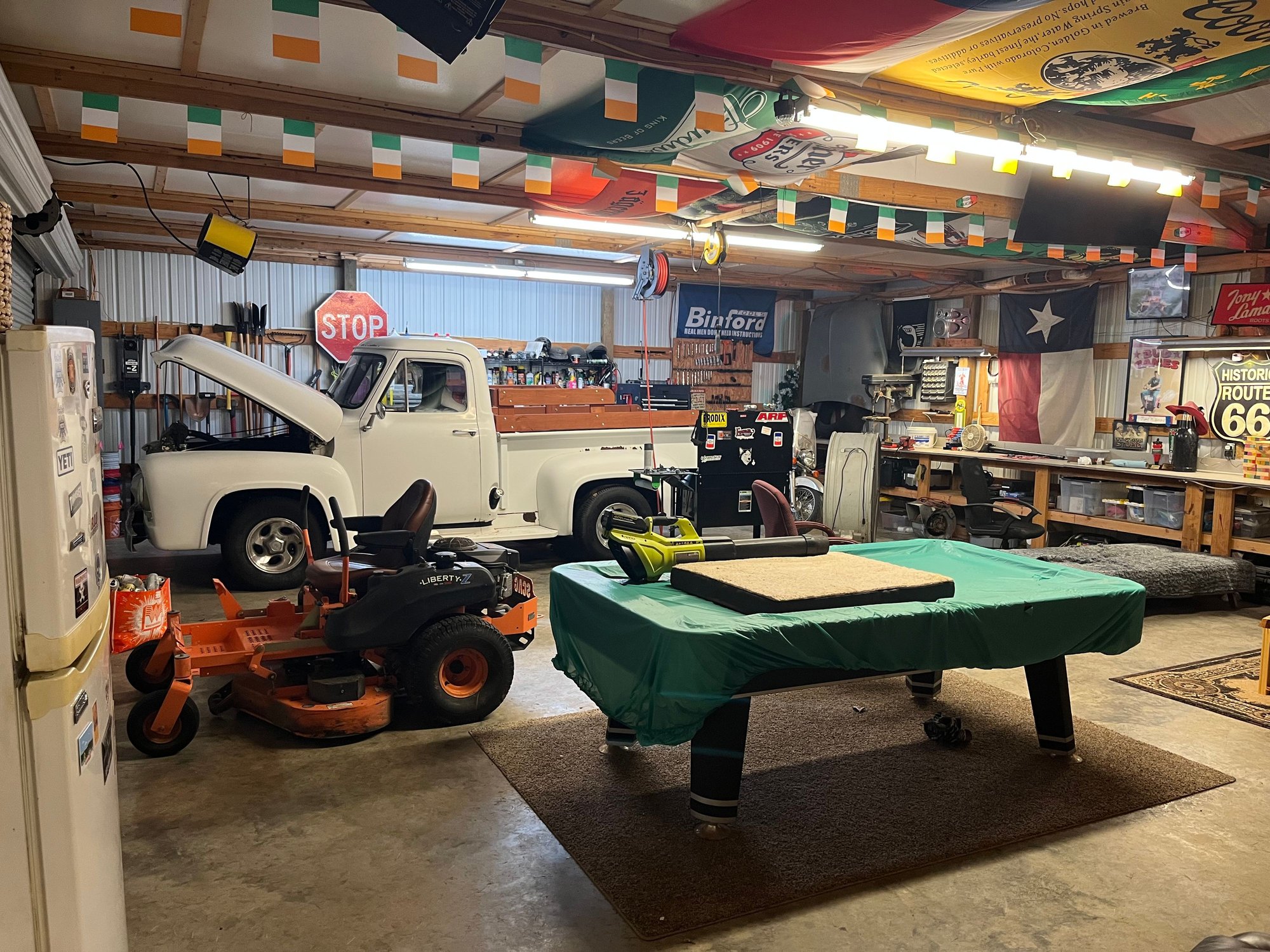

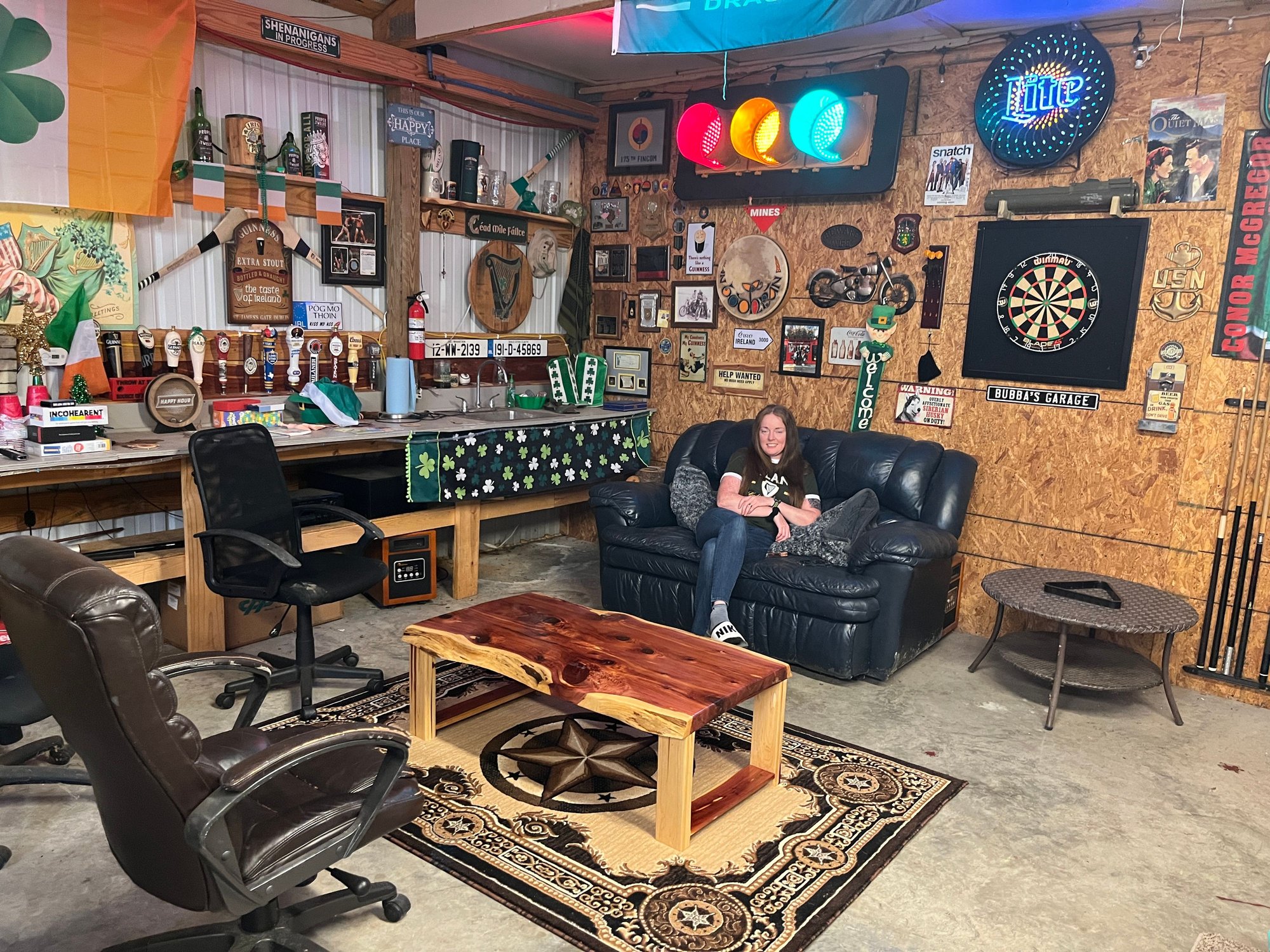

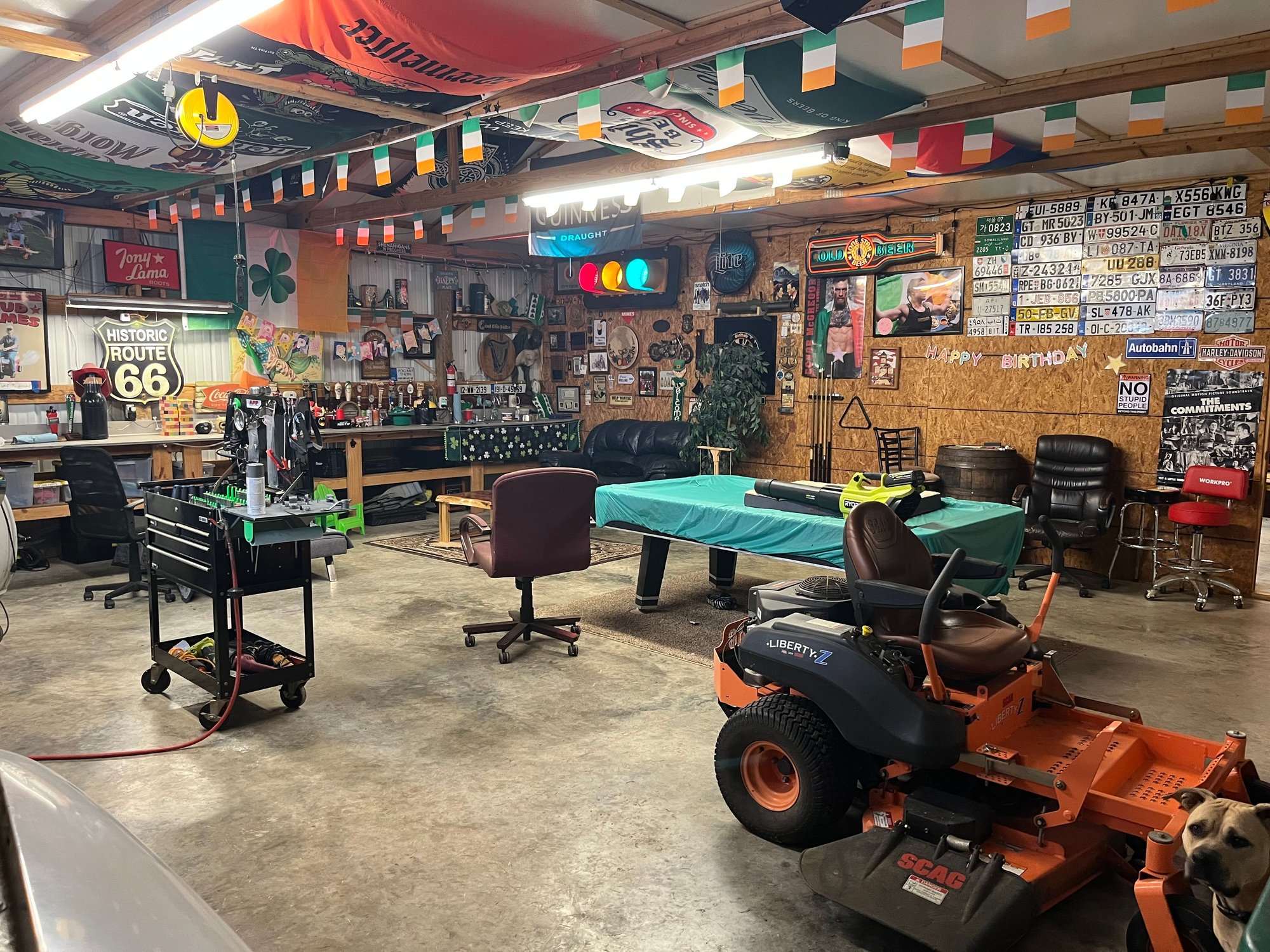

I did a 30’X50’ and wish I could have gone bigger but my neighbors property line stopped me, jerk. I have already out grown it.
I would plumb the toilet, sink. and water before the concrete is poured. It is easier to cover the small holes for now than break concrete later.
My plan was a 2 bay for my truck and parts, wife took over a 1/3 for a pool table, couch, basically a pub. I also did a wood / paint room for other projects and parts restoration.
I am in East Texas so it is not too bad but I put in two heaters and a foam drop ceiling. It gets warm enough to do some work and no open flames.
Also think about WiFi, helps a lot when you need to use Google in a metal building as well as adding security cameras.

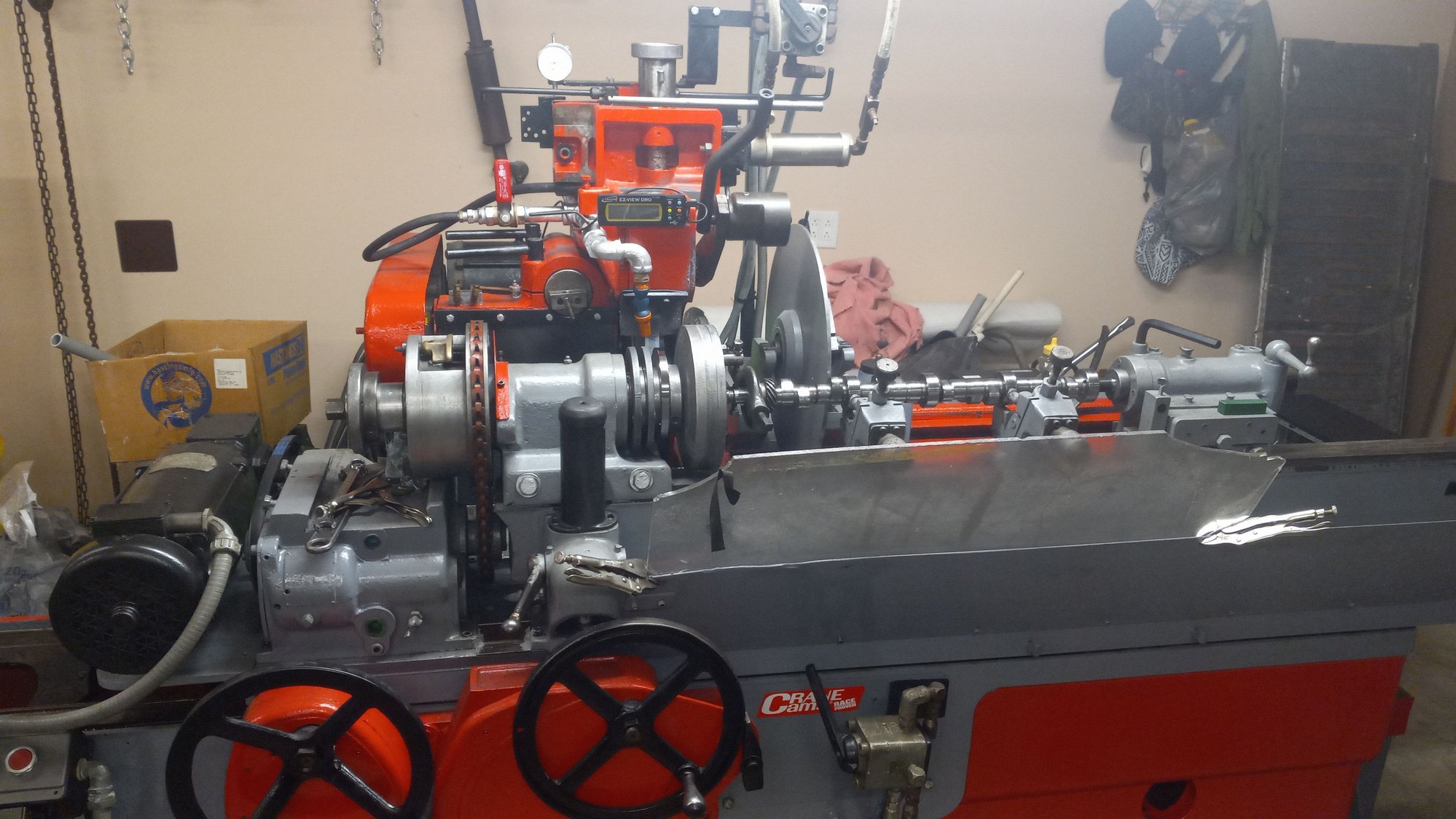

Also later when I added a phase converter to run my honing machine, cam grinder etc I put in another 100 amp branch panel at the rear of the building. To do that I just pulled the old wired out from the nearest home run and pulled in what I needed for a feeder, very handy.[/QUOTE]
You have a cam grinder!! I drove a 1200 mile round trip from Maine to Buffalo NY (actually North Tonawanda) to duplicate the grind on an early and not available antique camshaft. I could not recover if the 2 camshafts got lost in shipping. I pre arranged to drive straight, create a master from the grind on the borrowed cam and duplicate the grind onto my cam and drive back the next day.

Yes I have a cam grinder, a Van Norman 253:
I bought the grinder about 3 years ago. It came from Crane Cams. Crane went out of business in 2009 and it sat neglected after that. When I got it it looked terrible but I rebuilt the whole thing and it grinds really nice. Crane had done some modifications to their Van Normans over the years, my machine has a variable speed DC drive for the work piece and hydraulics for the rapid in and out and the dresser.
In this picture I'm making a master from a Ford roller cam. The masters are a big thing when it comes to cam grinding. I have about 200 now, some are new designs that I had made and some are copied from existing cams.
