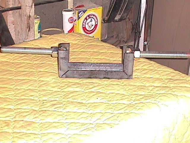

thanks ,but we have that style, they work great on A's and 35 up ,not so well on 32 though 34's that have a very odd arch shaped spring that bends forward around the rear housing, .which puts the shackle ends about 3 inches forward , of the rear cross member, would be no problem if the customer would let us use a 4 link coil over, but NO stock but lowered transverse spring with a quick change rear
guess I'm going to be digging out the mig and making something that wraps around the rear, like this person did

1934 .model 40 5 window sedan , that home made one should work as it wraps around the back of the rear . making it now will also help with the 32, 3 window we just got to do a mechanical restoration on, YES a unmolested v8 32 3 window rumble
