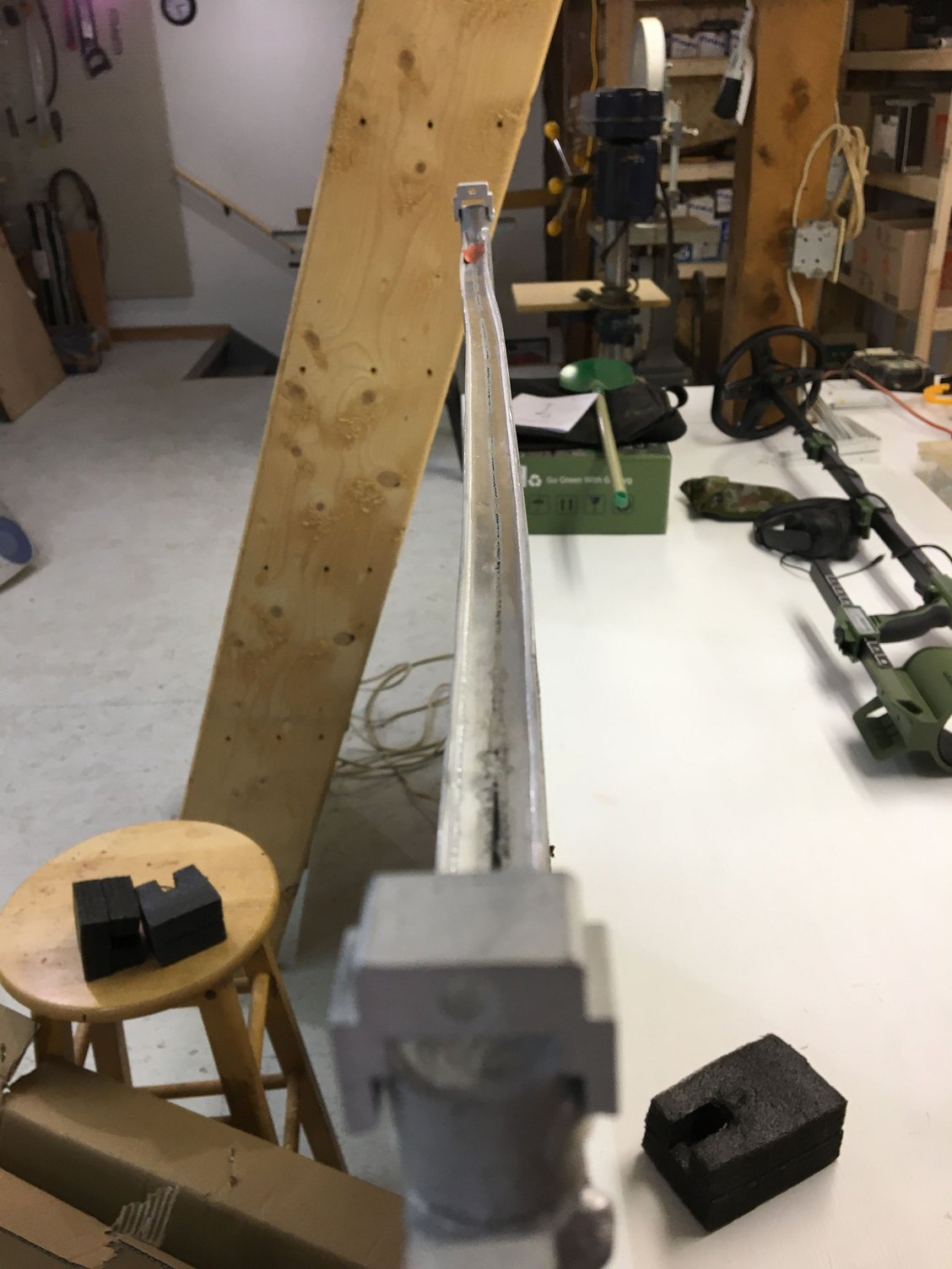

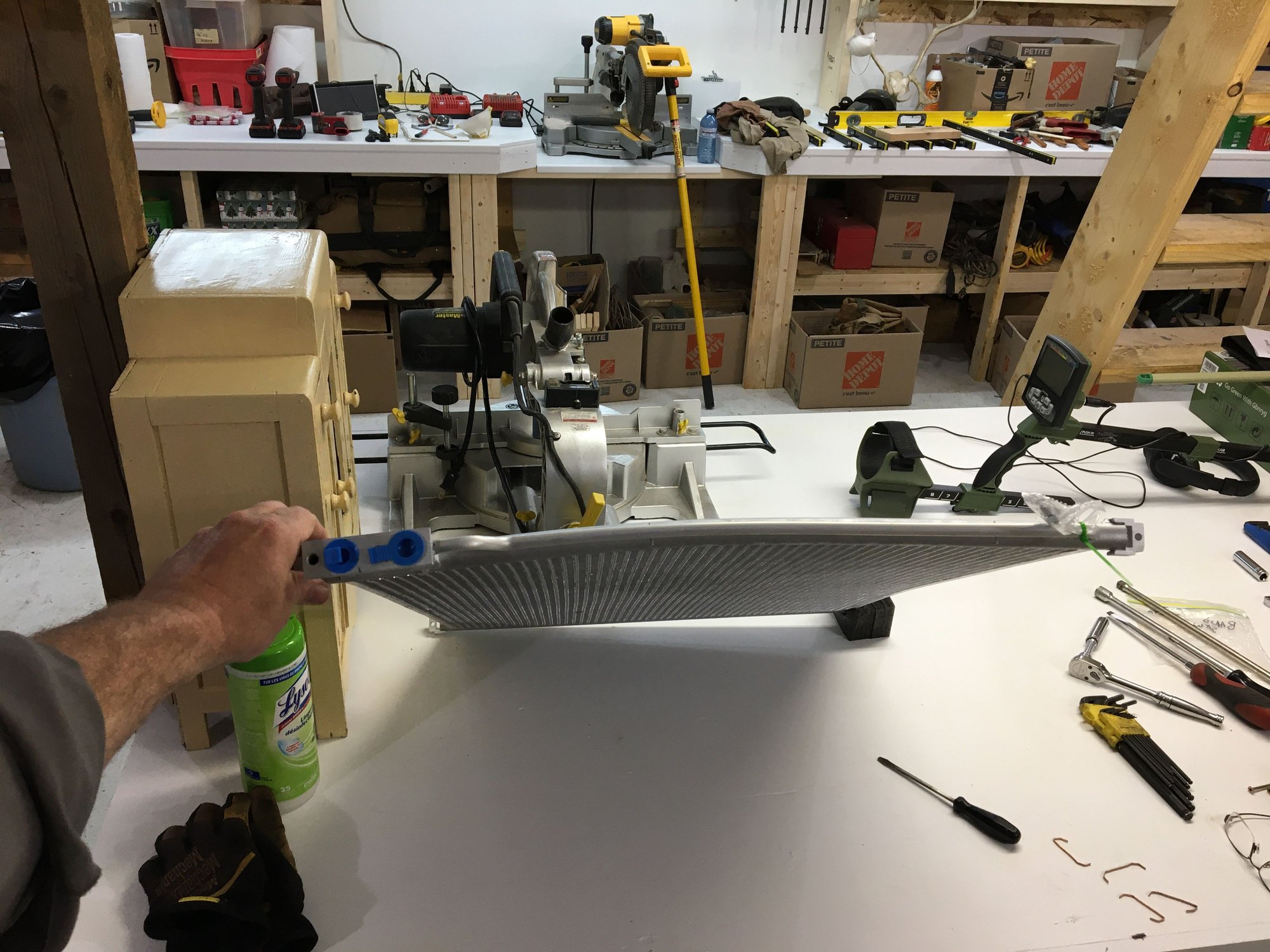

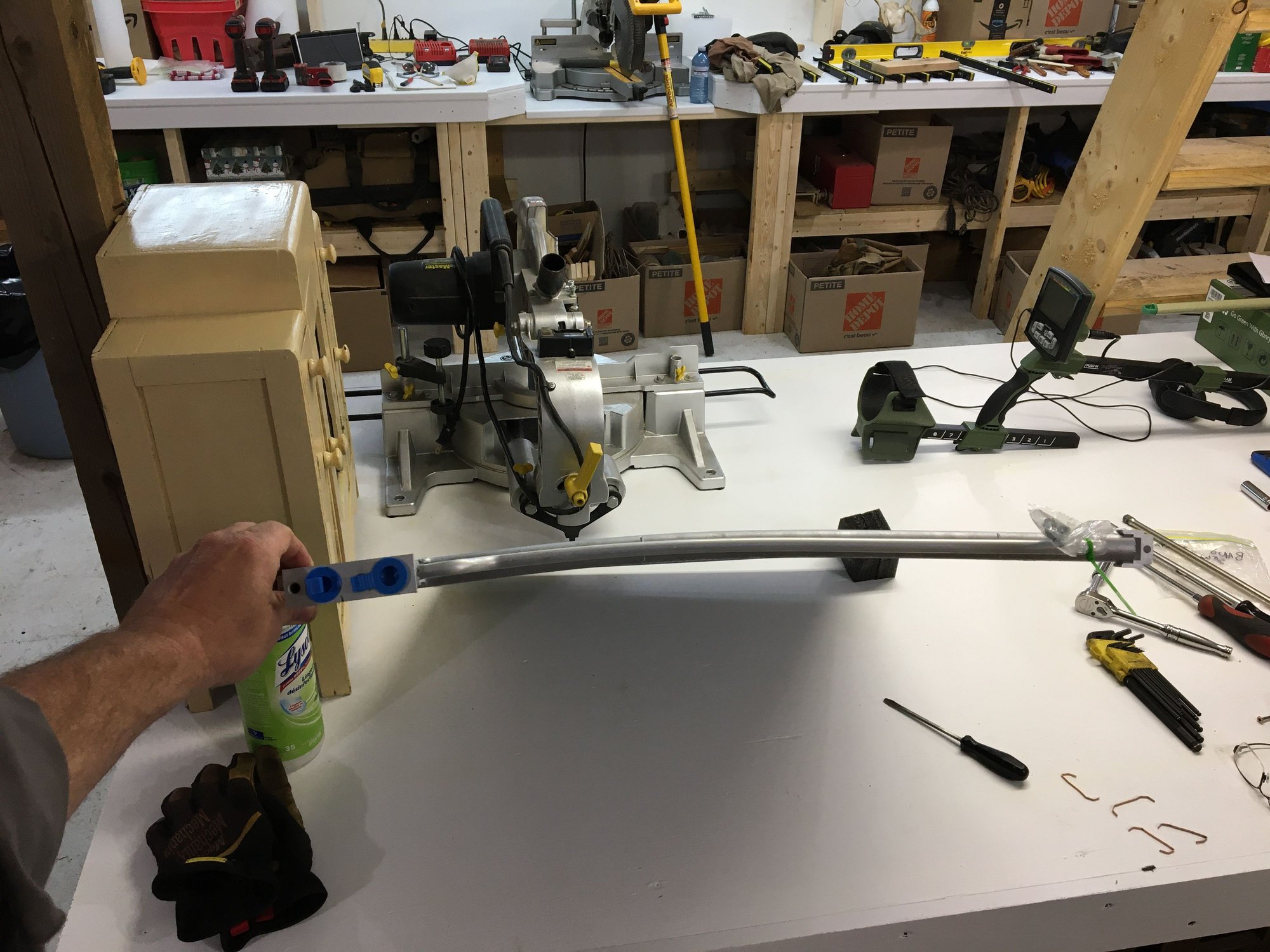

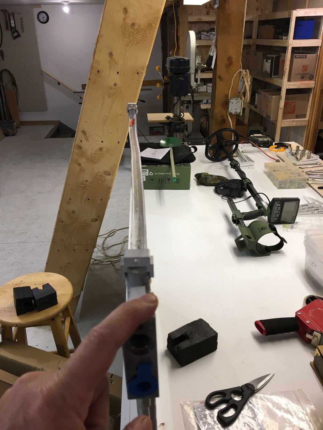

Pics.
Sepctra. First or Second one - lost track of the pics. First and second were bowed or warped. Looked like poor assembly as well.
Third try. Bowed so bad, I’m not sure it would even fit.. Agan, the shipping box was in good shape.
