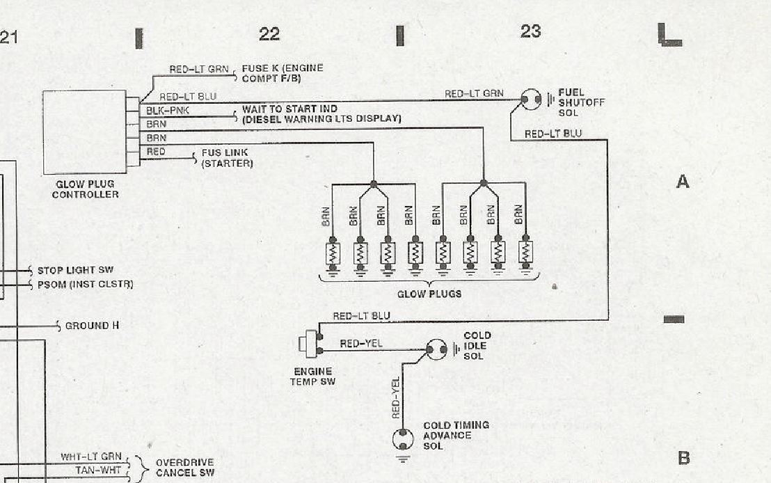

Hello! New to the forum, hoping to get some help on my 1993 f250 7.3 turbo truck. Here is the issue.
bought the truck with a bad glow plug relay. Installed a new one, however I can not get it to work!
the guy before me used a button with one wire that I would touch to the back left terminal on the relay, and the other wire to the body to ground and it works great. However with the new relay hooked up properly, nothing.
any help would be appreciated

Ohm out the ground wire or supply direct ground to controller. Check fuse K in the power distribution box. Check the fuse link, probably at the fender mounted starter solenoid.

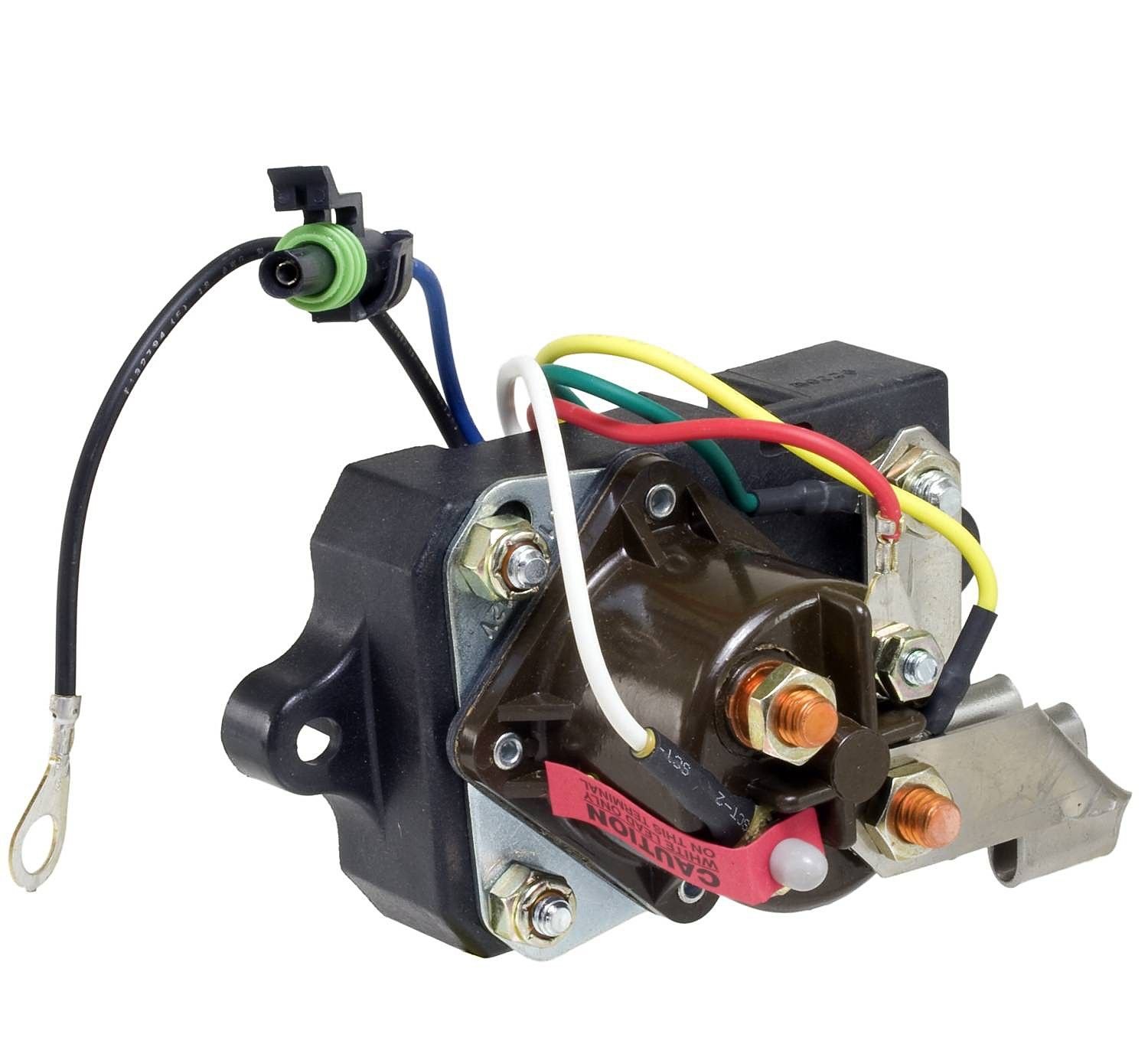

Didn't the later 7.3l trucks use a relay & controller in one?
Yes, but a lot of people, myself included, switched to a manual GP setup. The white wire in that picture is removed and taped over. A new wire runs from a switch in the dash to take the place of that white wire and the switch is grounded to complete the circuit and activate the plugs. I suspect the OP has a problem with his ground or something simple like that. I recently upgrade to the monster White-Rodgers/Stancor glow plug relay, https://dieselorings.com/products/16...low-plug-relay
It's a big-*** relay.
