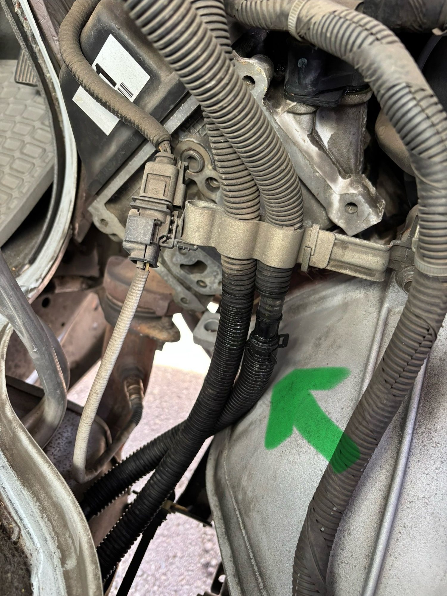

Hi,
I have a bit of a coolant leak. I think the culprit is this hose(on the right). Does anyone know what part this is?

My dictionary says hose A quick fix is to the cut the brittle rubber end and hope there's enough slack to reconnect the hose. The 16 year old plastic connector might be failing as well or will disintegrate when you touch it. I don't have a parts diagram but the plastic connector is probably something in this list - https://www.fordpartsgiant.com/parts...ter_hoses.html - or this list - https://shop.advanceautoparts.com/fi...-hose-fittings . Depending on what you find, consider replacing the connector with a brass fitting for longevity.
The picture isn't clear to me - is the spring clamp directly over rubber hose or is it over the spiral loom as well?

Upon close inspection, the coolant seems to be cascading down from somewhere above. I don’t want to jump to conclusions again but this looks like a more extensive job.
I had it parked for a couple days and now I can see there’s a steady drip. I can’t yet identify where. Doesn’t look good

Looking at the picture more closely it appears you have a leaking intake manifold gasket or cracked intake.

^Yes. I think you are right. I can see coolant pooling on top of the engine block beneath the intake manifold on that driver’s side, as well.

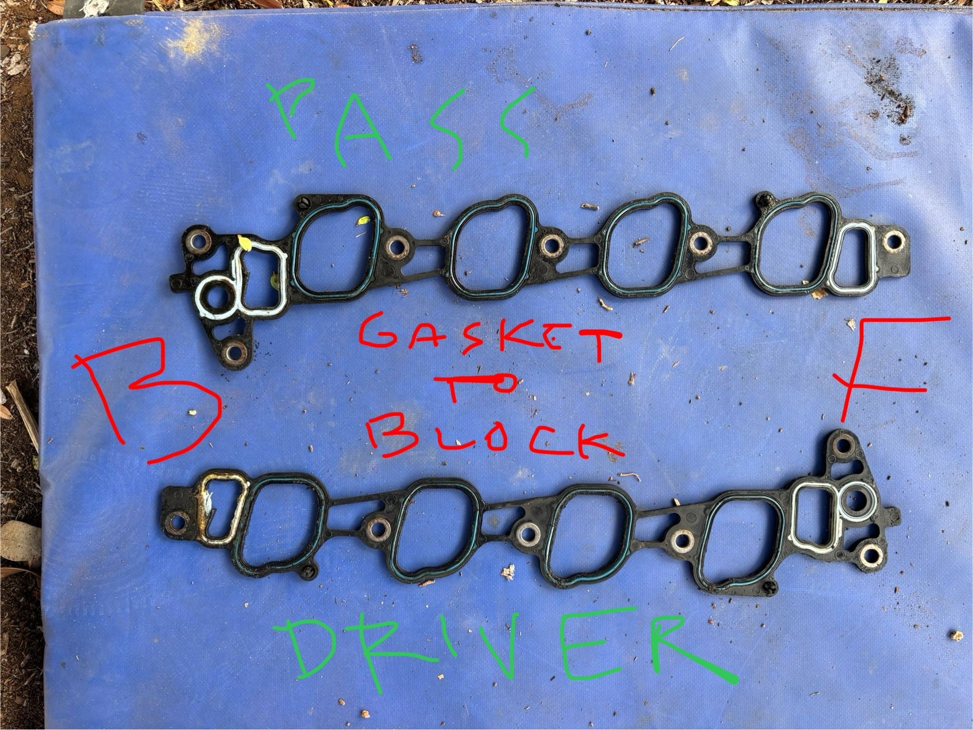

Post a picture of the gaskets
Sometimes you can see where it was leaking from looking at the gaskets
Post a picture of the underside of the intake

Old Oct 26, 2025 | 09:20 PM

See how the ledges are broken / worn down /cracked on the intake where the cooling port O-rings go?
Pull those O-rings out and take a closer look
Looks like to me you will need to replace the intake manifold to fix the coolant leak
