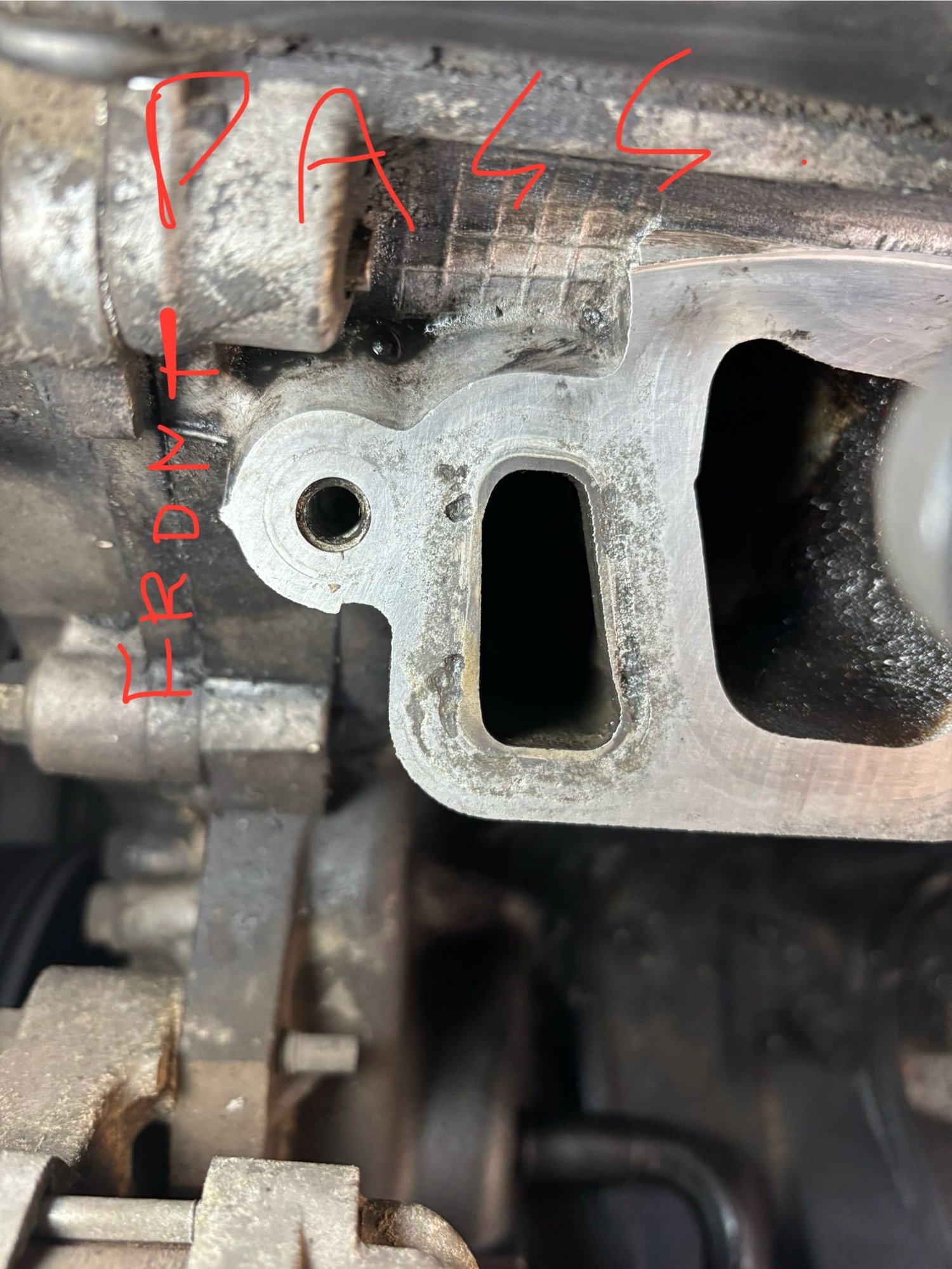

I’m cleaning things up in there. I see some pitting on the block, just passenger side around coolant port. How do I address this?

I think that's the head, not the block.
Things to consider though I'm neither a metallurgist nor machinist - I think you can TIG weld aluminum to build up the pit then file it level and smooth. JB Weld might be good enough if the pits are small. Long term, change the coolant more frequently.

Thank you. Yes, I mean the cylinder head.
I don’t see welding in my future here. I can prob do the JB weld route, and I do have a fresh extreme high temp JB on hand. I’ll probably go ahead and try it.

Use some gasket adhesive in that spot
I go around the coolant ports with the adhesive and anywhere else there is pitting

JB welded the pits on the cylinder heads. As it was curing, I thought I’d tackle the spark plugs. Long story short, they all came out fine with one exception. Plug #? (Passenger side, second from the back). This one, I believe, is spinning but will not come out. Not sure what to do next.

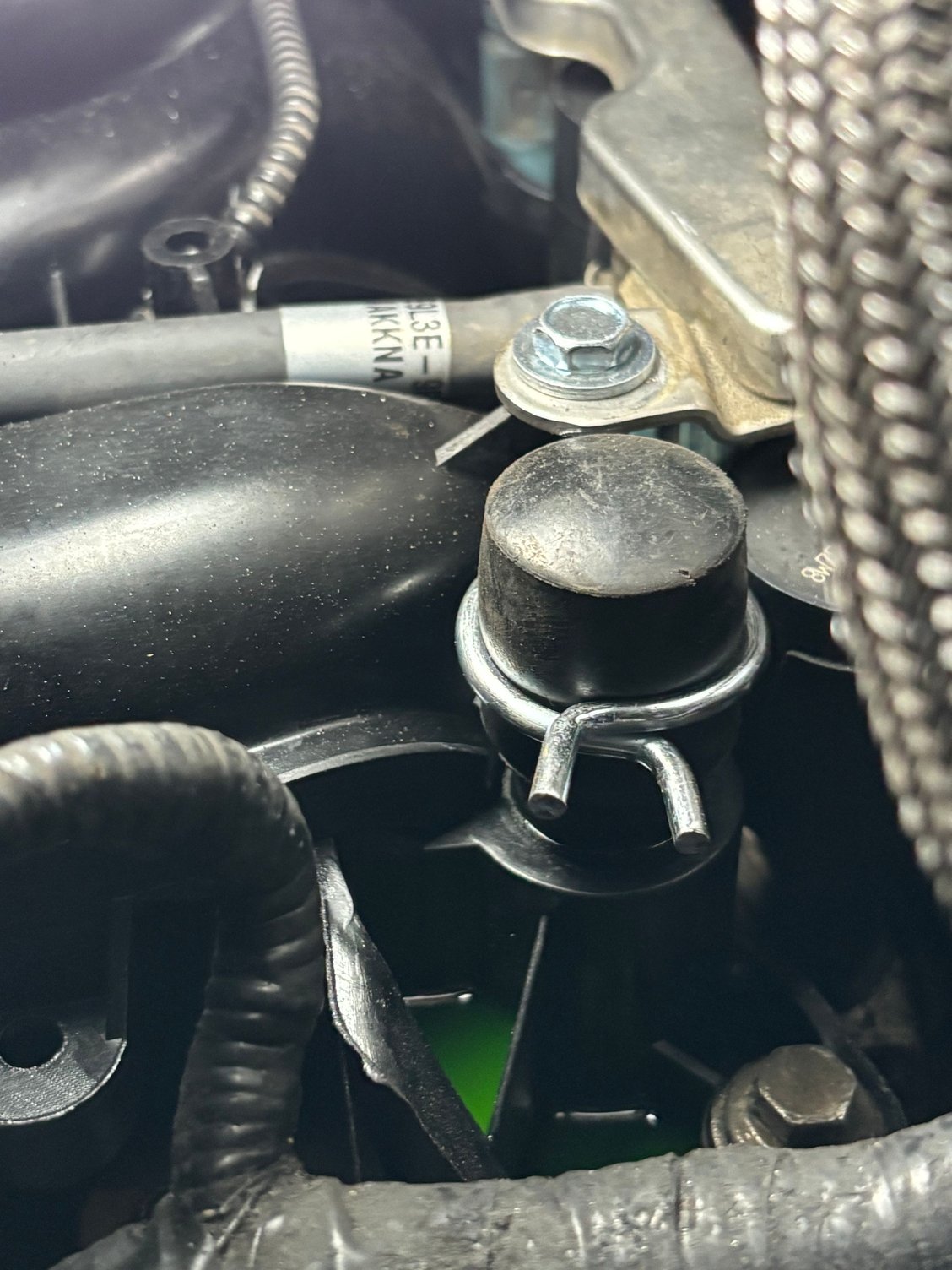

This is the passenger rear of the intake manifold. The unit came with this capped coolant port. After an extensive test drive, I noticed this leak. I admit that I had to twist the clamp to clear the top of the COP. I should’ve been more careful.
This doesn't look like a great way to put a part together, but too late to change it. It’s got to work under most circumstances, I assume, since Dorman is making them that way.
I’ve seen some clever solutions to fortify this cap/clamp situation. That’ll be my next step.
Also, I’m not sure if it is running a bit hotter than before. Only judging by the dash meter, and it looks up a tick. How can I get a more accurate temperature reading and what should it be, ideally?
