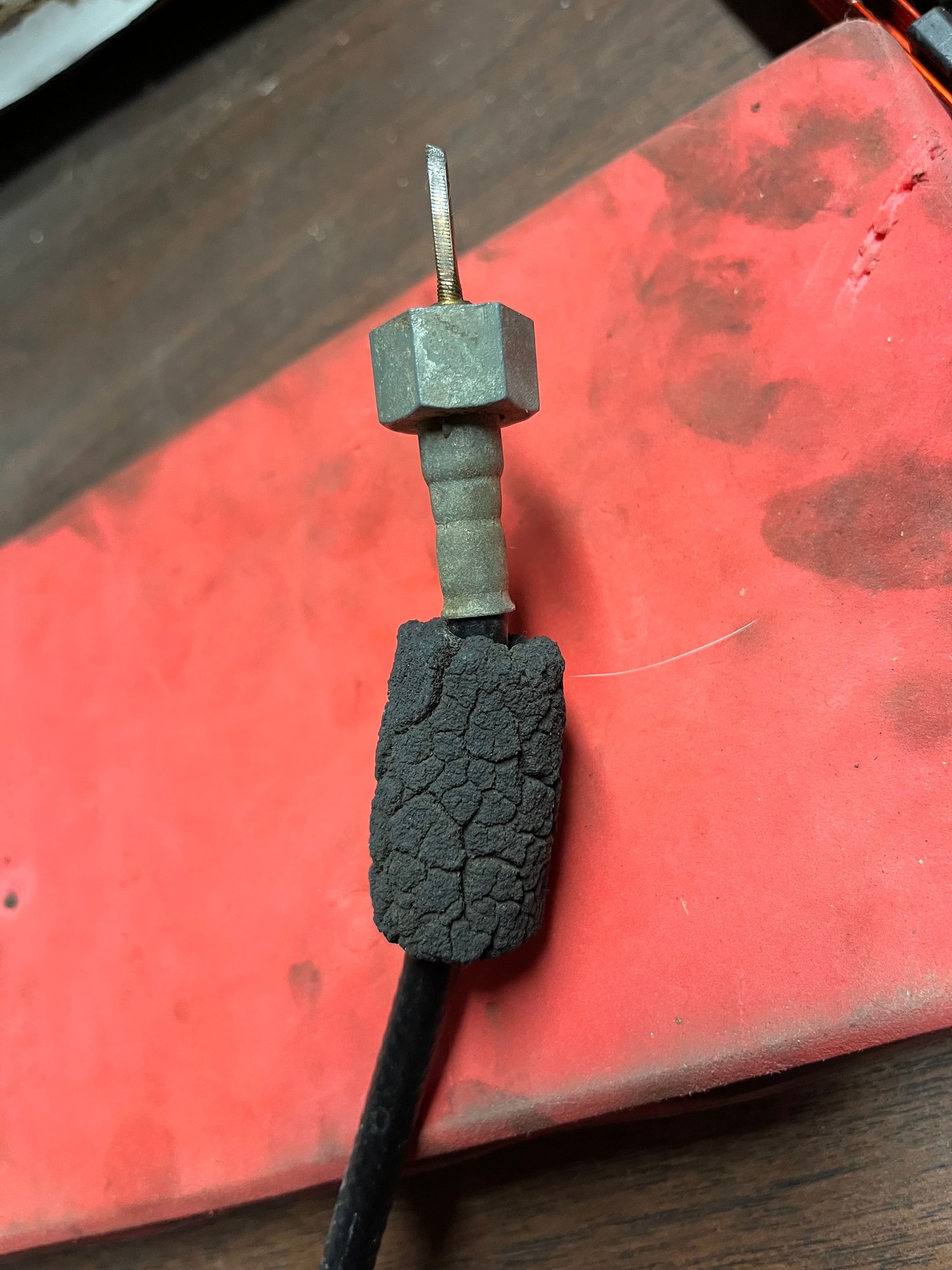

I don't know if you would call this a bushing, but it's what's on the speedometer cable that seals it to the firewall. As you can see mine has become rocklike and in need of replacement. I've looked around and can't find any sort of replacement. Does anybody have an idea where to get one or make one?

Look for some of the closed cell foam (black) insulation used on AC lines. I've go some laying around here.

The speedometer cable from Dennis Carpenter comes with the bushing: Speedometer Cable - 64.80" - 1965-72 Ford Trucks | Dennis Carpenter

LMC Ford Trucks sells the bushing by itself, number 6 in the picture below: 1957-72 F100, F250, F350 Speedometer Cables | Replacement Parts for Classic Ford Trucks - LMC Truck

Thanks, I did not look there. Have you used one yourself?

I have not used one, as I haven't needed to replace my speedo cable yet.
