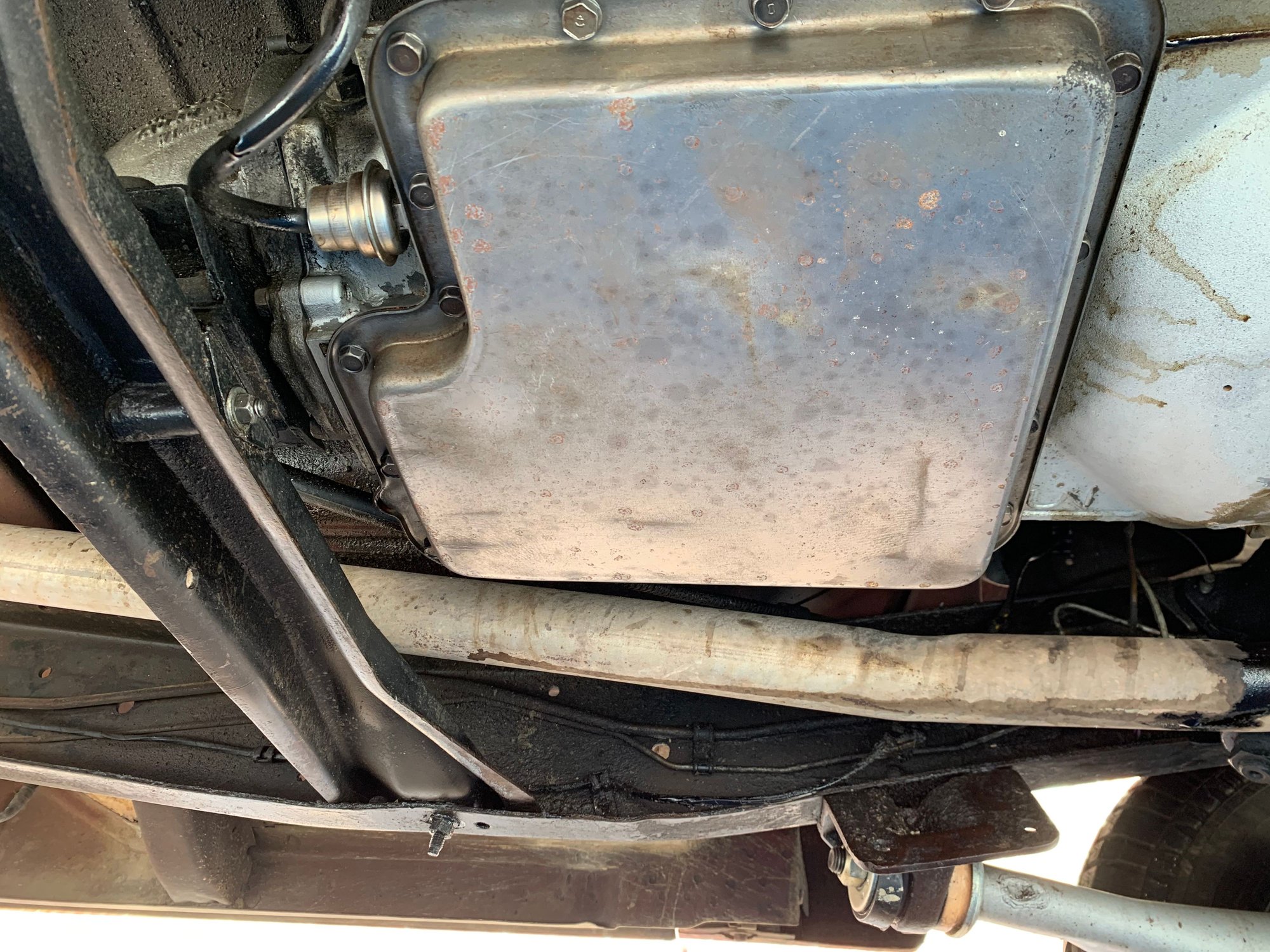

Old Aug 17, 2021 | 10:07 AM
motogotor's Avatar
motogotor
Joined: Jun 2021
Posts: 139
From: Dallas, Texas
This is the transmission pan, looks like a c6?
Old Aug 17, 2021 | 04:00 PM
Pcmdub's Avatar
Pcmdub
Joined: Aug 2019
Posts: 187
Likes: 14
It is a C6. Some came with the interchangeable speedo gear type cables that clip into the C6
