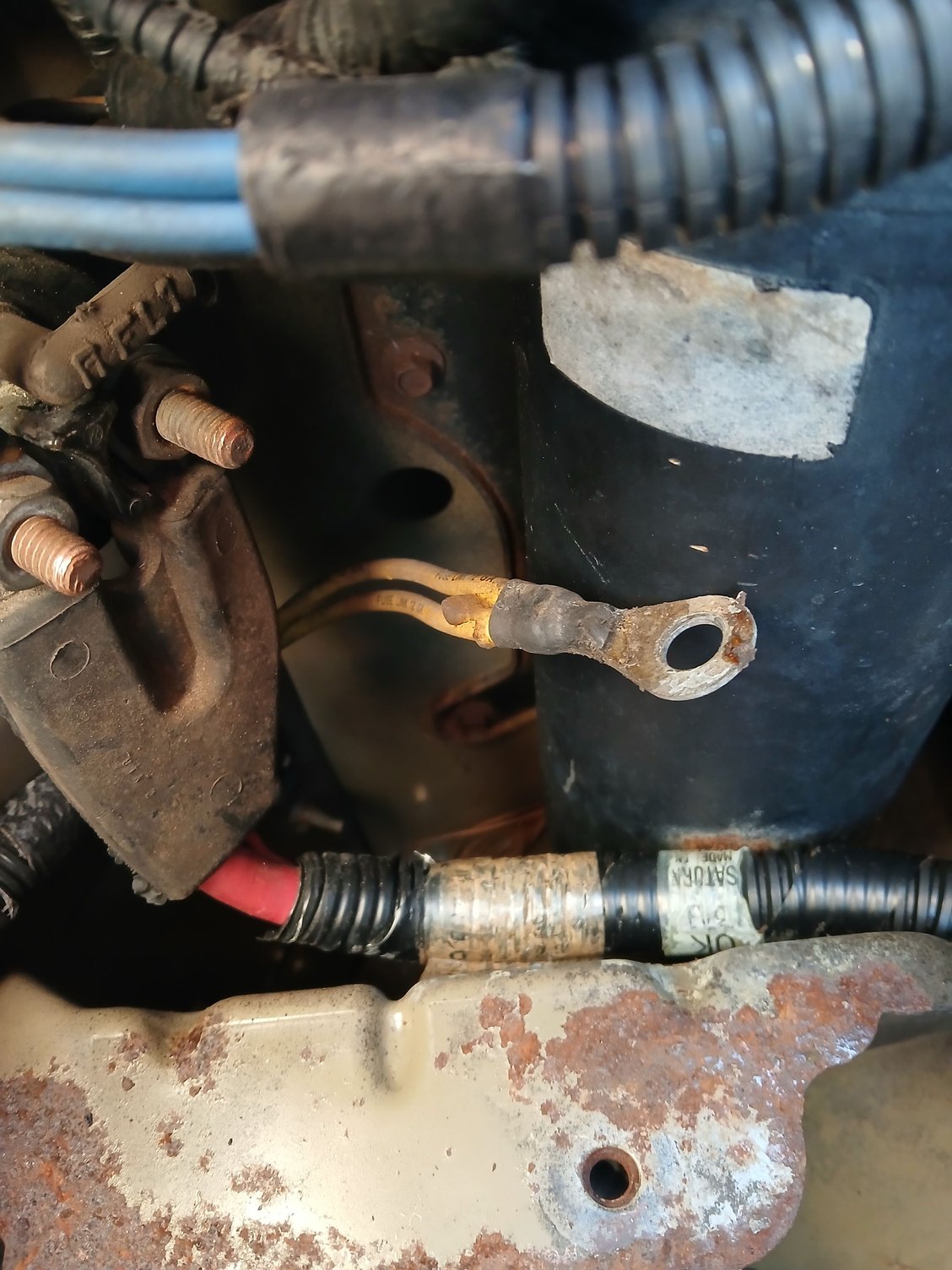

Where does this yellow wire attach?

2003 E 350, 7.3 PS. Passenger side front fender behind battery. The two yellow wires in single terminal: do they attach to the left post? I think they do but I'm not positive. I do realize they go behind the "U" shaped double terminal.
Any help is appreciated.

Alternator fuse link. Goes under the hot side to the battery of the molded plug. I no longer have the molded plug as I did a wire upgrade so I am unable to say which side is which.
