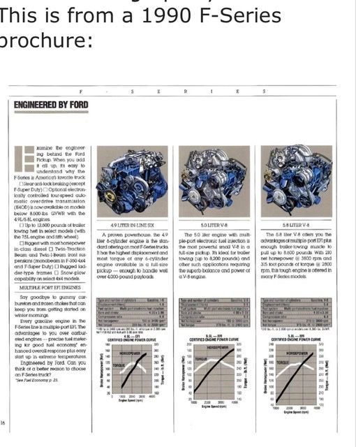

Old Oct 16, 2025 | 09:00 PM
My4Fordtrucks's Avatar
My4Fordtrucks
Joined: Jun 2015
Posts: 12,586
Likes: 2,361
Originally Posted by Inline6Enjoyer
Kinda figured, looks like I'll drive her until the insurance runs out and start looking for a swap.
How does the 351W handle less than 2000 RPM?
really like to bumble around in the highest gear available when cruising/not hauling, something the 302 does not like.
The 300 is overrated imo.
Old Oct 17, 2025 | 04:05 PM
Inline6Enjoyer's Avatar
Inline6Enjoyer
Joined: Jan 2025
Posts: 45
Likes: 8
Those are good statistics, thank you!
