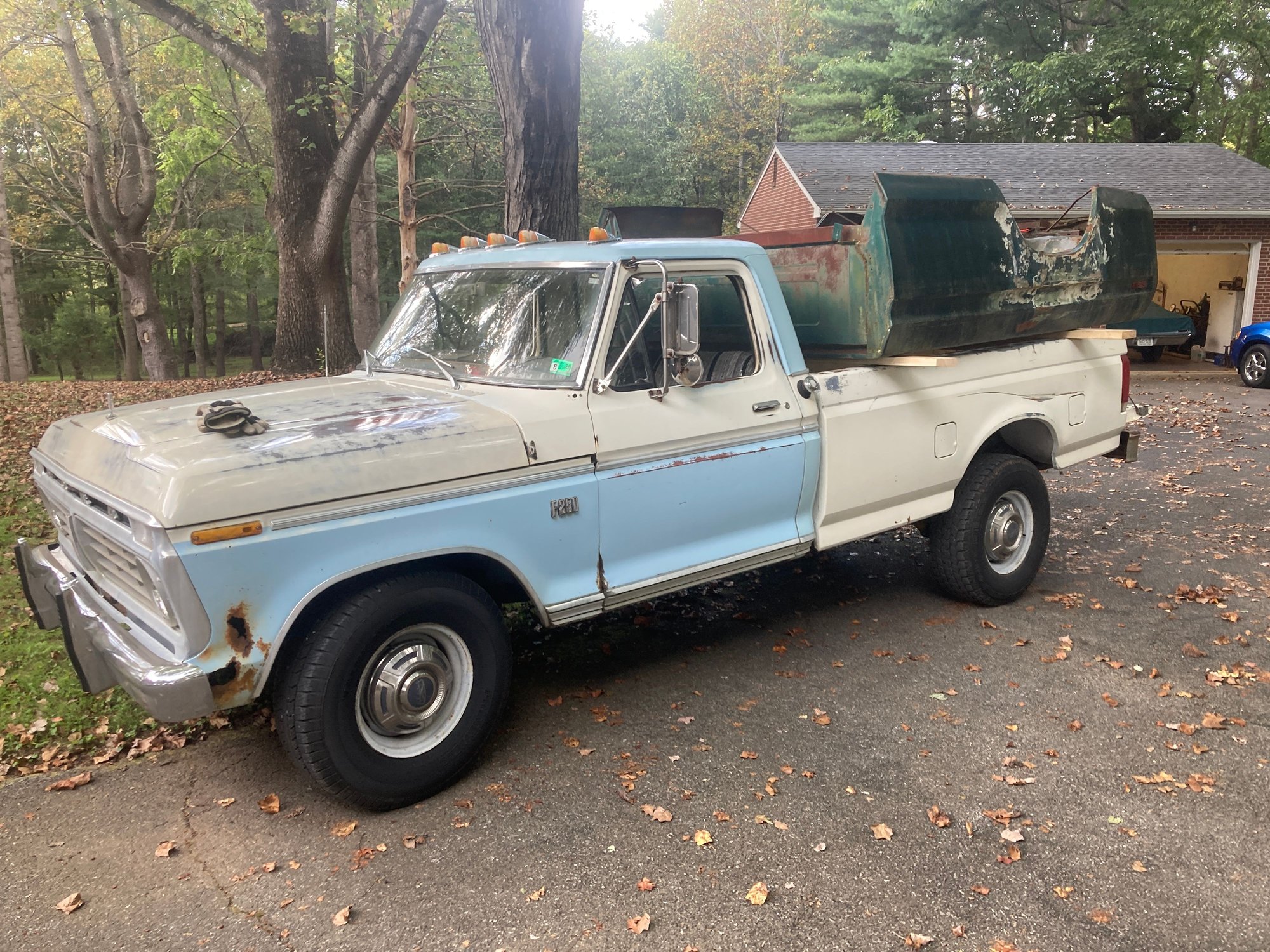

My 74 has been a long time work truck. It's had an 87 bed since 87. The original split in the rear and the bed sides folded over.
Managed to find another bed that someone aborted wheel arch replacement on. It needs lots of work but most of it is workable.
The part that concerns me the most is strengthening that rear structure so it doesn't split again. I'm not seeing a lot of replacement panels for the that area (the inner structure around and below the tailgate). Am I going to have to custom make what I need, or is some of this structure available?
Here's the workhorse. Been in the family since 1979. Yes it's getting new fenders too.

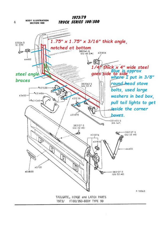

I bought my '77 in 1986, a friend had a Dent that did something similar and soon I decided to take steps. Besides plating my floor, etc, I used a piece of 1/4" thick, 4" wide, and as long as the area behind the lower edge of the tail gate, there is a recess there. I bolted this piece across hidden by the tailgate, then I added uprights with bracing that bolt to that piece and to the rear inner bed corners, almost to the top. It's a solid set up. I hope the diagram helps explain it.
You could just run the long piece across and add "prerunner" style braces to it from up near the top, but I'd keep the middle 4 feet open for like plywood, etc.
Hope it helps.

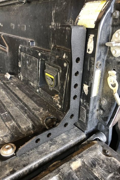

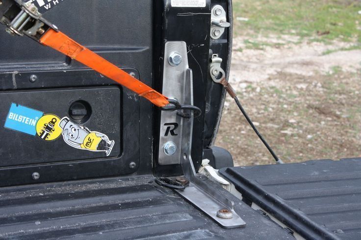

A complete panel. https://raybuck.com/product/1973-197...IaAo4ZEALw_wcB
Maybe reach out to AMD and see if they repop and sell just the lower back cross panel? https://www.autometaldirect.com/bed-...UWfb6tEHjscyy0
If you make these small enough, and with some gussets they will not stick past the area between the fenderwells. So that 4' piece of plywood will still load laying flat.
Tie down points, if they would of just carried the flat bar down tothe bed floor.

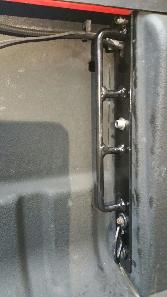

A picture I took this AM, but that 4" x 1/4" long piece is hidden behind the tail gate in that recess, but you can see the dusty top edge and see how that recess accommodates it I think.
